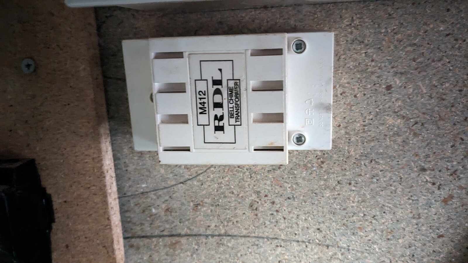

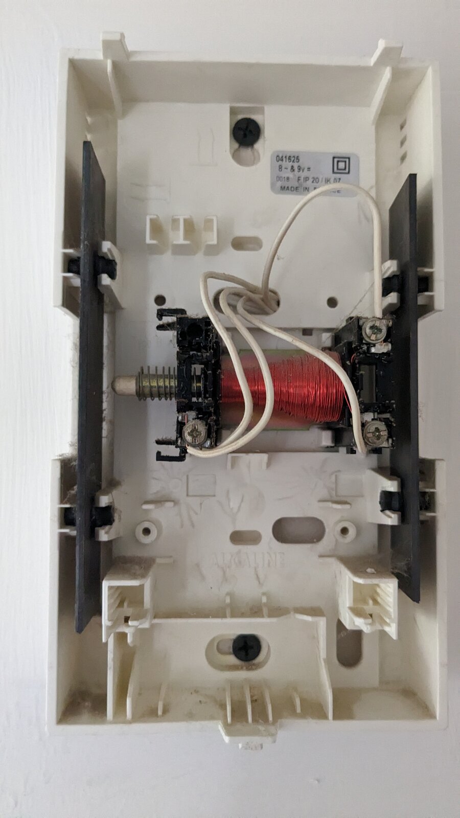

Hello all
I'd like to remove the bell chime from my hallway prior to decorating and struggling to work out how. It's connected to a transformer, which is under the consumer unit. Pics of both attached.
First question is - when I flip the breaker for the bell to off, my voltage detector is still detecting voltage at the bell chime (no batteries that I can see) but not at the transformer itself. Why would that be?
More generally, how do I go about disconnecting the chime from the transformer and is it safe to leave the transformer connected to the consumer unit after.
I was planning to open up the transformer to grab a pic of the wiring but I've been put off because the chime still has a current and not sure why or what that means.
Thanks!

Which kind of voltage detector are you using?
Your transformer is rated at 8v-24v.
Just mark the cables and remove them. Wrap some electrical tape over the ends and remove the chime.
Something very freakish would have to happen for you harm yourself even if the wires were sill live.

Are you saying I should ignore the transformer? So flip the breaker off, remove wires from chime, wrap in tape and leave them in the wall, remove chime and turn on breaker?
I would recommend turning off the transformer, not for your own safety but to make sure that you don't run the risk of wires touching each other whilst you dismantle it- wires touching each other could fubar the transformer.
I too own a non contact voltage pen. I find them to be extremely useful, but they often give me false positives- meaning that they tell me that there is a current, when there isn't. IMO a false positive is wayyy better than a false negative. A £5 multimeter will, potentially, be more reliable.
Again though, in the transformer, the cables running to the chime will be connected to the 8v side, 12/15 or 24 (or increments in between). Regardless, if you touch any of the cables you are very unlikely to notice that you have done so.
