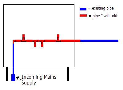

To give a better picture of what I'm doing, I drew the below:
The blue pipework is already there - I will be adding the pipework in red (all the pipes are actually cold ;) )
You can see the two equal tees I'm adding that are closeby - these are for appliance feeds. Also there will be another equal tee for outside tap, and another for kitchen sink tap.
An elbow joint will connect all that onto the mains feed coming up from the floor.
It has just occured to me that I could probably feed both appliances from the same equal tee using some kind of splitter somewhere.

he is proposing to use solder ring fittings.
they do not require any additional solder.
they look bad enough without solder snot running round joints.
