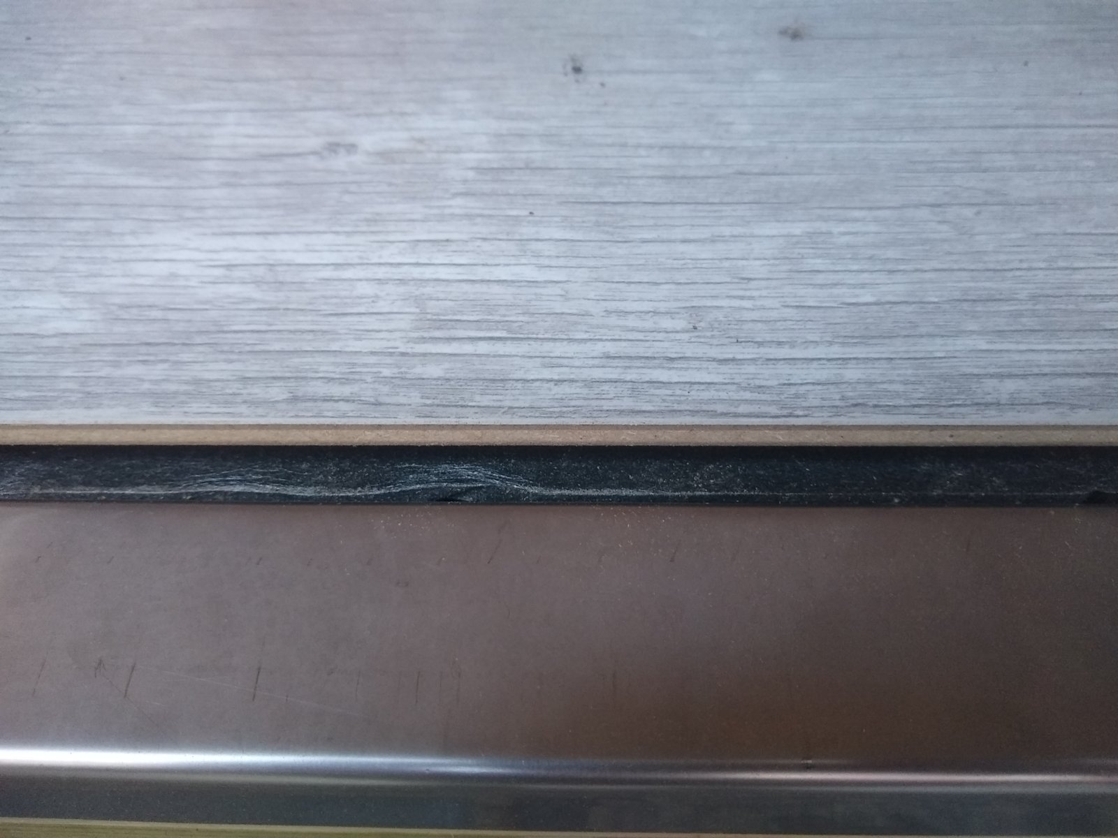

Hi,
I have just finished the floor of my log cabin, and I've left an expansion gap at the doorway.. in hindsight I probably shouldn't have.
Anyhow, how would you go about sealing this gap? I have light grey oak laminate floor. Pictures below
The laminate also finishes approx 3mm higher than the door edge.
The gap is approximately 10mm.
Thanks.
You could fit a aluminium door strip. They cost about a fiver from screwfix.
I had a similar gap between laminate floor and a tiled bathroom floor. I filled the gap with a similar coloured silicone which has held up well and looks pretty good
