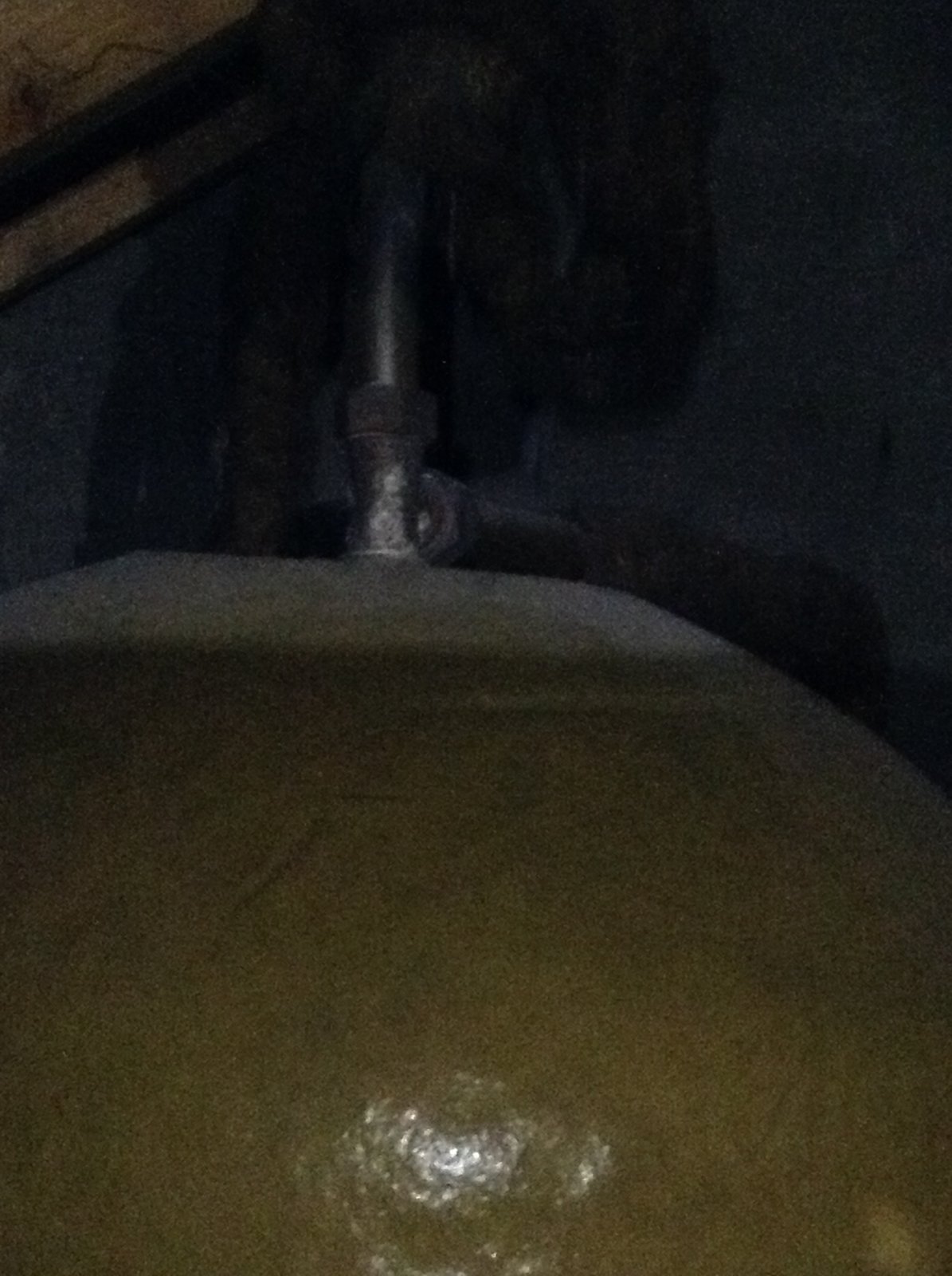

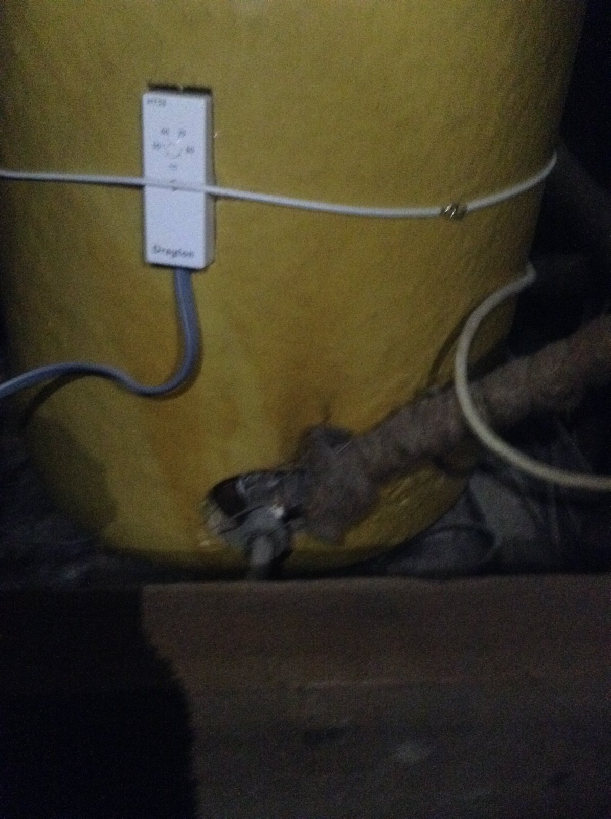

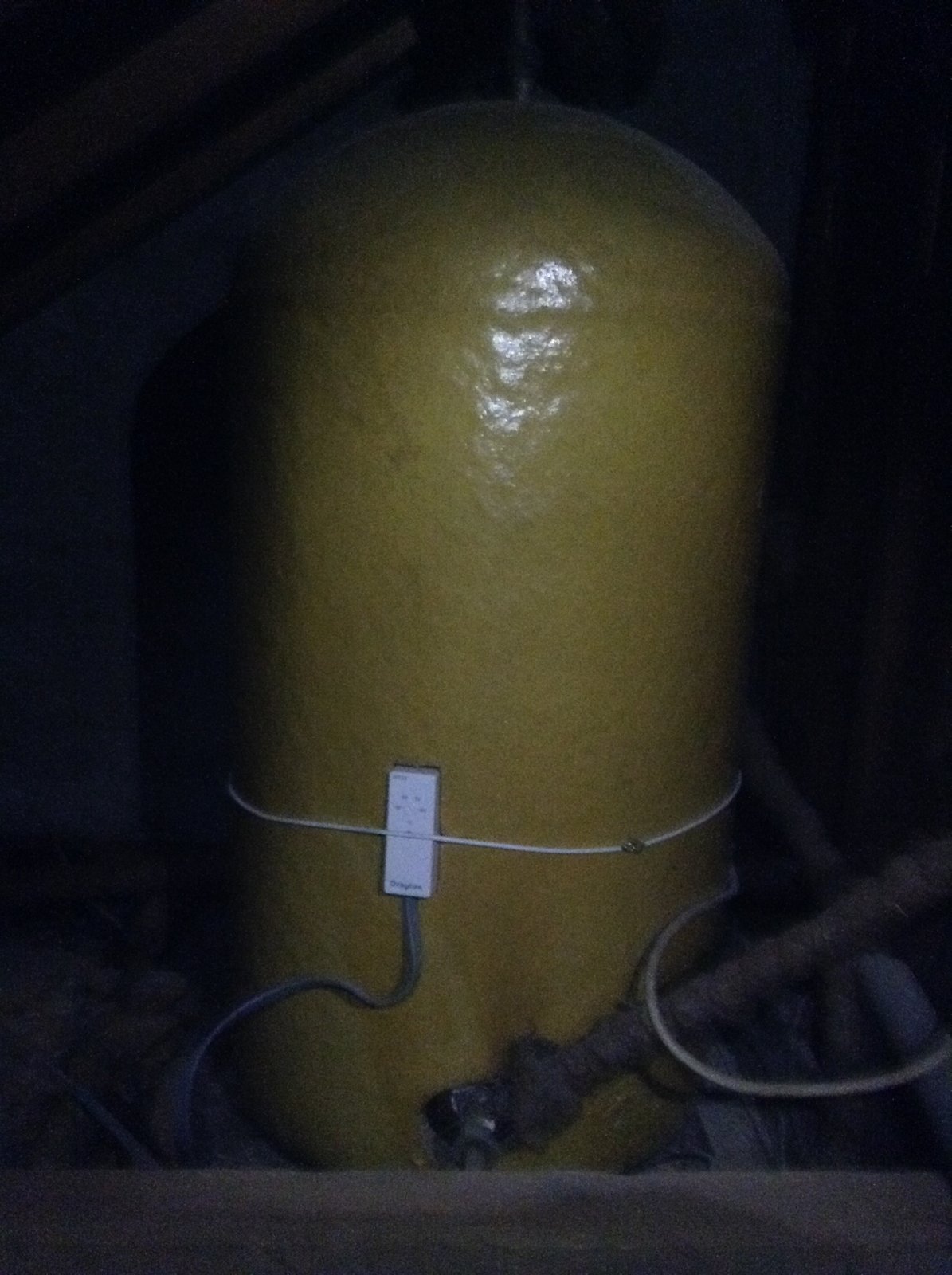

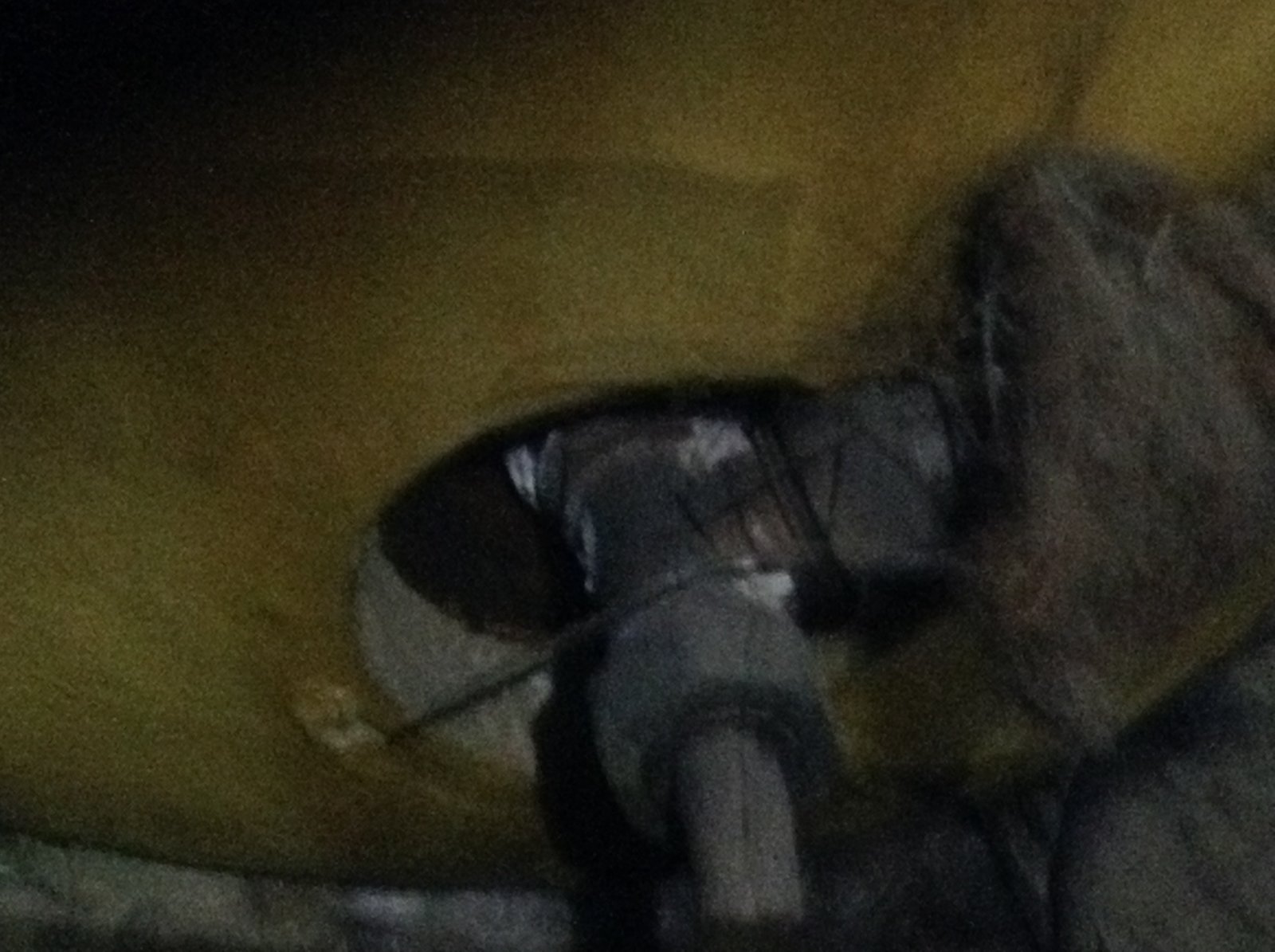

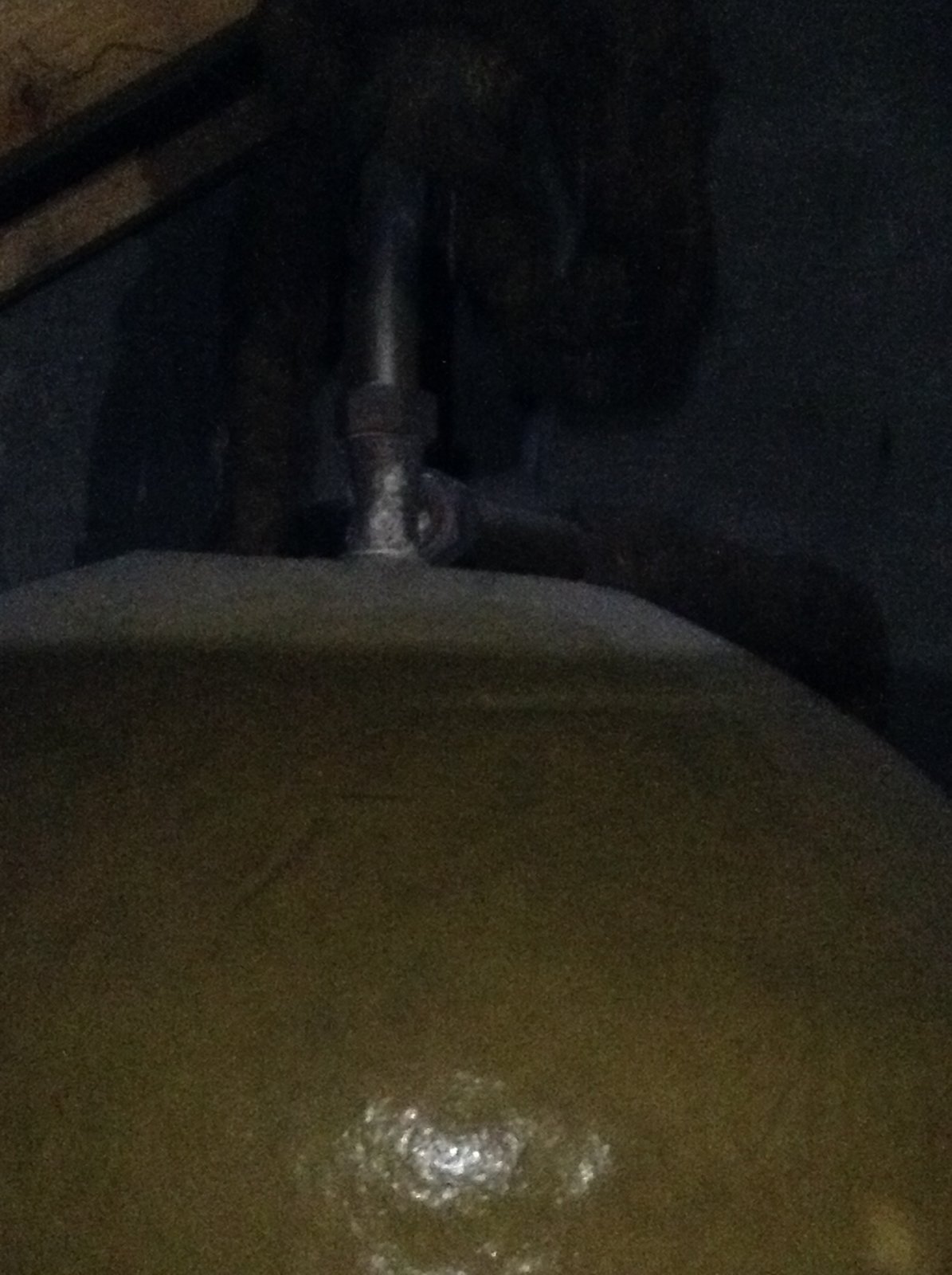

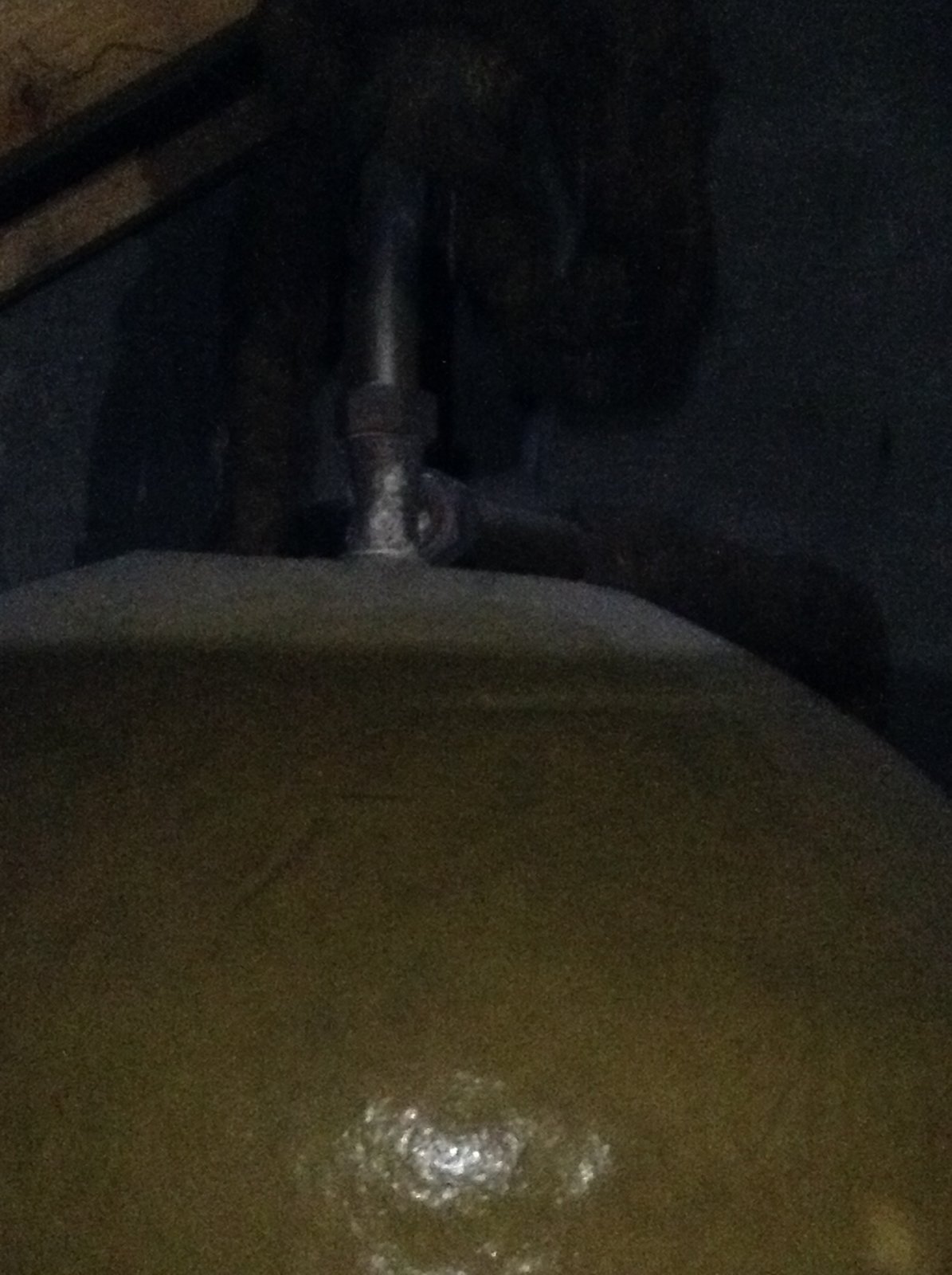

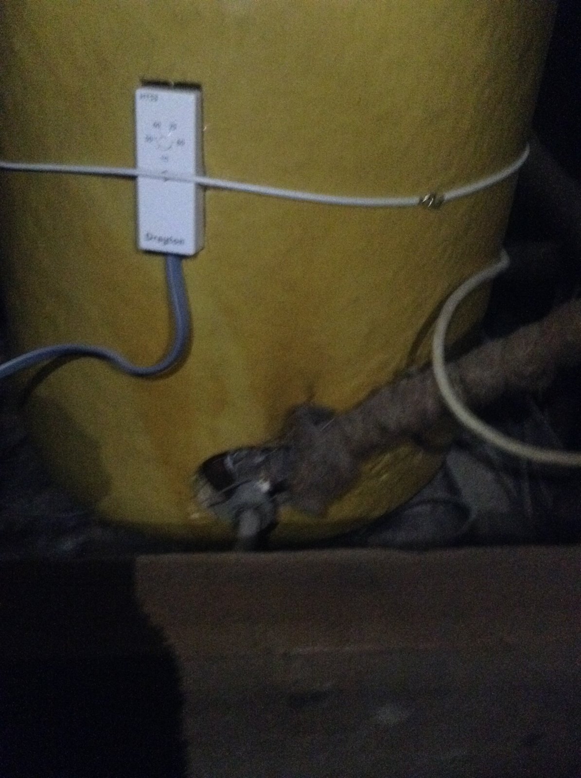

A few things to note... Some earlier posts gave advice to Increase the COLD system pressure to 2.5 to 2.8 bar. If you do this and then run the boiler the pressure will increase through expansion of the system water to well over 3 bar ,which in turn would cause the PRV to lift .so before running the boiler you would need to drop the pressure back to 1 bar. I personally wouldn't subject a system that MAY have a slight leak to increased ,almost double ,the pressure. Regarding loft tanks , the small f&e tank is redundant now. The larger cold water tank will most likely feed the hot water cylinder ,a picture of cylinder will confirm this, and if so your domestic hot water is still gravity fed. How old is the hot water cylinder ? Its possible that the coil inside has a pin hole leak and CH water is weeping into the dhw .have you noticed any slight discoloured hot water from taps ,or unusual smell from hot water ? Have seen this before on older cylinders which have been on gravity systems ,and then changed to a pressurised one .As the coil is now under much greater water pressure ,its enough to finish it off. And finally are any CH pipes buried in concrete floors ?

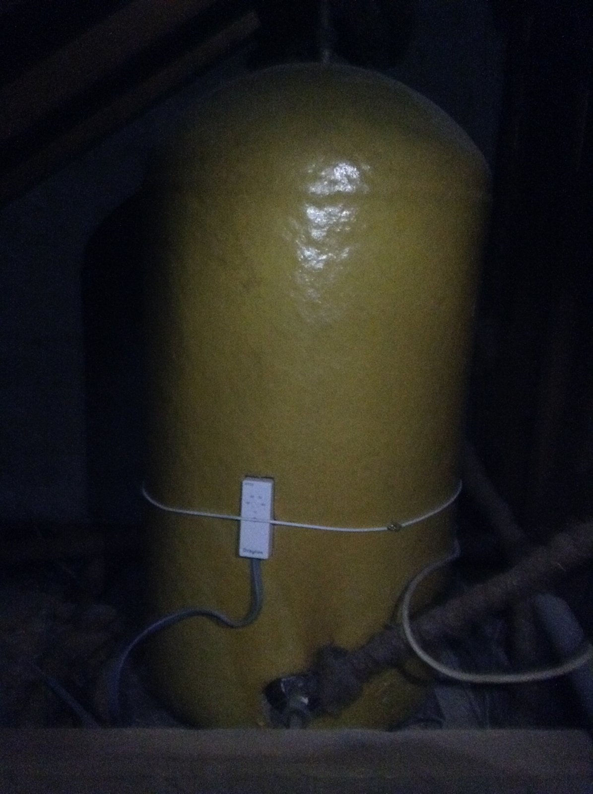

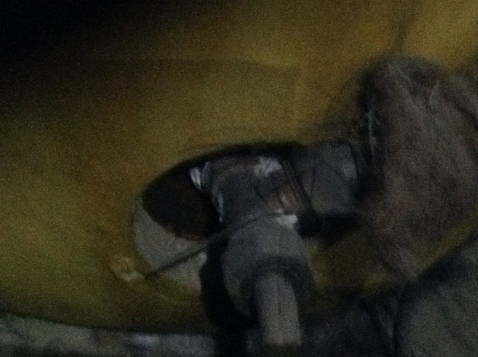

Ok got some pics of the HWST, hope they ate what you're looking for. I have no idea how old the tank is but the last picture below is of the pipe coming out the front bottom of the tank and the exposed metal in the hole has some rust on it (it's in an Unheated attic though). The pipe from the top goes into the top attic where the cold tank is. There is no odd smell from the hot taps, I woukd smell the inhibitor. No pipes in concrete that I know of but I still don't know how the pipes get upstairs, although I suspect they are the pipes running up the cavity in the kitchen where the old boiler was (4 pipes that run up to where the HWST us). How these pics help.
