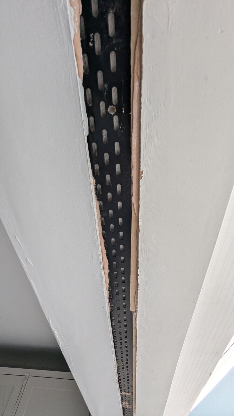

Just to update this, decided to get someone in to fit the door rather than try and DIY it. They are fensa and it's an external rated Origin bifold going in. Is going to be fitted in line with the external breeze block constructed outer leaf, and the floor, and screwed into the catnic lintel above. The cavity has been closed off with a cavity closer. There are wall ties holding the inter thermalite block wall with the outer breeze block wall. The reveal will be approx 15mm.
I wasn't sure about fitting to the external leaf but the fitters say that's better than attempting to fit it to the thermalite blocks.
The lintel is a catnic apparently, and the holes for the bifold will be drilled to the right hand side of this exposed part. Is that okay, or will it weaken it?
