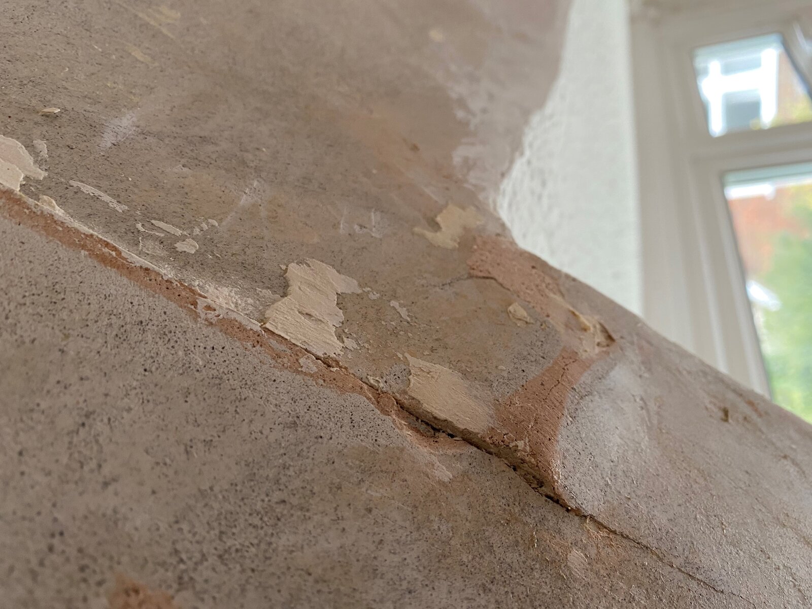

Hi,
I have stripped the wallpaper off one of my rooms and found the below.
How do I remedy this? Can I cut the bulge out and fill with Toupret interior?
Cut it out to just below the existing adjacent surface, pva and fill flush over a couple of coats if required.
Thanks. Do I let the pva dry like a primer before I fill?
You can let the pva dry if you want, and that will kill any suction, but PVA IT AGAIN before you apply the filler/plaster, but this time, apply the filler/plaster onto it while the pva is still wet/tacky.
NEVER APPLY PLASTER ONTO "DRY" PVA!
