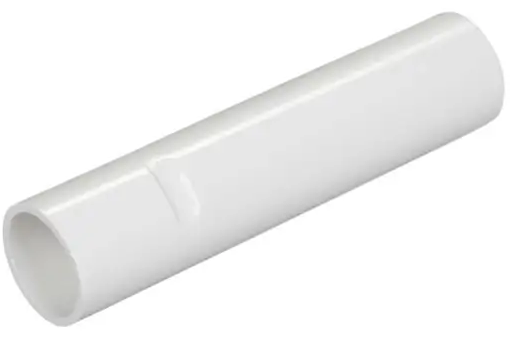

I got some in error, sorry gone now, but the couplers are also extra long, 1710164471723.png I would think petroleum jelly would likely work on the long side.
Yes, that's exactly what I was thinking.
In the past when I wanted a more or less waterproof but sliding fitment for another application I coated the pipe in petroleum jelly and put silicone sealant in the socket. That way the sealant stuck to the socket but not to the pipe and created a perfect tight fitting yet sliding joint.

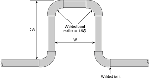

It will still expand and contract the same as in the UK, it was to give you an idea of how much and how to construct the run to allow for exp/cont. The second link is the expansion joints you were looking for.
