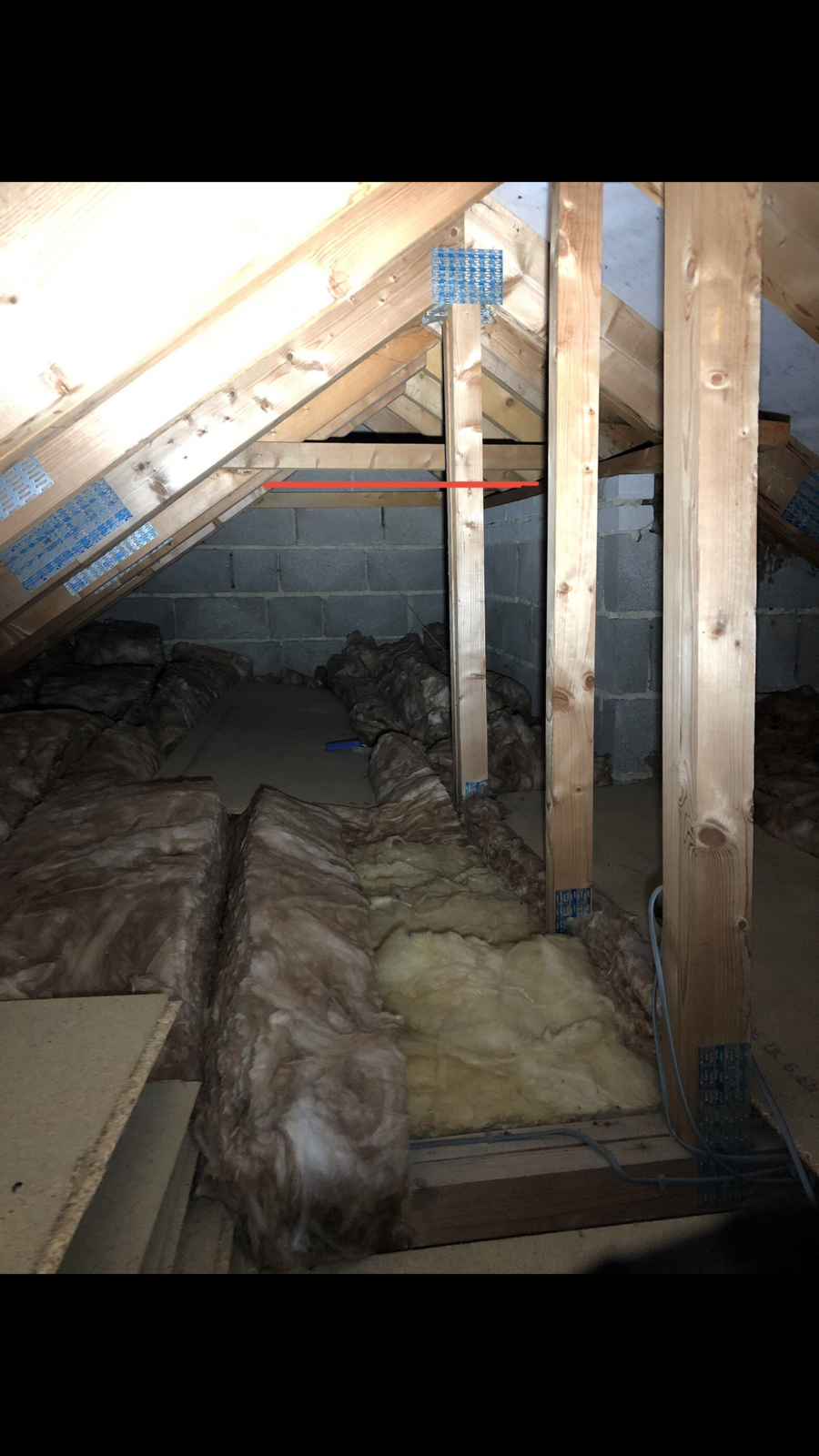

Following on from the advice from my other thread I’m am needing to add some supports similar to a few that’s there already (see red line in picture).
I have some c24 4x2 which will be used and was intending to screw them in until I read that screws are less favourable and nails should be used due to their flexibility.
The idea of hammering into my beam is concerning and with the fear of doing more harm than good I would prefer to screw. Is this really a bad idea? Is a nail gun (which I don’t have) the only way forward?
How will/can a rod of metal, whether a screw or nail, fixed through two pieces of timber held tight together, "flex"? There is just no way.
Use screws, avoid banging around in a loft.

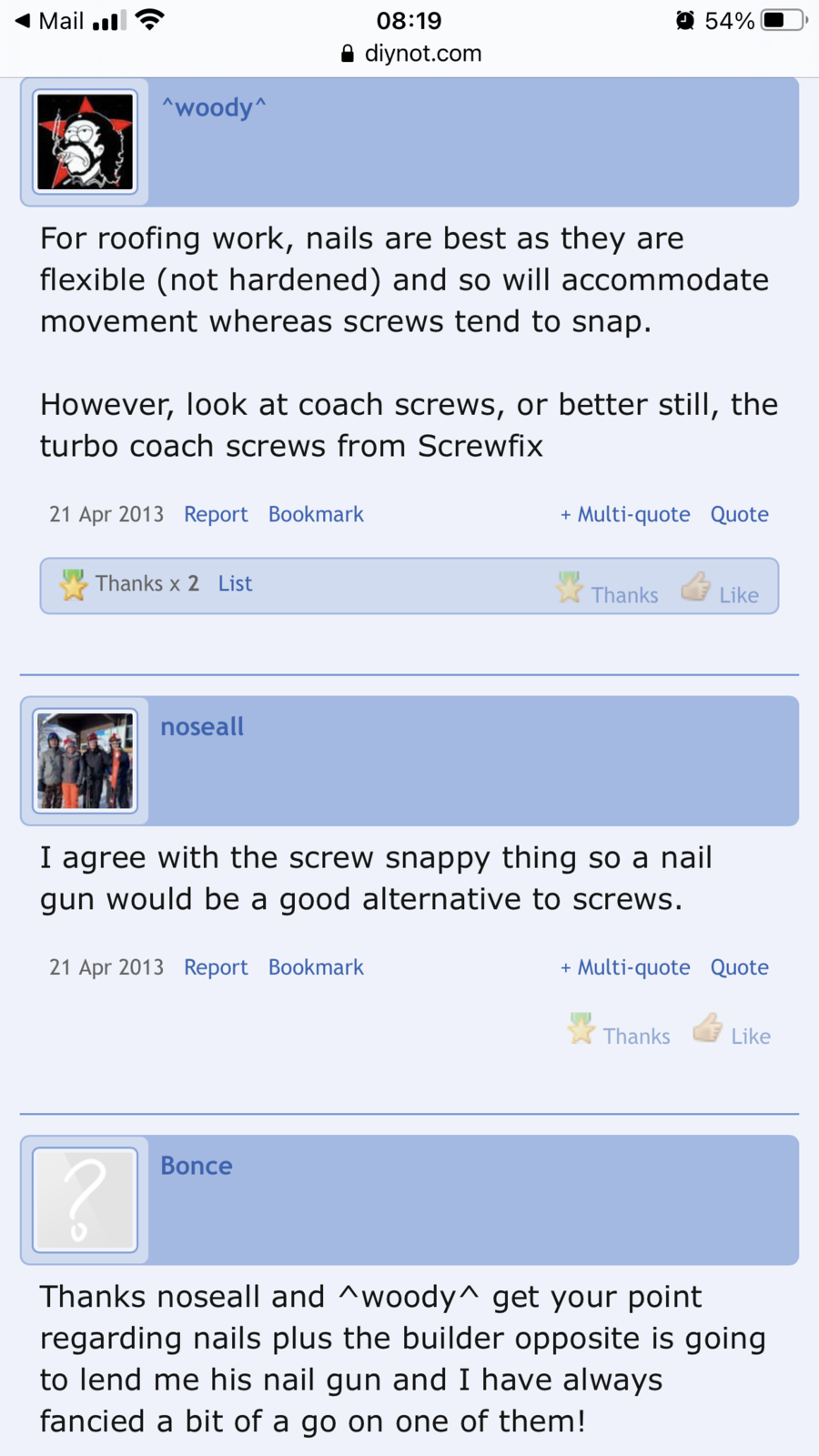

Yes those turbos are quite good for fitting without a pilot hole. You'll probably need an impact driver though. Or normal 4 or 5mm screws if predrilling.
screws are unsuitable for load bearing applications in shear -for example joist hangers
screws are fine for your application..... or the coach screws youve linked.
A carpenter wouldnt think twice about using screws for doing this, 80x5 probably (or whatever he had in the van!)

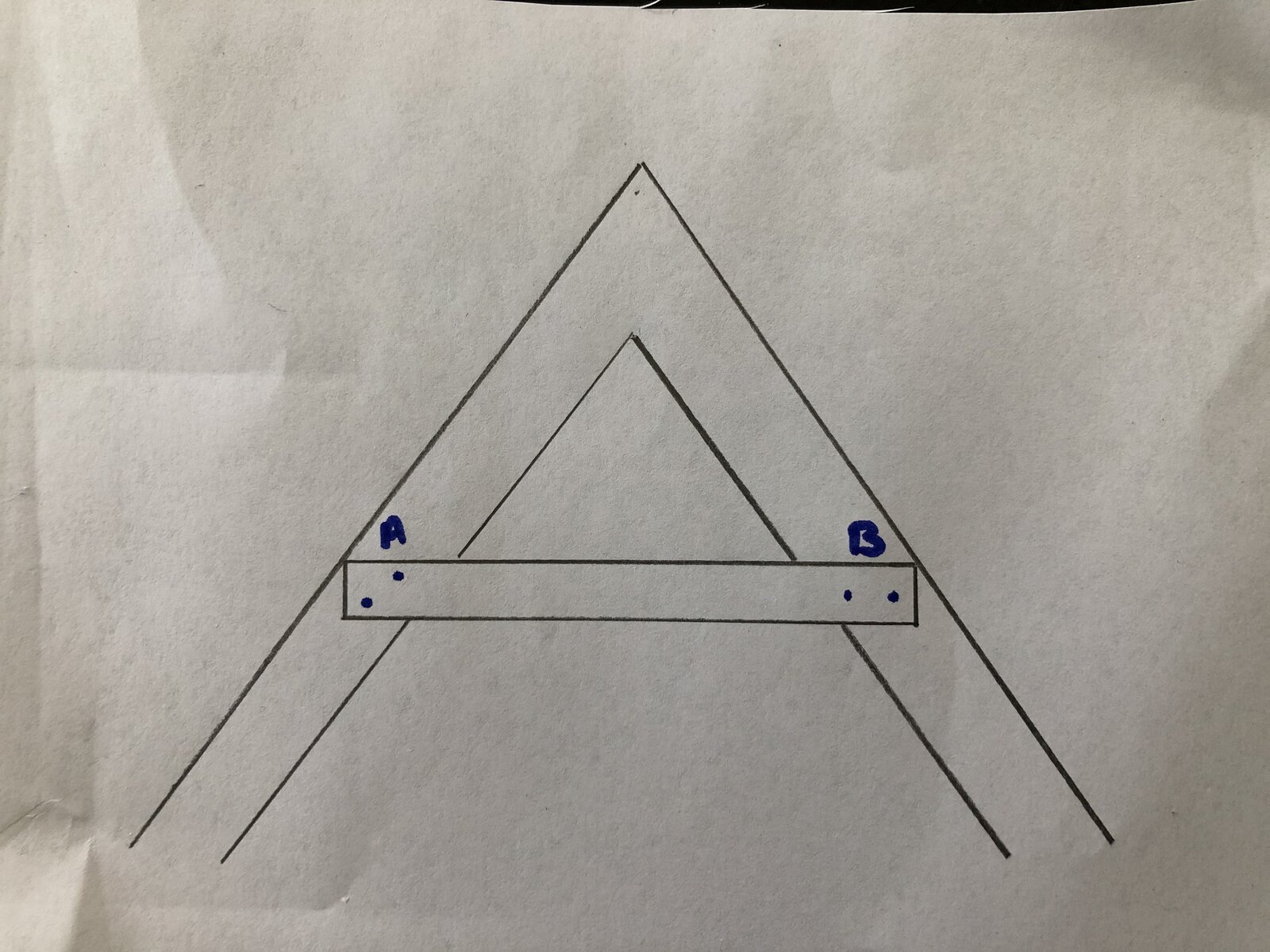

Lastly, would I be right in thinking that ‘A’ would be better screw placements than ‘B’?
"A" would be better.
I'm not sure of the purpose of these, as that looks like a trussed roof, so these braces should not be necessary. If these are a necessary structural function then they should be fitted with a single coach bolt, square washers and a spur washer (timber connector) between the timbers. But if these are not really necessary (ie not specified by a qualified person) then screws will be fine.
The purpose is to add structural support. It isn’t critical but the end of the roof has been put up badly. It looks like they just added a few ends on. I’ve been advised that it would ‘help’ in the event of heavy snow and for long term durability.
Im more than happy to drill a hole and put a bolt through but I thought that drilling holes 10-12mm for a coach bolt was a bad idea as it can effect the structural integrity of the trusses.
I can't see how a collar is going to help a truss, and certainly not one that far up. But 10 or 12mm hole is not going to may any difference.
screws are hardened and vulnerable to breaking under high shear stress
wire nails bend a bit
Agreed you might get a bit more bend from a nail compared to a similar sized screw, but completely wrong to say that screws are 'unsuitable' for shear loading...
