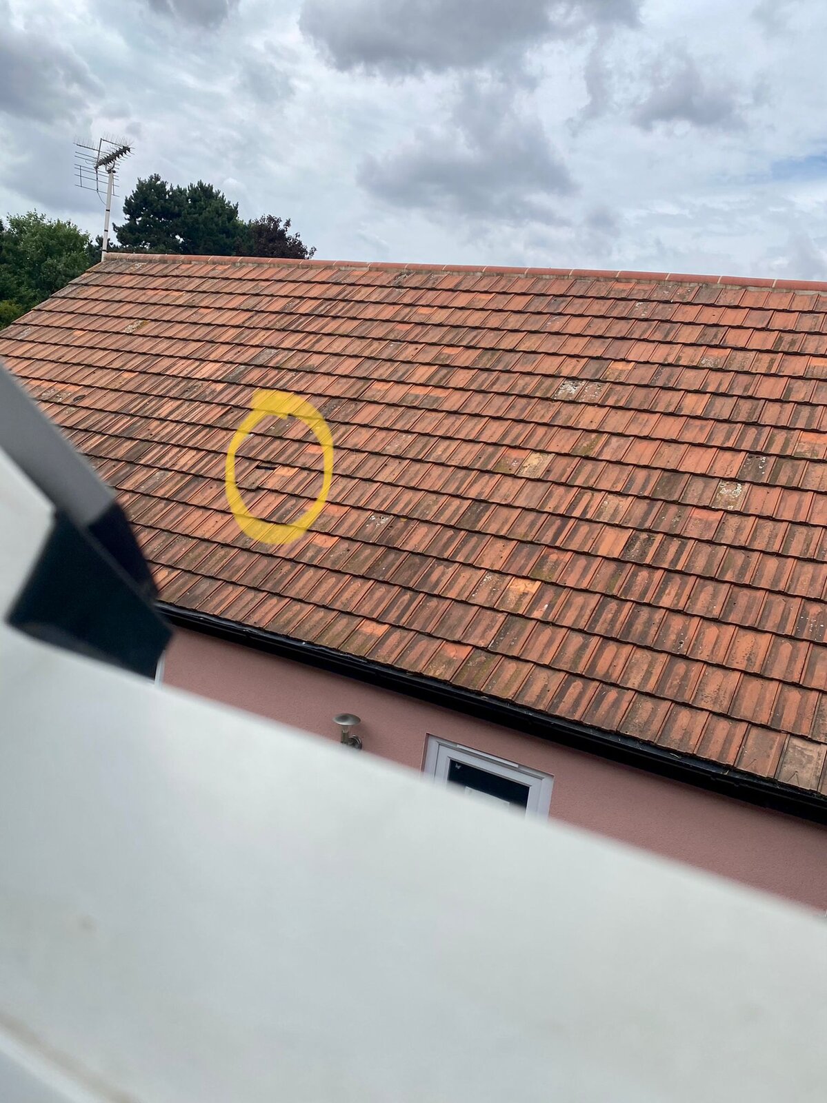

How to fix this tile
JP_
17 May 2012
11,415
1,017
There's felt on the underside.
Pack up the two above it with some wedges, slide it out and replace it. If it's nailed you'll have to waggle it or otherwise remove the nail. The replacement won't need nailing.
I'll be roasted, but hey... If it were mine, and a one off, I'd slide it back up, and fix with a blob of CT1.
C'mon, at least flashband it. :rolleyes:
Anyway, if you're going up the roof with anything it may as well be 70p new tile.
