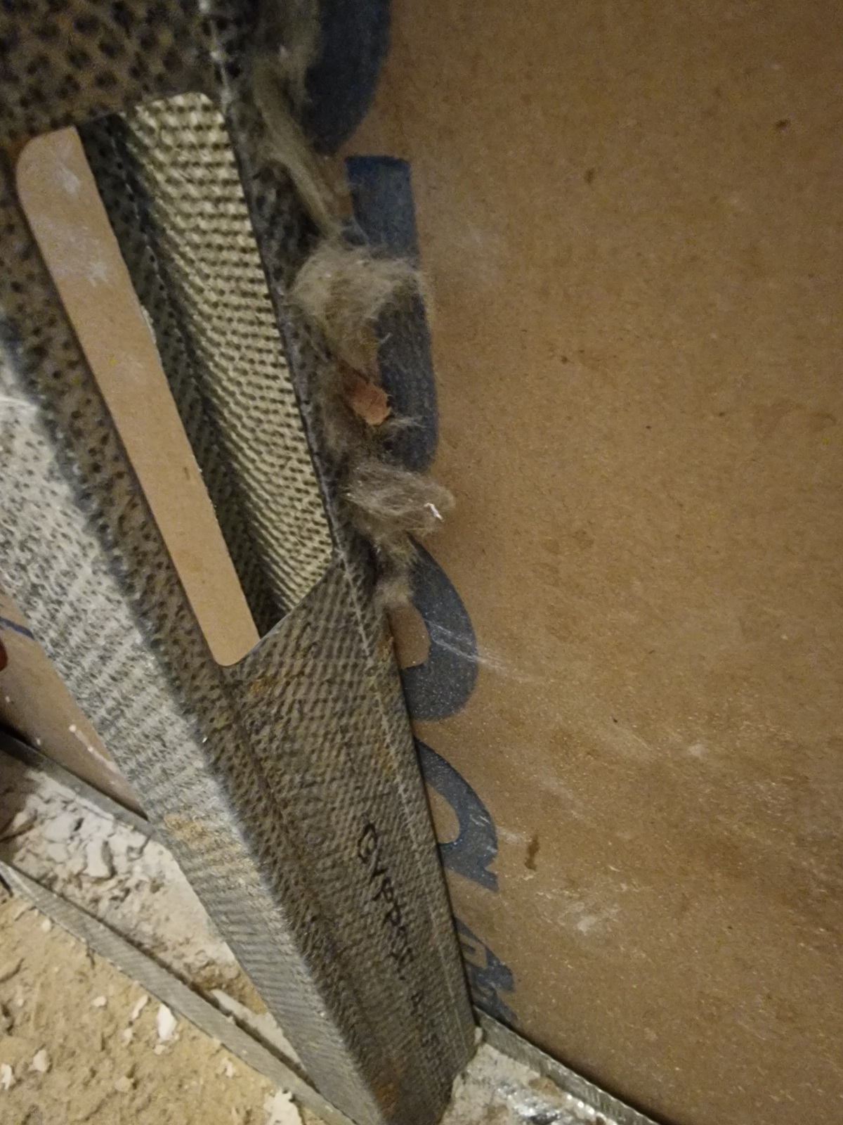

Hi,
I'm trying to conceal a basin waste instead a stud wall but naturally the metal studs are in the way. Anyone have any suggestions for how I can solve this?
Thanks in advance
how wide is that gap through the stud, will it not fit through that? if not then a 35mm Bi metal hole saw and a 35mm grommet may be required.
Thank you, that's really helpful. I think I can get a 35mm hole cut out. Given the slope and width, I'll probably need to cut through 3 studs at different heights to get the right drop from basin to soil pipe.
