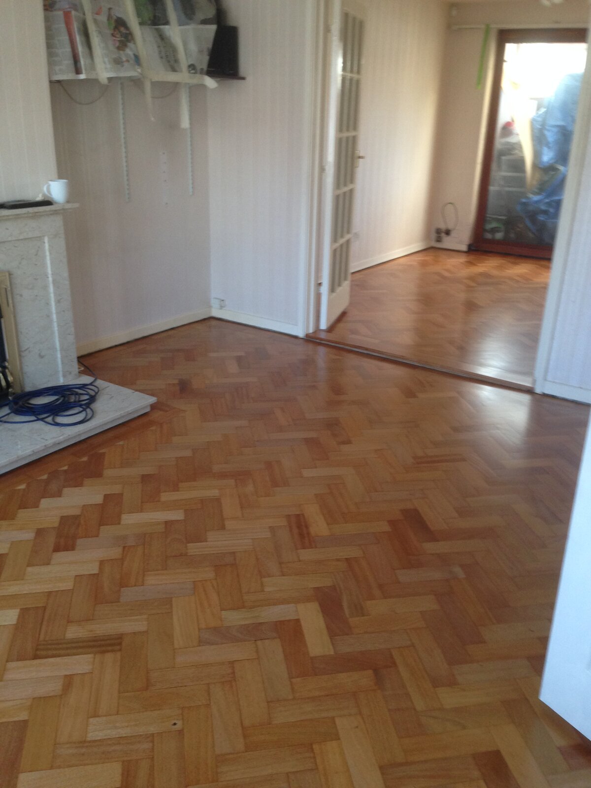

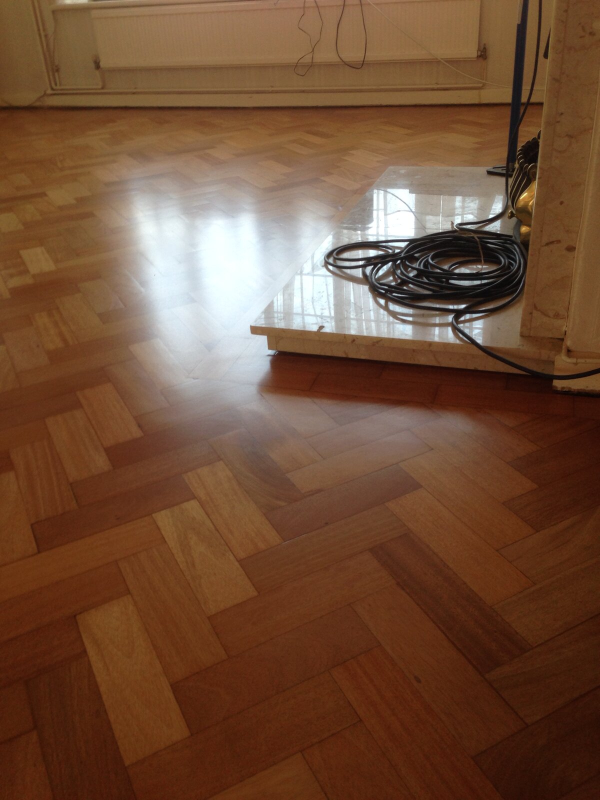

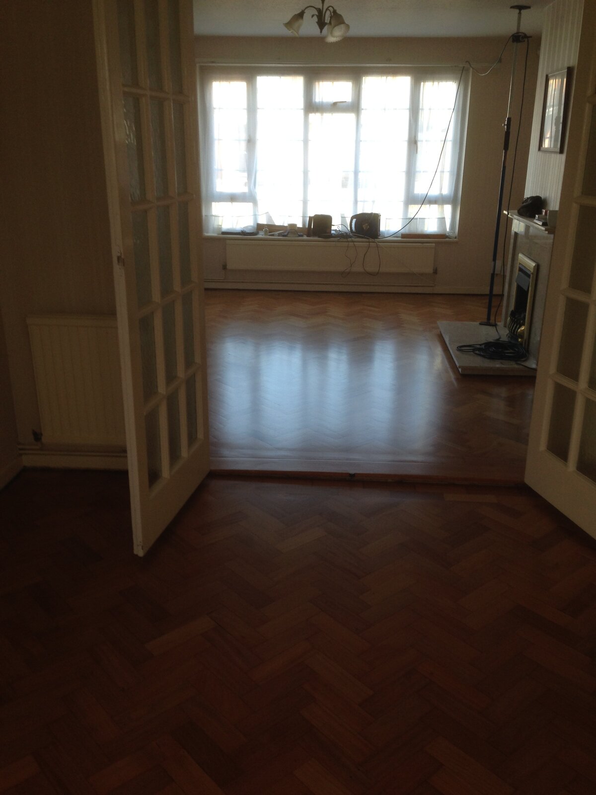

I paid a guy £1100 to sand and finish about 40 sq metres of original parquet and it looks brilliant. It took him more or less 3 solid days. Consider either diy sanding with hired equipment or paying a guy. The time saved plus cost of new materials has to be born in mind.

He's a self employed floor guy.
He had a shed load of dust extraction kit and was able to work without a mask. When he'd finished, there was less dust in the living room/dining room (through lounge with doors) and hall. He put on (I think) three layers of sealant plus from memory sanding a good half dozen times inc adding dust to filler for defects.
I don't know what his day rate would be but getting on for £300 at a pure guess allowing a couple of hundred for wear and tear on a couple of grand's worth of kit, and sealant/consumables?

That really looks a lovely job with a nice lustre. I can understand the amount of time it would have taken to get that looking like that. It looks like it's got a nice lustre
The stuff was "bonna " type stuff. That's a brand of products. Yes he did several grades changing down to finer ones and it does look pretty good.
