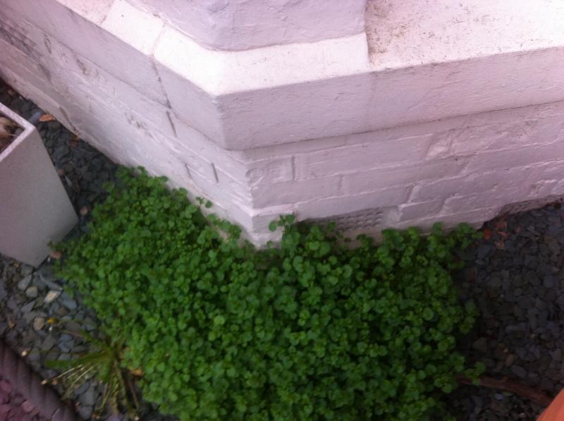

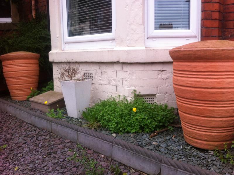

Hi I was wondering if anyone can tell me how to get neat sharp corners when rendering a 22.5 degree bay windows corners. It's the brick portion that's painted white that needs tidying up. Also with the air bricks that have been installed at some point to help with damp despite there being no cavity and prior to a concrete floor can these just be rendered over?

Make yourself something like this out of wood, if you can't get that edge with a normal float
I'd never get a neat edge just by eye and hand, i've render some flat area but never a corner not even a 90 degree corner but i believe there is metal beads for that.

what about the air bricks can these just be rendered over?

But surely they are redundant,
Like i said the lower one used for venting the floor space is of no good as its now a concrete floor in that room now and the higher one was put in by previous owner to help with the damp inside due to old Victorian house with thick wall no damp course or cavity. I have since had the wall injected with a damp course and damp proof rendered internally so surly these air bricks are doing nowt. the top one doesnt t even go through the thickness of the wall
Oh sorry, i didn't see the bit about the air bricks being redundant. If they are, then yes you can.
For the bay corner, you could use a stainless steel bead if your rendering skills are not that good.
Just use some cheap plastic bead. If you mess it up you've only lost a few pence.
So can you get a 22.5 degree bead. I apologies for my lack of knowledge as i thought you could only get 90 degree
Thanks for your tips
Get a standard bead, and bend the mesh out to suit.
I'm not sure if plastic bead will bend out that much, without trying to spring back. Have a look first.
