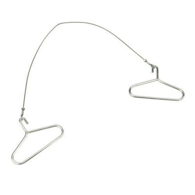

All - many thanks for the further suggestions, esp the wiresaw one - that might have got in between even if a hacksaw didn't.
