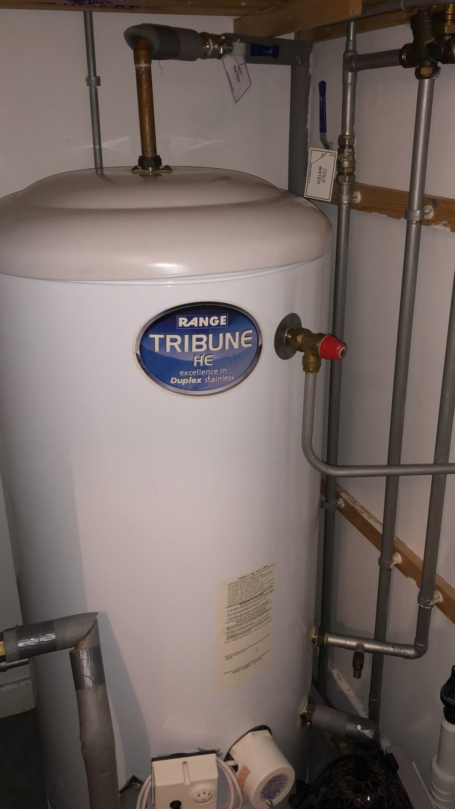

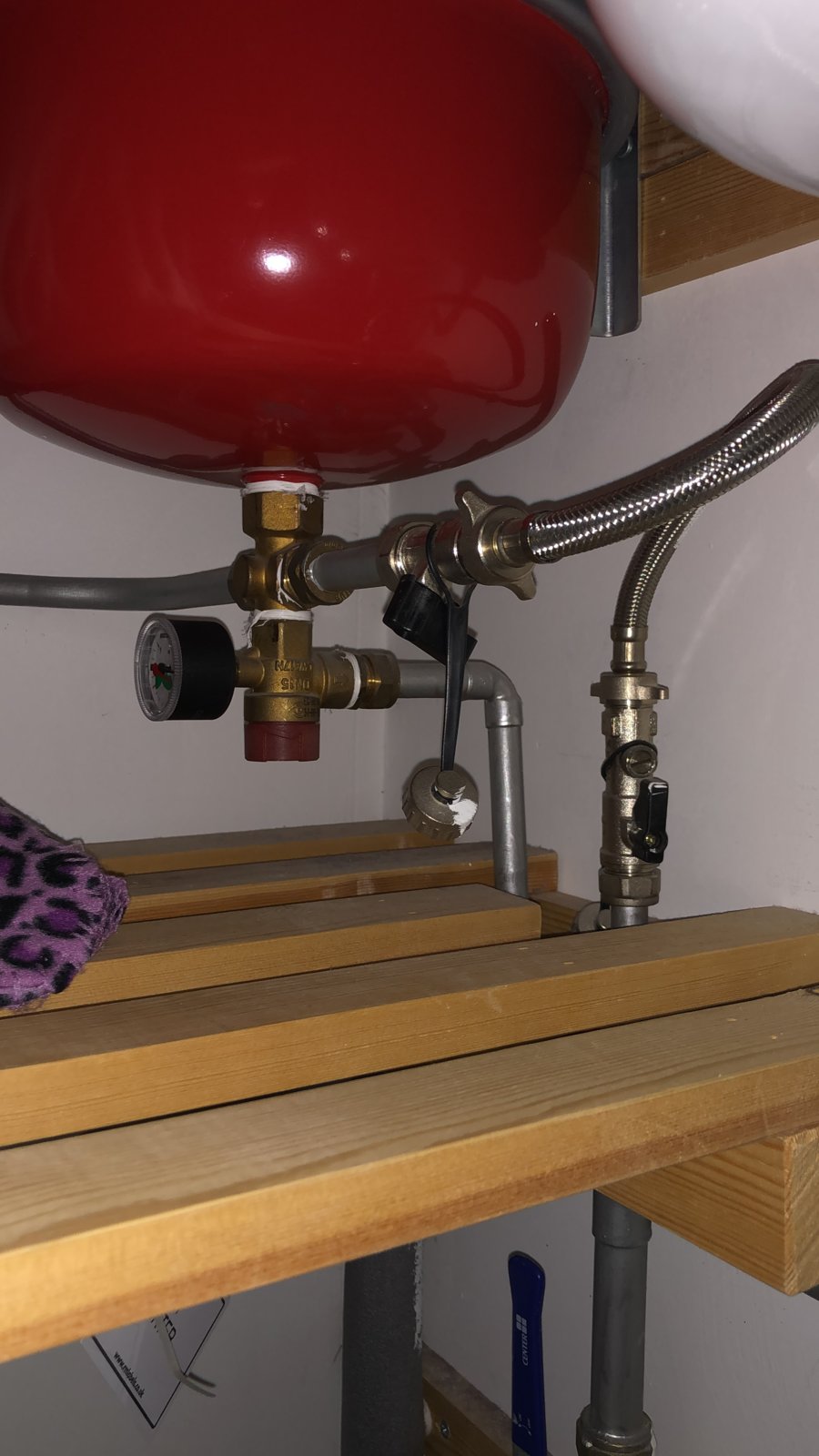

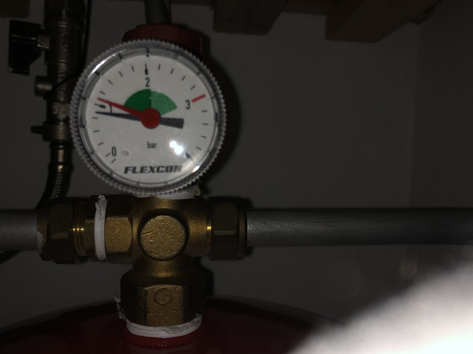

Hi, so we have a potterson promax so boiler and a water tank ... we have gas however the boiler has completely cut out and there is no hot water or heating, the pressure on the tank is very low... how do I increase the pressure? I have tried turning both valves but nothing happens - pictures for reference

In your first photo, with the red item at the top of the photo, below and to the left appears to be the filling loop. The silver flexible pipe, has an isolating valve at either end, the one on the upper /left in the photo is turned to off..
If you turn the knob on that 90 deg, it should allow water into your system. Watch the pressure on the gauge to the left of the valve and stop adding water when it reads 2.0.
Shouldn’t the slotted screw on the bottom valve also be turned 90° too - in line with the pipe/flow? When at the correct pressure, both should be turned off.
Shouldn’t the slotted screw on the bottom valve also be turned 90° too? When at the correct pressure, both should be turned off.
Sorry, yes - I didn't see that!
Once repressurised, then the pipe is supposed to be disconnected on the left and the cap fitted in its place.
All three isolation points should be turned to off, the two valve handles turned to being at right angles to the pipe and the screw slot as well.
Also, I think the pressure when cold should be between 1 and 1.5 bar. 2 bar might be too high.
