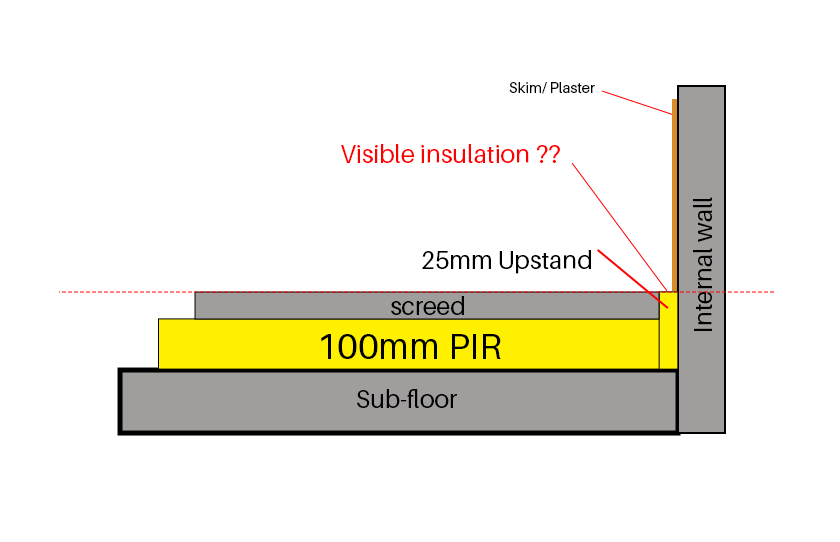

New screed floor being laid in new extension and existing part of the house. The walls are going to be float and set (not D&D plaster boarded).
The internet suggests the 25mm PIR upstand needs to be installed up to the DPC level. Which is roughly where our screed will go up to as well.
By the time the foam expansion strip (which is required for the screed) is added, this is quite a lot of build up off the wall - around 35mm. And would not be covered by the screed either?
Surely this would be visible on the perimeter of the finished screed floor?
Is this correct or am I misunderstanding how this is to be installed?

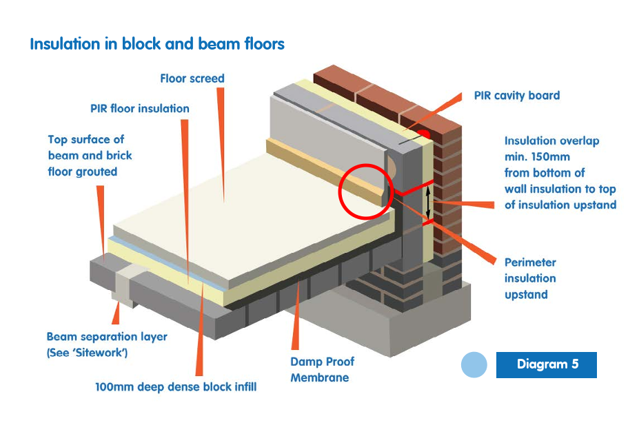

Not a great diagram, I think the circled area is skirting board.
20/25mm thick insulation for the upstand, cut into strips and lay flat against the wall, then trap it in place with the floor insulation.
Or, if the insulation is already down, place against the wall on top of the insulation, hold in place with tape or adhesive.

I placed the red circle to be honest.
The floor insulation isn't down yet - How I've understood it is that if the insulation is 100mm and screed is 50mm, cut the 25mm board to 150mm and place it before butting the floor insulation up against it.
What I'm questioning is whether the insulation will/ should be visible once the screed is down? If skim is 3-4mm, 20mm+ of insulation will be visible around the external walls - I've never seen this on any screed photo. So checking it's correct :unsure:
It’s not an issue, as the screed isn’t the finished floor. The little bit of visible perimeter insulation gets covered by a combo of skirting and whatever flooring goes on the screed.

25mm of insulation is easily absorbed by the dabbed plasterboard (alone) and skirting.
Don't rely on the internet! :rolleyes:
The images you see of 25mm upstands is just lazy detailing and everyone just copying something they saw on the internet
There is no requirement for an [insulating] upstand for screed, merely a thermal break to deal with preventing theoretical condensation from cold bridging.
Use a product that is no thicker than the plaster coat. You can get rolls of expanded or closed cell foam (like underlay), or EPDM foam or suchlike for this very purpose - probably the same thing as the required expansion strip.
BTW, the plaster in your sketch should not be touching the floor surface

I appreciate the upstand isn't required for screed but what about building regs? "....25mm insulation to continue around floor perimeters to avoid thermal bridging".
The underfloor heating kit comes with the perimeter strip which I believe would provide that thermal break? Are you suggesting not bothering with the upstand?

Stick with building regs, not what some random on the interweb reckons!
A thinner upstand will be less effective. 25mm is a good all-round compromise.
Why are you worrying? Unless you're having no plaster or flooring, e.g. a shed, it won't be visible.
We used 25mm PIR around the external walls, and the 8-10mm foam expansion strip against inner walls (PIR will compress if required by screed).
Your wall will get 10mm or more of Hardwall or sand/cement, then 3mm skim. Then 18mm skirting will easily cover any remaining all up.

You mean the Approved Documents, which are just suggestions or one way of meeting Building Regulations.
10mm or less of insulation will acheive the same thing, as will a certain type of block inner leaf, or insulation within the cavity.
Your perimeter strip provides the thermal break that the Approved Document refers to.
