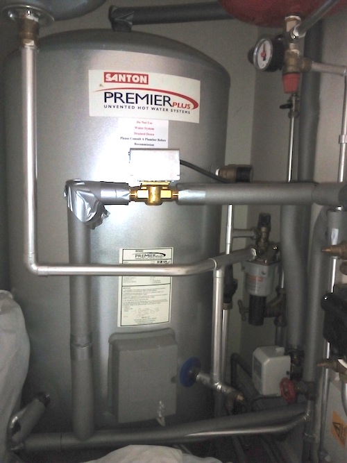

Hiya,
I would like to change my taps (doesn't have isolation valve) and would like to know if anyone knows how or can I isolate the system (Santon Premier Plus) by not drain all the hot water in the tank?
Thanks,
Just in case you havnt got a blanced cold check that it isolates the cold as well by opening the tap
just turn off your mains stoptap and let out the excess pressure. at most it will be only a couple of gallons and then you can change both taps. have assumed that you don't already isolating valves below the taps. if you do then then you only need turn them off!
Ya, there is no isolated valve below the taps. So, I going to change the taps and install the isolation connector as well.

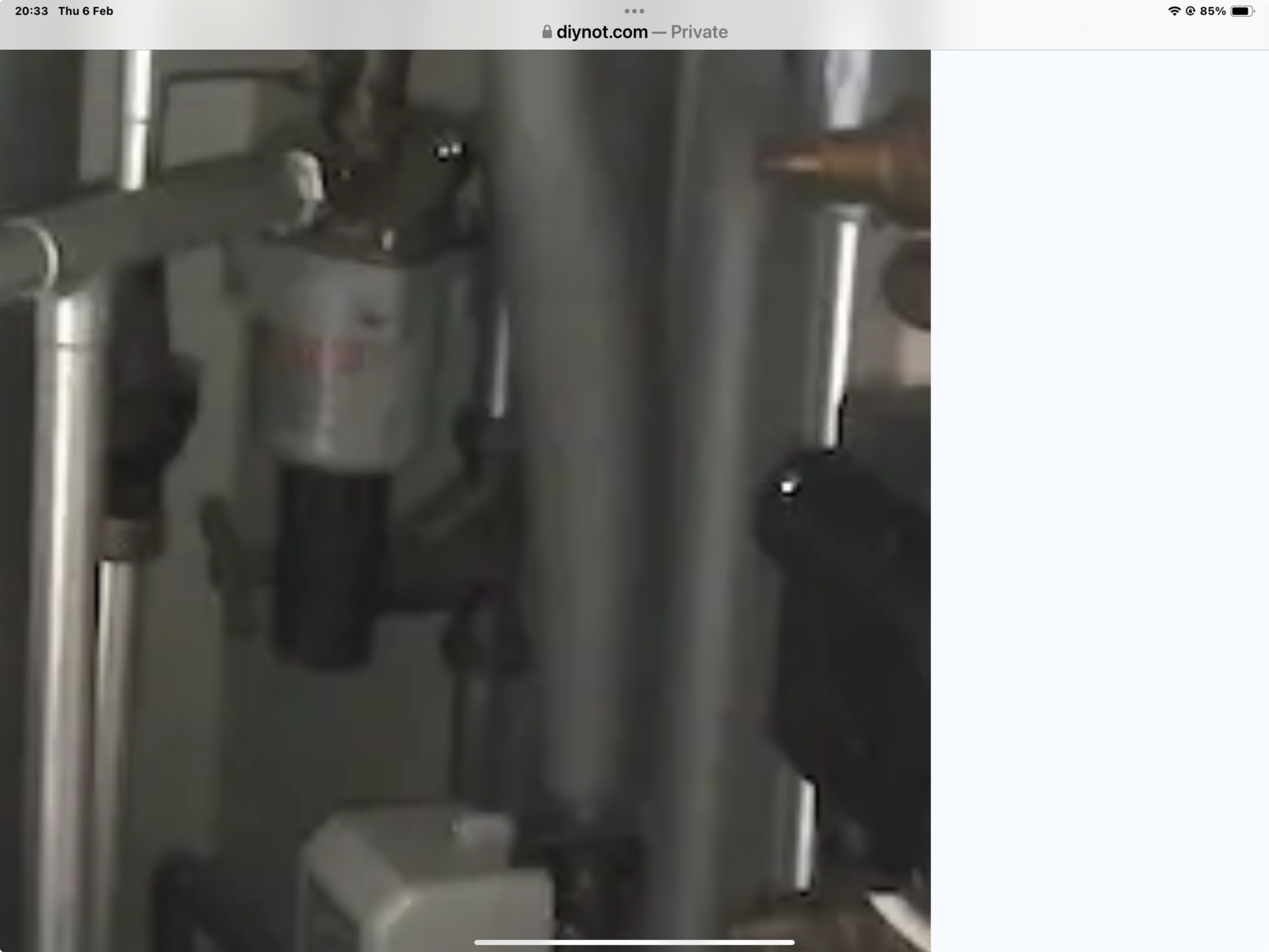

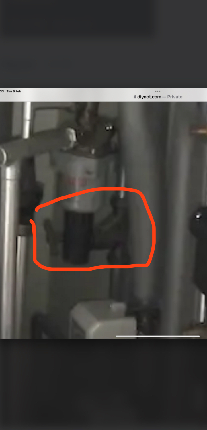

You can just see the stop cock behind, brass with handle, on the diagram they refer to it as isolation valve not supplied. You’ve been looking a long time :p
Do you mean this one ?
Is this supply water into the tank ?
