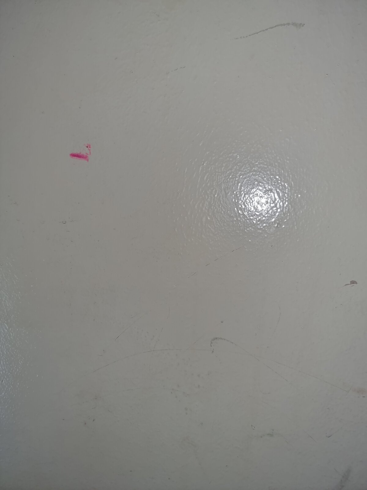

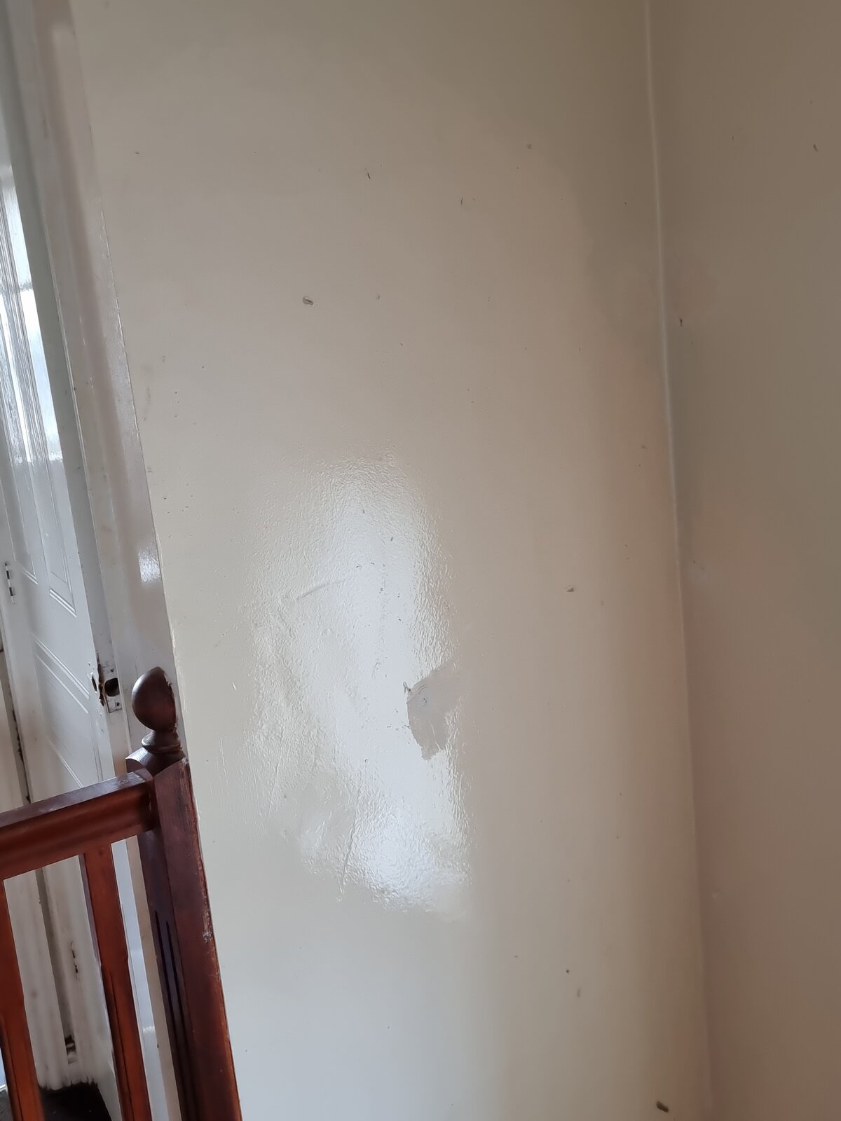

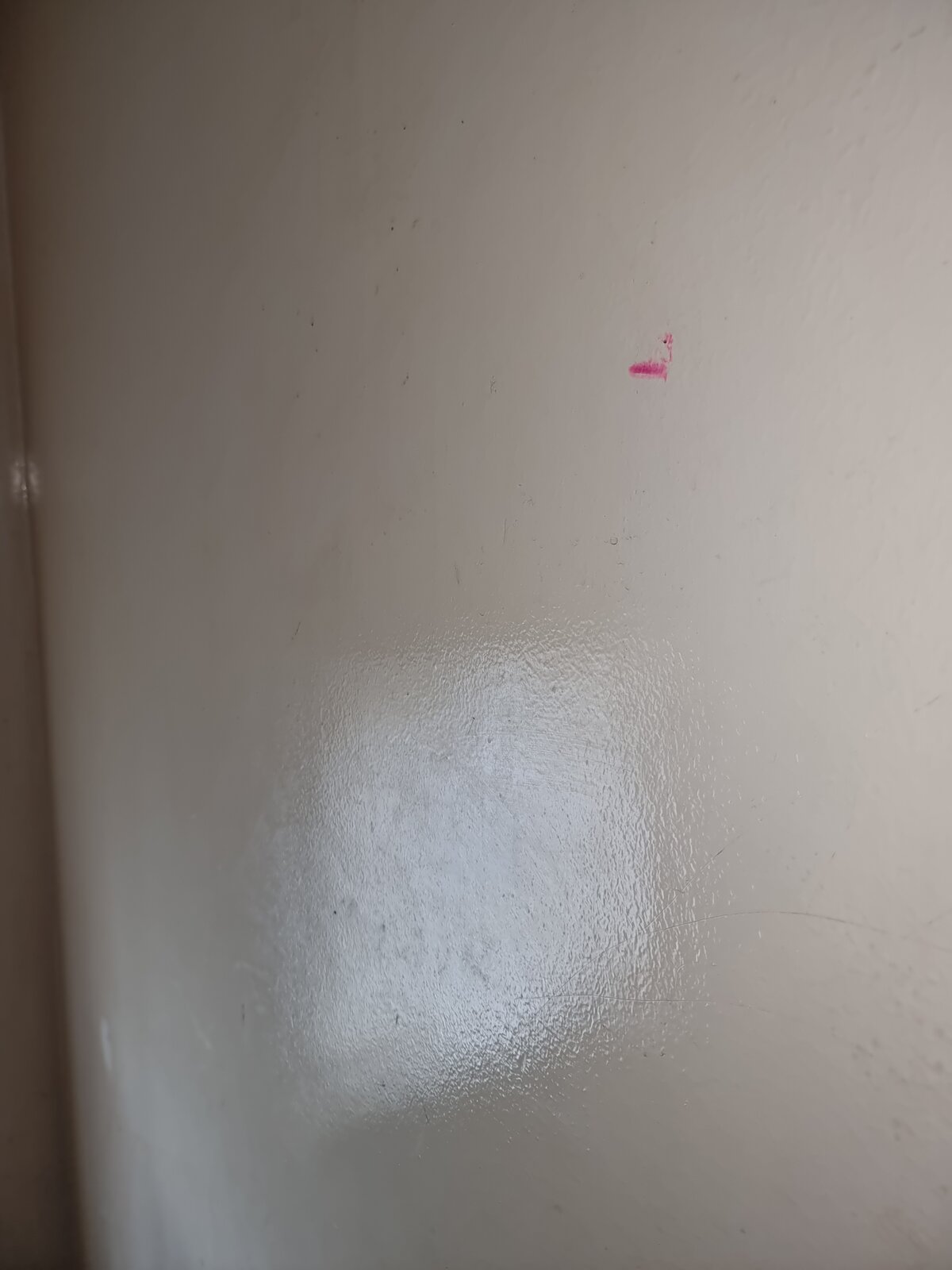

Hi all,
My tenant decided to attempt my house without asking and they did not do a good job. Now they are out and I have a bit of time I am going to attempt to paint myself. They paint that they have used seems to be shiney and slippery almost like a hard plastic or gloss type of thing. What is the best way to prep this to start painting?
Please see the pictures attached

Take gloss off with 120 grade.
Wash
Zinsser Bullseye123.
Emulsion walls. B&Q goodhome durable matt is good for rentals
I'd buy cheap electric sander to make it easy
Wash
I was hoping you wasn't going to say that haha :( I guess there is no kind of primer I could just slap on instead no?
Zinsser BIN then.
Emulsion over after a few hours.
Coverstain takes to long to cure.
Other option as good for rentals is caparol amphibolin. Lash that on
