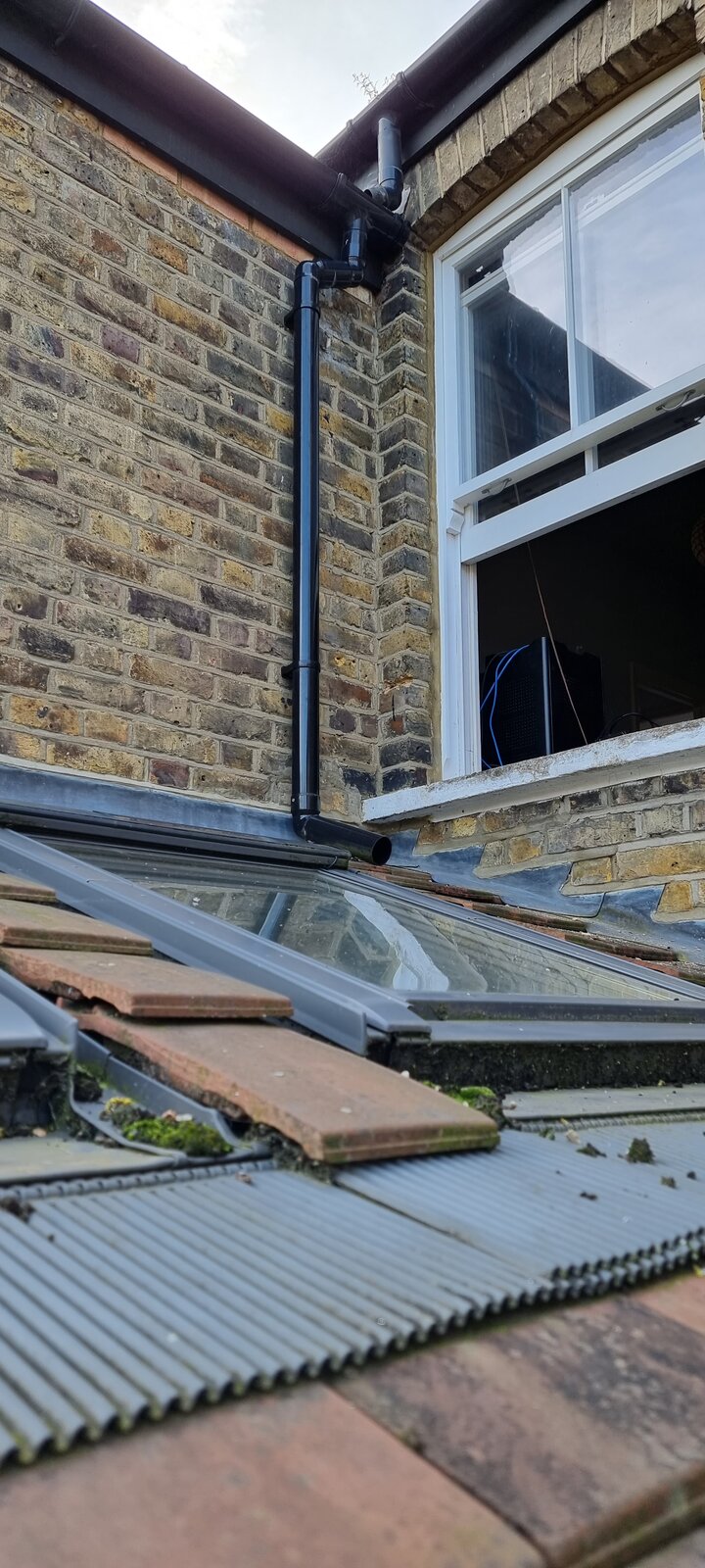

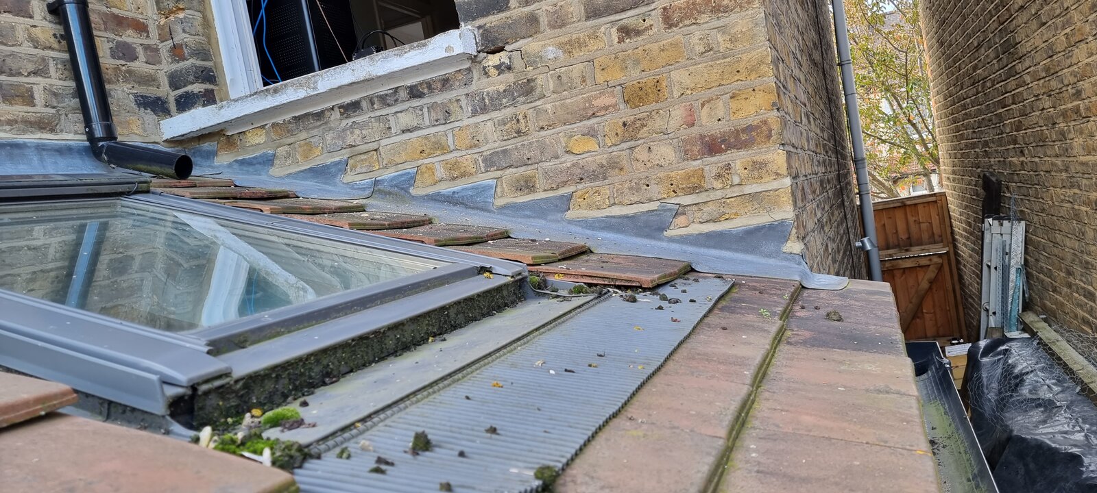

My guttering need sorting. The down pipe chuck the rainwater on the single story extension roof and is soaking the adjascent external wall. What's the best way of sorting it? Thanks in advance for your advice

Needs a hopper at roof edge to allow the two feeds into down pipe and then extend down pipe to lower roof and a second hopper to take the two feeds again .
Extend the pipe.
Thanks. Does it matter if I use a straight coupler to extend or use an s-bend coupler so I can run the extended bit along the junction where a roof meets the wall on top of the lead flushing?
You can do it however you want.
