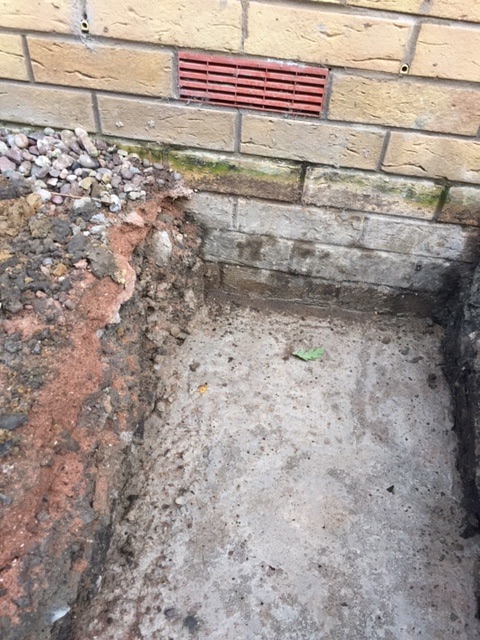

Hi,
I am building a conservatory and now that the foundation have been laid I have noticed that one of the air bricks on my existing wall will be in line with the inner leaf of the wall of the conservatory. So how can i extend this vent to the rear elevation of the conservatory without having to tunnel it under the wall? Moving the vent along on the existing wall would be a big job as will need to knock out several bricks to put in a new telescoping vent through to the inner leaf of existing wall and block up the existing hole in both the inner leaf and outer wall. Is there an easier way to get this vent extended out to the new wall of the conservatory without moving the location of the vent in the existing wall?
i can run a pipe under the floor but it will not mate with the air brick because the air brick is where the inner leaf of the wall will go as can be seen in the pic. As per my measurements about half the air brick will be covered by the wall. Would it be sufficient to angle the pipe out of the airbrick at 45 degrees under the first block so it is under the floor and then run it parallel to the wall to the rear elevation? I suppose this will not affect air flow? thanks
You bang another hole through to the side of it and duct it straight, not on an angle.
OK thanks. Just wondering that if it is a telescoping vent on the other side it will not ventilate properly unless i also put the vent through the inner leaf to the underground ventilation. Also does the pipe that goes to the rear elevation of the conservatory, does it need to be protected to avoid being crushed under weight of floor?
Knock a hole though the whole wall, shove a 100 mm pipe through into the under floor void and then gob the hole back up. At the other end, get a round to rectangle duct connector, and connect that to a persicope vent that goes in the new wall and exits to an air brick just below the DPC. The level of the pipe can be below or within the hardcore, then a bit of sand on the top and then just membrane and concrete over it. Slope the pipe slightly back towards the house to prevent and moisture build up inside it.

You will need 4 x 2.5" pipes to provide the required amount of ventilation.
