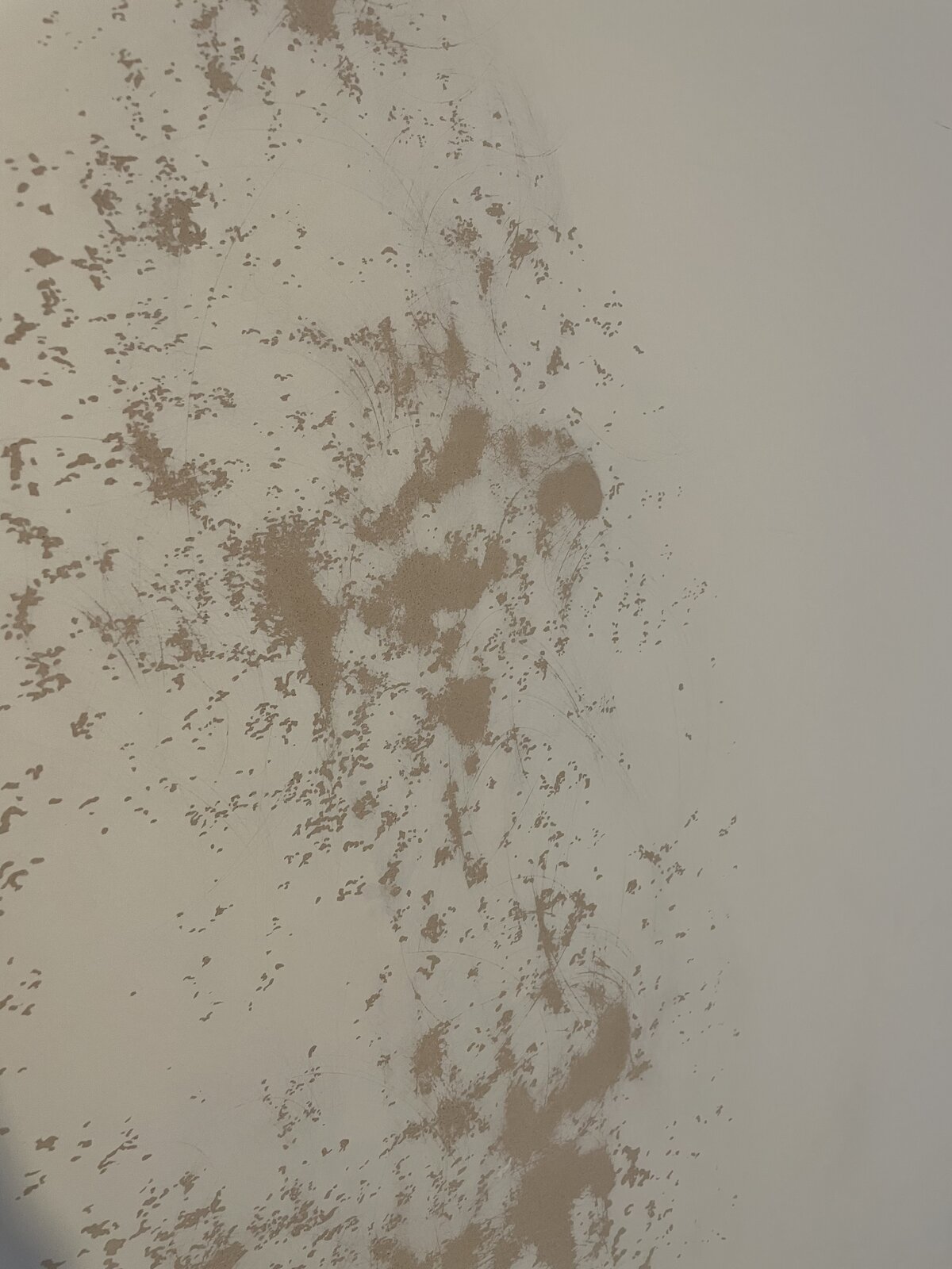

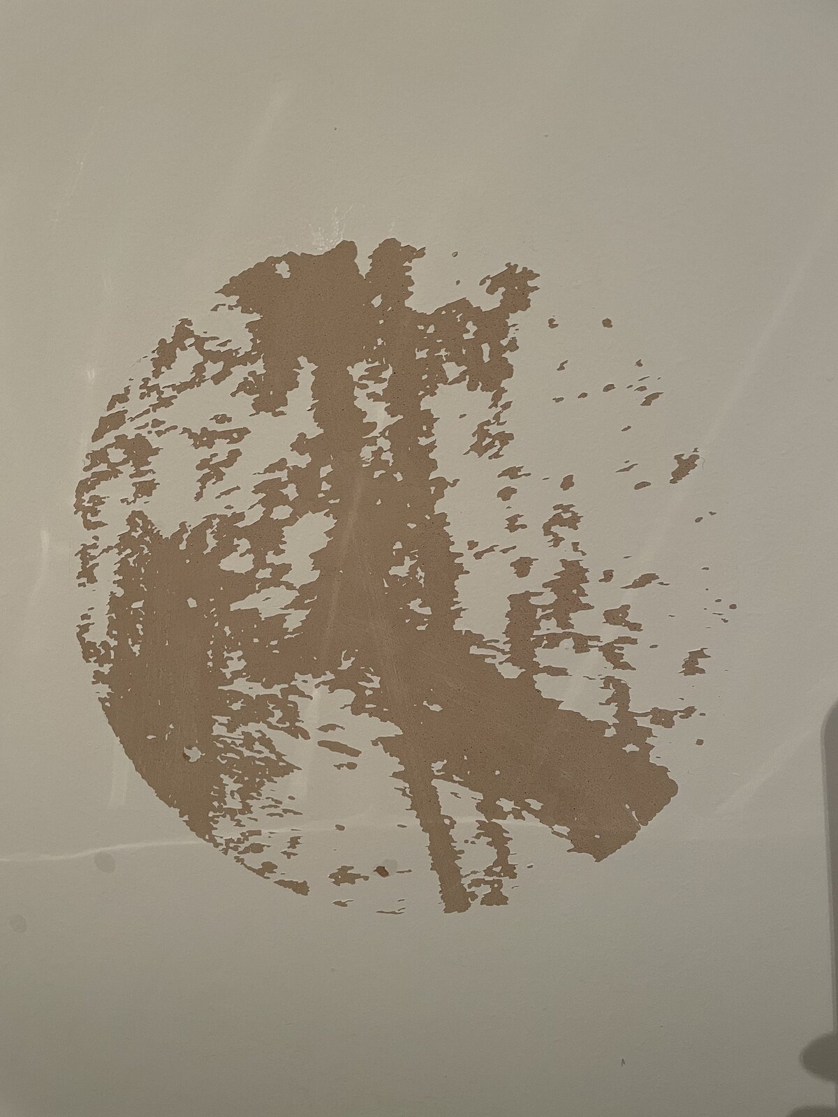

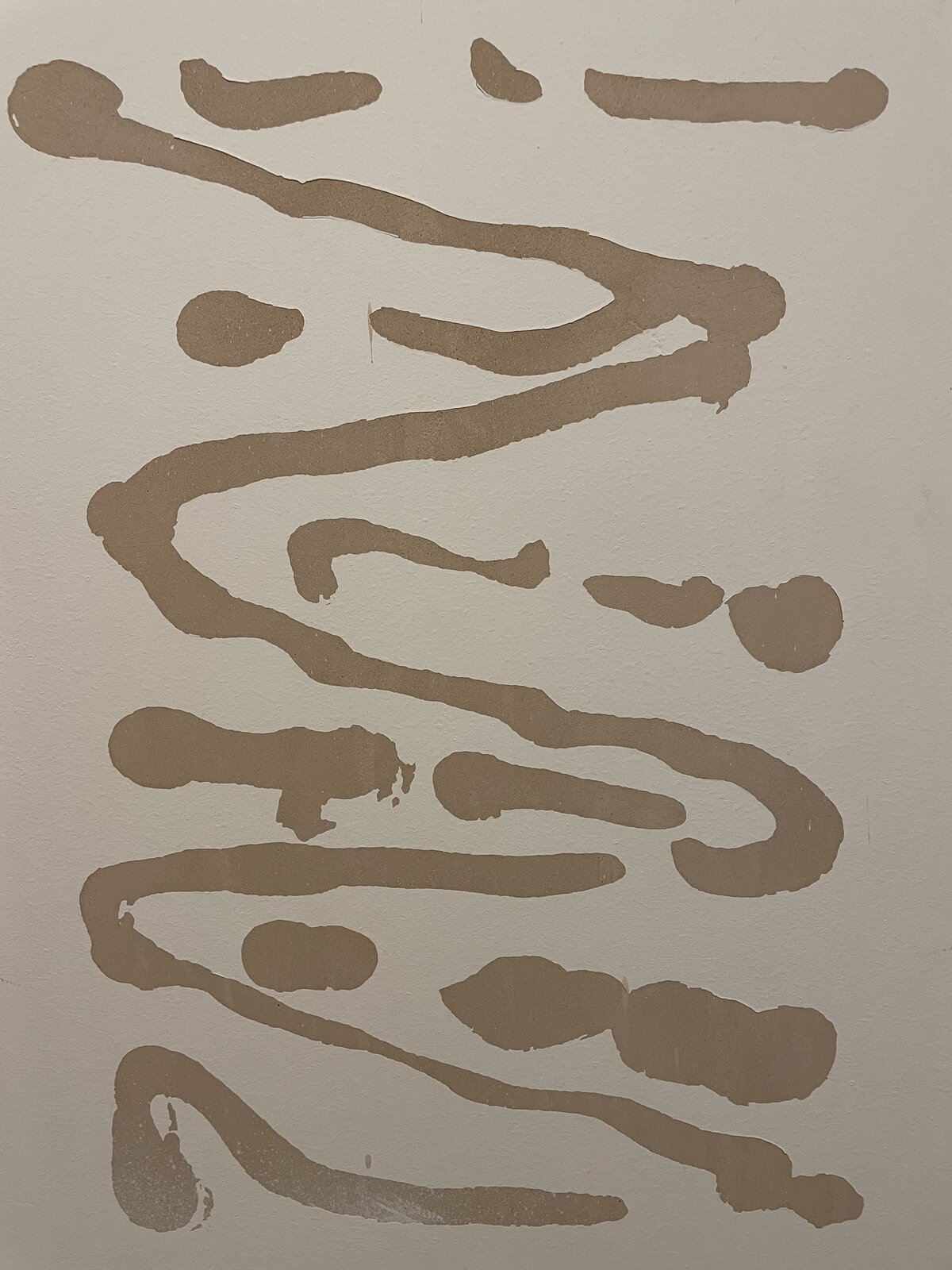

There were a few big stickers on a wall and removing them pulled off some paint , there was also a mirror glued to a wall that ripped the paint off.
i’ve sanded the sticker damage bit its still a bit rough and I don’t want to damage the plaster underneath. How can I prep and paint this damage?

It looks like a mist coat was missed initially. To sort that you'll need a skim of filler on any edges to stop it lifting when you wet it with fresh paint
