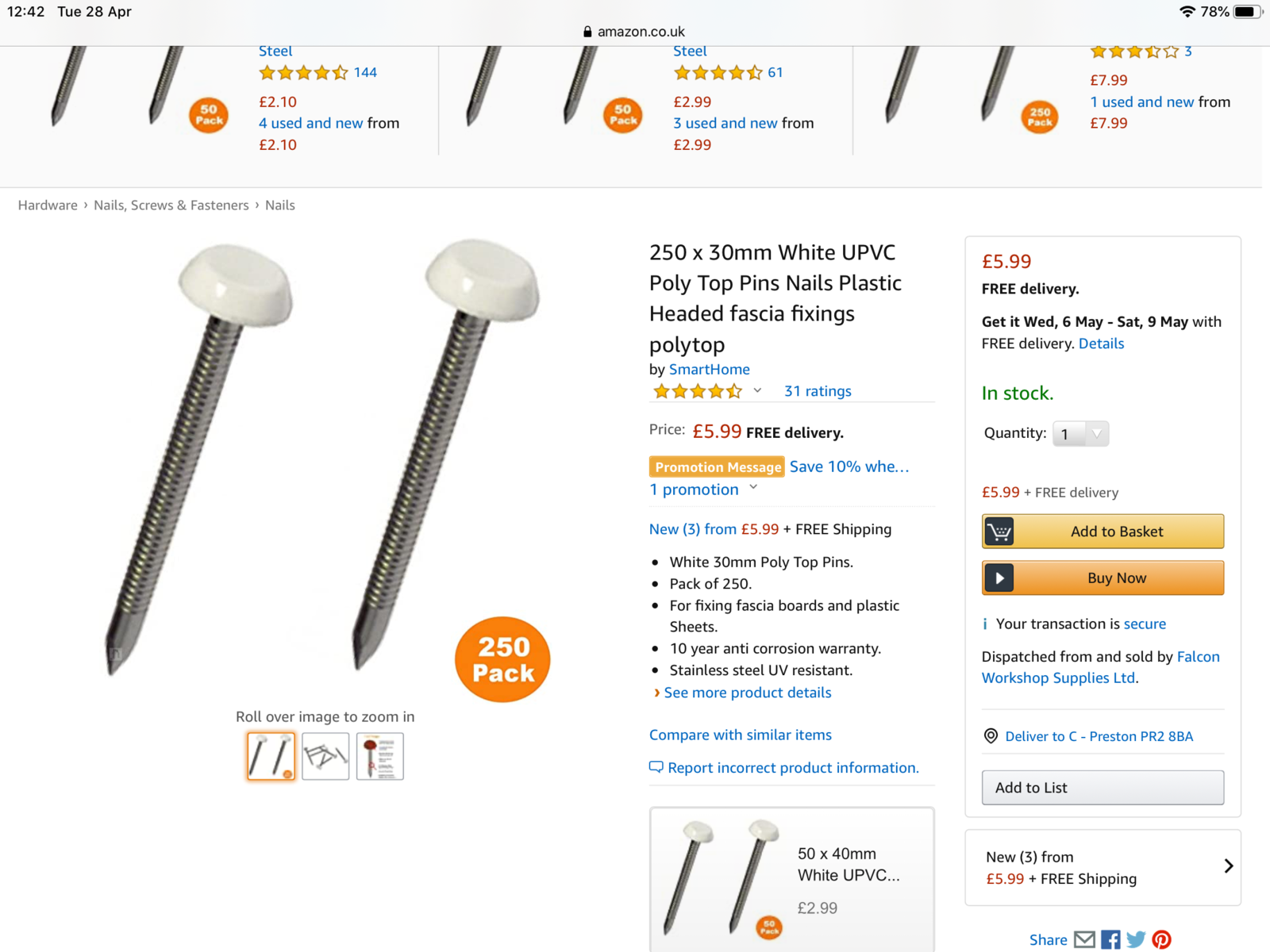

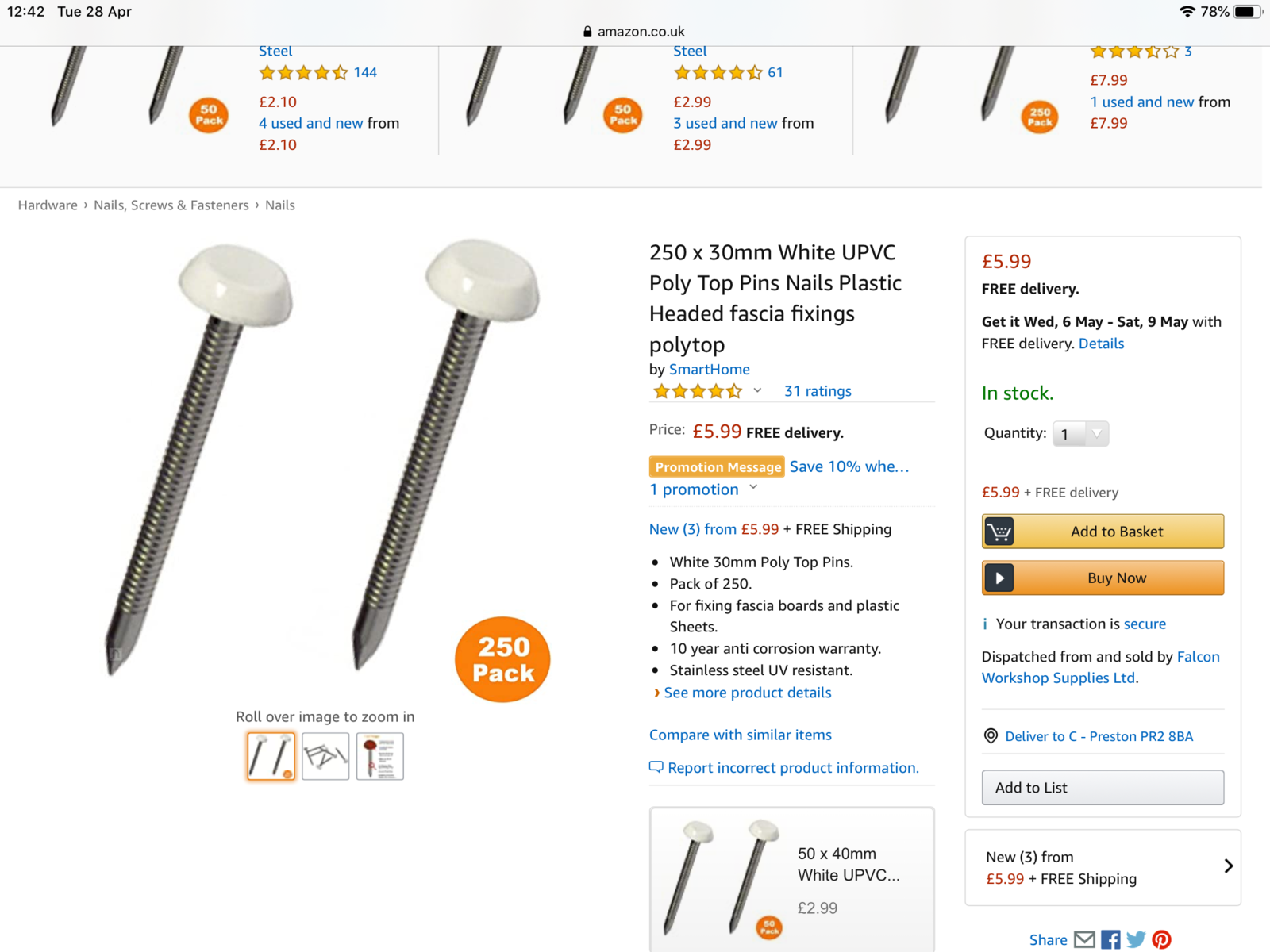

Is there a special type of fixing for these things? I notice all the other fixings have a cap. I assume this is just a screw through the fascia board into the wood (?) below and then capped. A couple of years ago I painted all the fascia board and guttering to match the windows, so it's difficult to see what the fixings are like without damaging the paint, which will need to be done for a new joint anyway.
Poly pins,
Poly pins,
Nice. I've never seen those before. I assume that using a hammer to fix them doesn't break the plastic head? I was also looking at possibly using a plastic dome screw cover as I may even have some of these lying around somewhere. Maybe a number plate cap! I only need a couple and it wouldn't be too much trouble to drill a pilot hole through the fascia board and use a screw to fix it, with a plastic cap.
