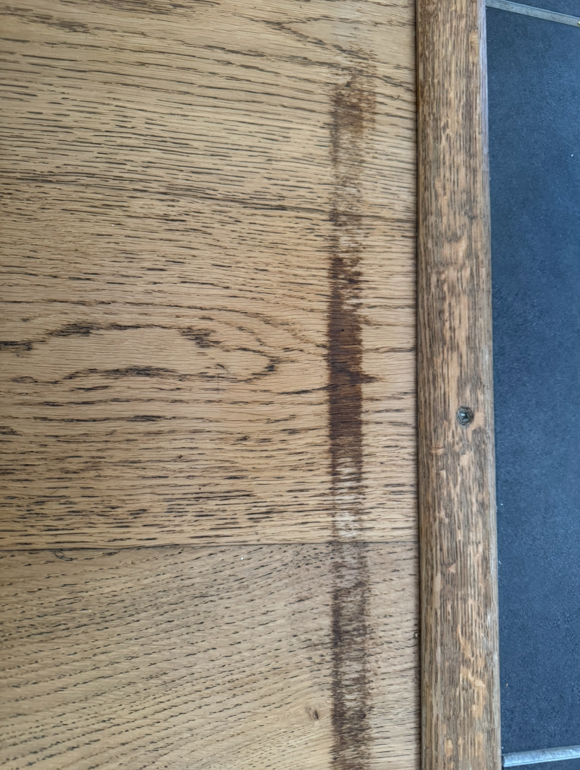

Looking for advice on how to fix this worn area on my engineered wood floor (photo attached). The finish is gone in a strip near the edge, likely from foot traffic or moisture.
Can I repair just this section without refinishing the whole floor? Any tips on matching the color and finish? Also, is it safe to lightly sand engineered wood in a small area like this?
Appreciate any help or product recommendations!
Thanks!

I can't see woodworm?
I can see a small nail hole.
French polishing materials required.
Wood bleacher for that stain.
Light sanding and treatment.
Contact https://www.littlefairs.shop technical helpline
The line looks uniform. Was there some kind of cabinet that has since been removed, and either had rubber/silicon ribs at the back?
It really does not look like foot traffic.
I cannot tell what finish was originally used.
It’s actually the dark line. There was a child gate above it before.
I am going with condensation on the metal gate causing a water stain.
Or rattling of gate by angry child frustrated with its escape route foiled by the gate
Either way you should be able to sand out the mark/stain and re seal
