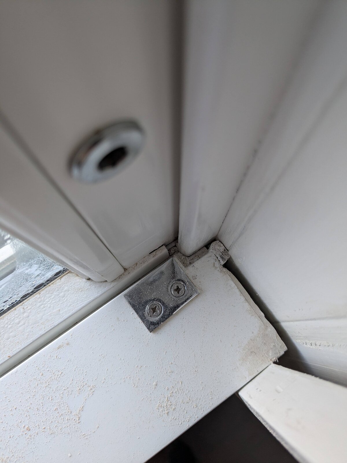

We have very draughty newly installed windows. Supplier has agreed the gaps around the parting bead are too big. They will instead install larger parting beads, but they said they do not seal them.
I'm looking around and I cannot see any products that give a good seal all around the perimeter bead. Typically at best, it's just one one side. Has anyone seen good products, that might help?
I've attached a photo that shows what I think we should have. I've seen sone "DIY" versions of this, but just stick something in - I'm not sure it'll stay stuck... or will it?

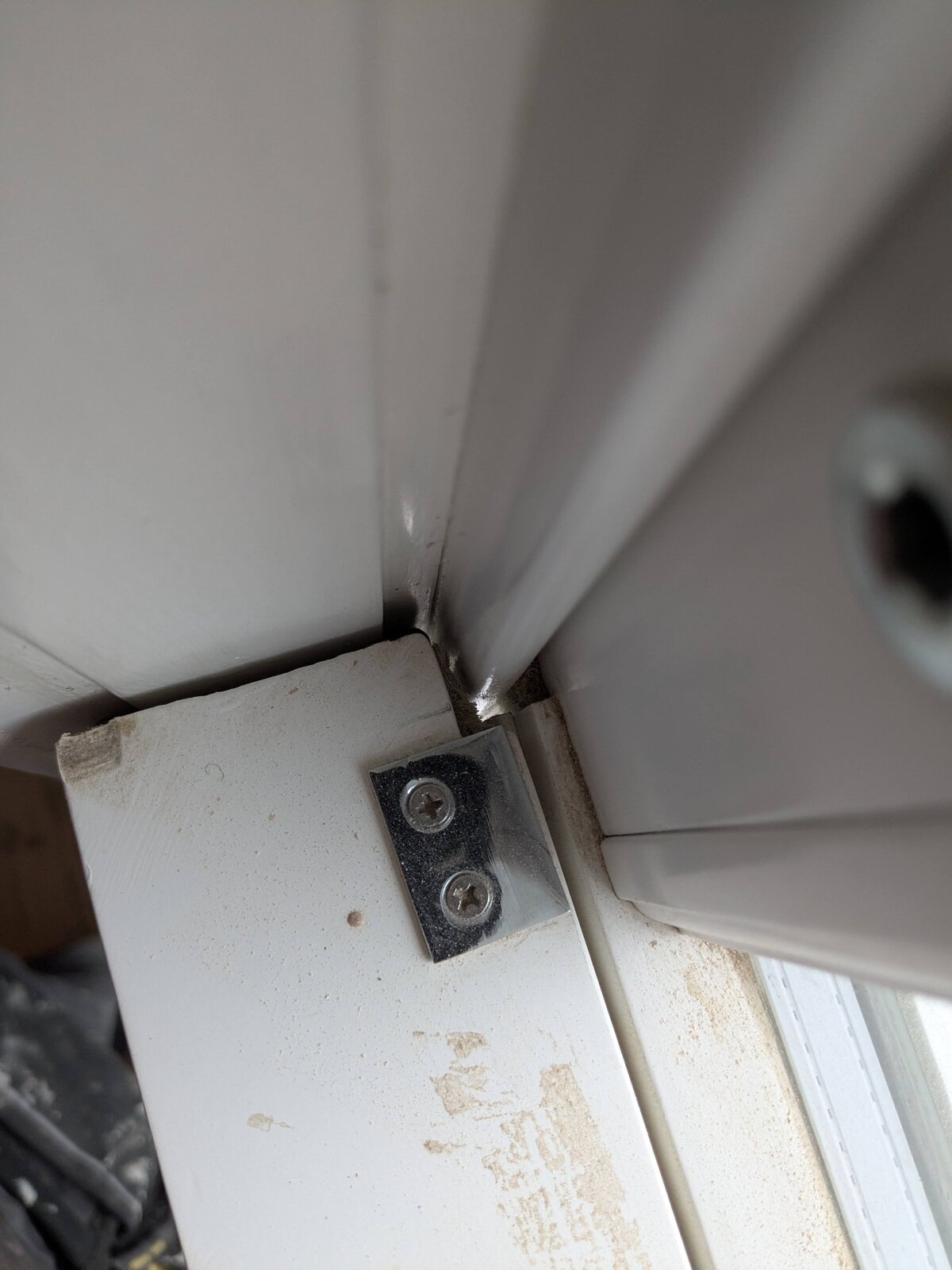

There are gaps on all three sides of the parting bead. Supplier has offered to make the parting bead bigger, to fill the gap. While the gap will be smaller, there will still be a gap.
I've seen the reddiseals and others. They put a strip on one side, which improves it, but it's not the same as ensuring all three sides are form a seal.

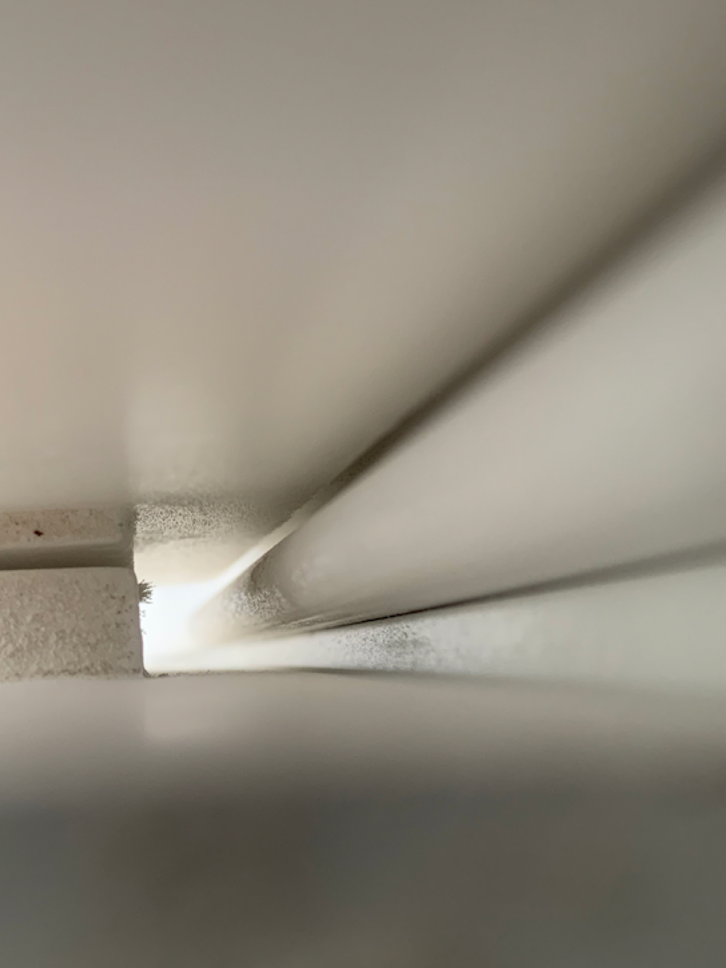

what did you do about this in the end? I have the same problem. I can always see a bit of light when I look down at the parting bead where the two sashes meet.

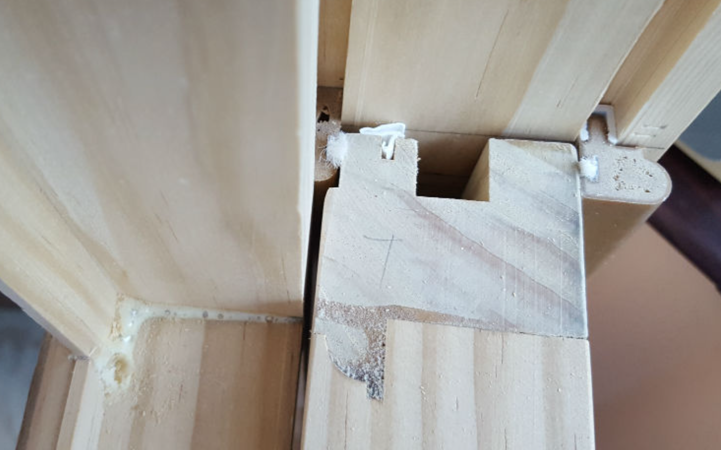

They don't need to be draughty. This is my mock-up section for a load I made. This doesn't show the double pile seal on the meeting rails which were added on the final windows. These are designed for internally beaded dry glazed 24mm DGU. As you see, clearances are tight, but this is accoya and humidity expansion is a non-issue.

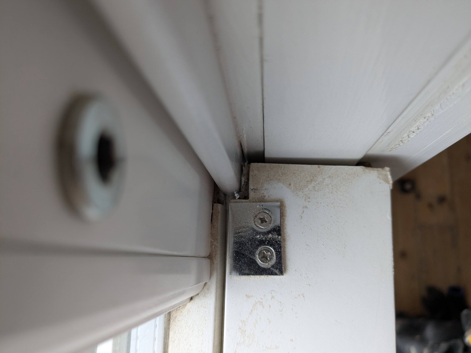

Thanks. I could see lots of gaps and light around the parting bead, as seen here:
So I sealed the gaps using Schlegel seals. No more light coming through, so I think it's totally sealed.
My solution seems to work, but it's a bit of a "hack". Surely someone must have come up with a design or solution that completely seals sash windows where the meeting rail intersects with the parting bead?
