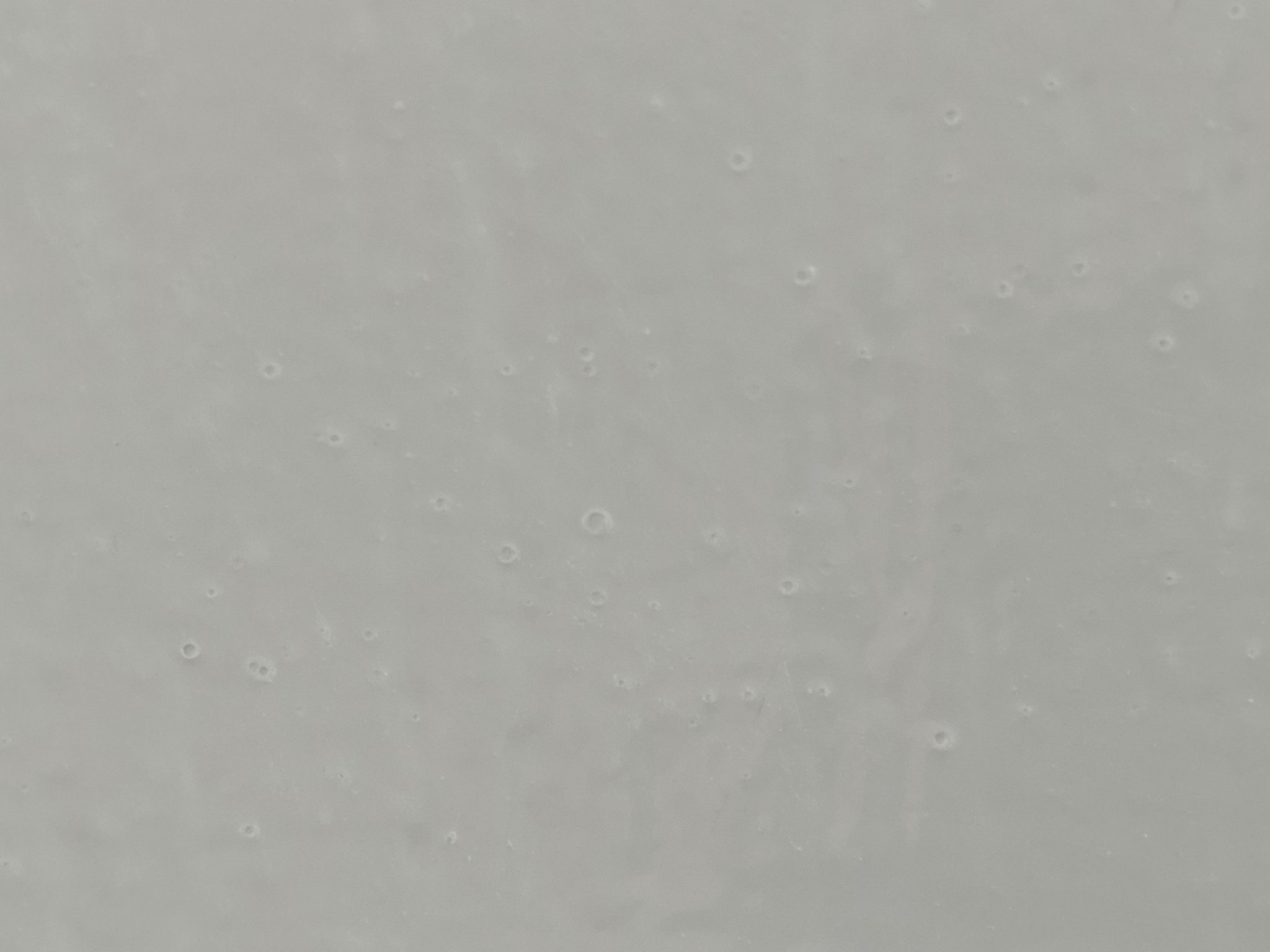

Why is this happening?

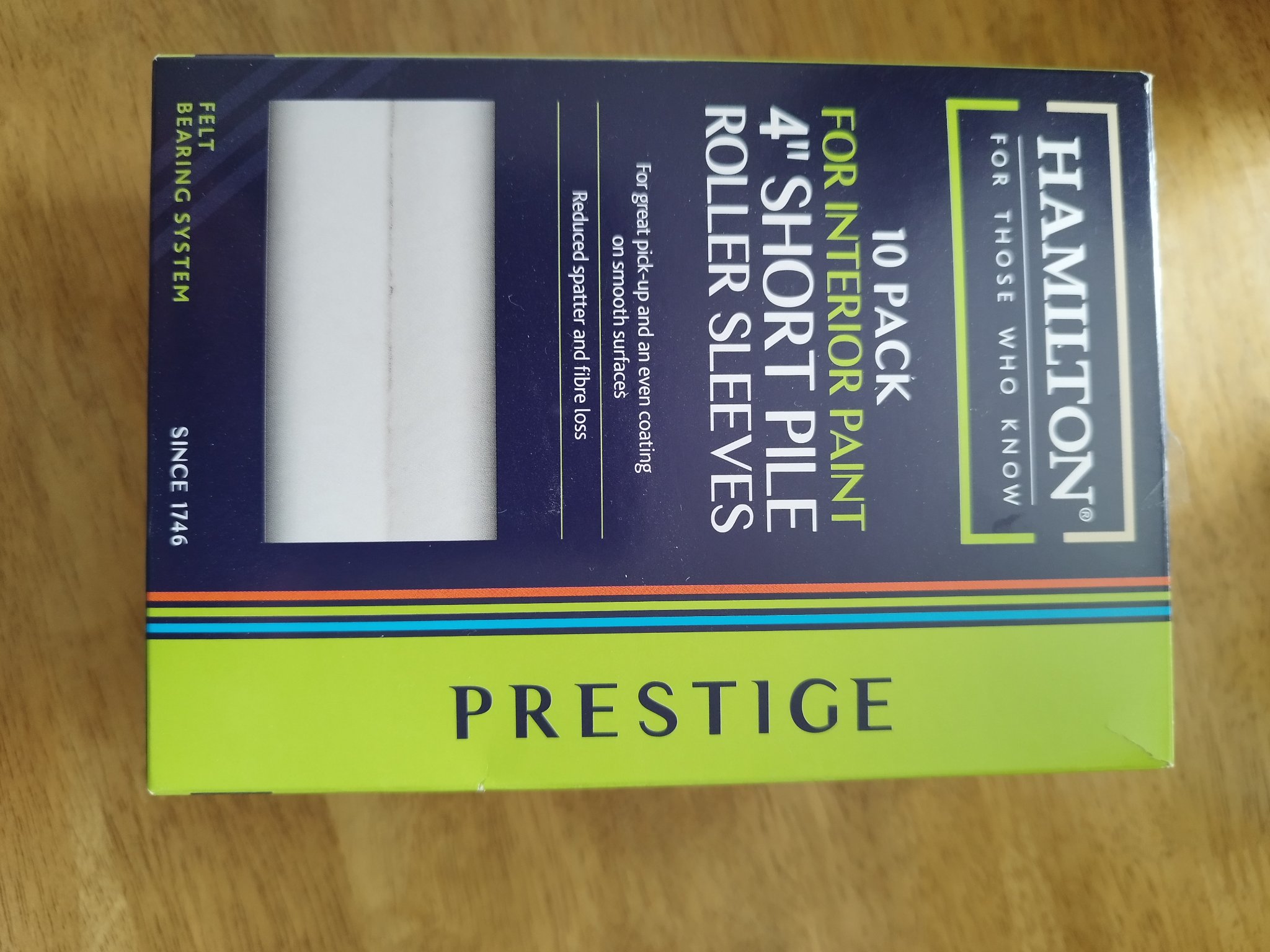

Using the rollers in photo & what looks like burst bubbles have been left afterwards. What am i doing wrong?
Another thing is, the amount of specks of dust i have to denib between coats is unreal sometimes.

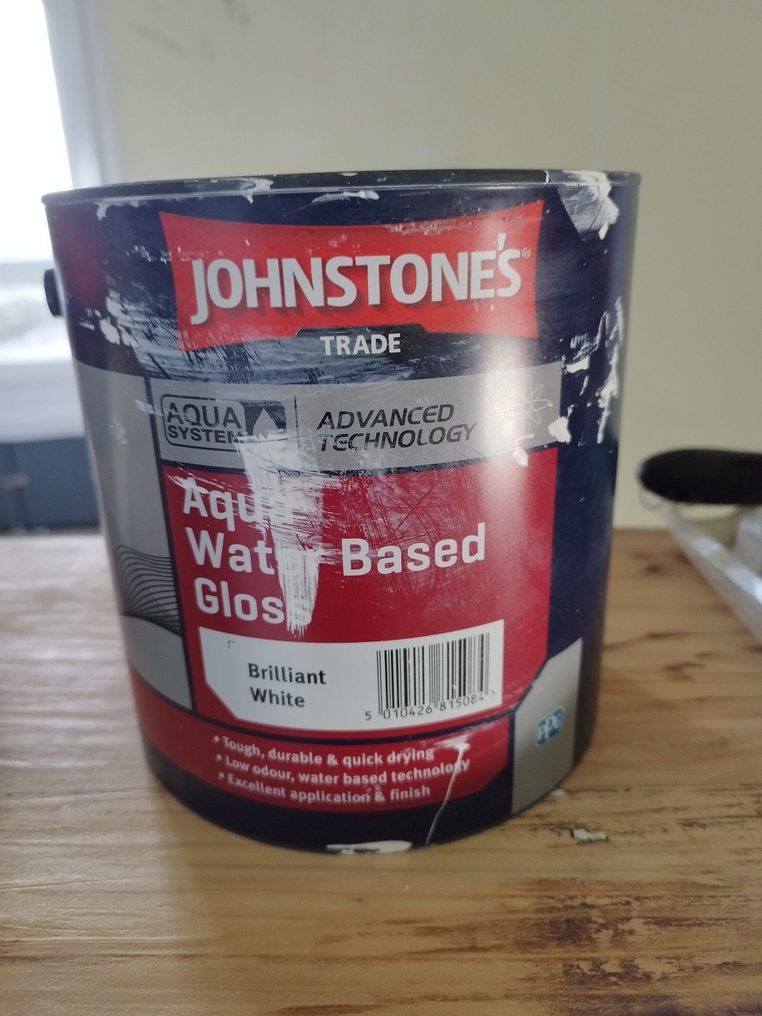

What paint and undercoat you using
They do look like air bubbles which have burst.
I would recommend thinning the paint slightly and applying less pressure. You can use water or additives such as Floetrol.

I wondered if that's fish eye in the paint @opps
I've had that maybe twice over the years but I've always cleaned surfaces

That's the paint+ their undercoat.
I get what you are saying. You could be correct- I dunno.
In my experience fisheyes are far flatter. I could be wrong though.
I have had them when using 2k paints- that was possibly down to me not removing enough of the dust when sanding between coats. When spraying, silicone contamination is a common culprit. But I was spraying raw MDF and it didn't happen with the 1K primer.
I have encountered it when using the likes of waterbased Farrow and Ball emulsion paints over the cutting in lines after I have used oil based eggshell for architraves. Annoyingly, with the F&B, I found it would fisheye days after the OB eggshell had been applied.
In my limited experience, the edges of fisheyes are much less pronounced.
With regards to the F&B fisheyes over oil based paints, the solvents were repelling the F&B emulsion. I had to wait an hour or so, until the emulsion had dried very slightly and then dragged the brush back over it.

Yes, i have done. What i did was go over with the roller again & that seemed to work.
Evidence of bubbles would suggest air rather than contaminants (ie not fisheyes).
As per my earlier post, try less pressure and mist the roller with water so that it is less inclined to expel air. Again, thinning the paint might help, but you have since discovered that a double roll works. Perhaps stick with that and see how you get on. The only down downside with the double roll is that it may leave you with an inconsistent sheen (ie some areas that are less shiny than others).
