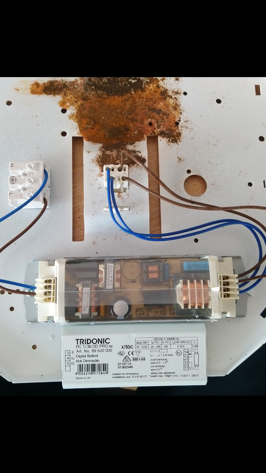

Hi folks,
See attached photo.
My outdoor light has stopped working.
No fuses were blown at fuse box. Light is bolted to underside of soffit and had a heap of water in it when I took the cover off.
Tried replacing 38W DD bulb but no luck.
Wanted to test the ballast but don't know how - I have a basic mulimeter.
Grateful for your thoughts.

Not sure you can with any normal test gear, due to the type of output they give out.
Obviously you can confirm the supply side is ok
All you can do is prove the supply voltage to the ballast is present and correct and try plug in a lamp which you know to be working. Some of these ballasts will not strike a lamp if you plug it in when the ballast is powered. You have to plug the lamp in and then apply power.
Make sure the lamp is the correct type - 38W 4 pin 2D

The mains power is measuring abt 240v.
But when powered on, the terminals that bulb pushes into only at 0.05.
That ballast is obselete now so is it generally ok/easy enough to replace it with similar type? Anyone know how to disconnect the push fit wires? Data sheet seems to indicate pushing a flat blade screwdriver into the slots on top but doesn't seem to work for me......

Not a good idea putting a multimeter across the output of a HF ballast, pretty sure, if good, it could blow your meter
A screwdriver pushed down will release the wires, however as the ballasts now broke, you can either cut them close to the ballast and restrip them again as 10mm shorter is nothing.
Or break the terminal ends off and the wires will fall out, however a screwdriver will release them and you dont need to worry about being gentle now and damaging the ballast.

First check the lamp connection is still ok and not water damaged
Them ballasts earth through the backplate, therefore when you take it out you may see a black burn mark on the back where its blown

Thank guys.
Still couldn't get the wire out the ballast even pressing down the slot with screwdriver but managed to break them out eventually.
Took the old ballast off and it has some blackness behind it.
Thankfully managed to source a like for like ballast on amazon 16 quid. So hope that resolves things.
More concern is how the water is getting in. It must be running down the pitched roof soffit boards and entering the light fitting through the hole that the power cable comes through. Not sure what the hell can do about that though..... Will suck it and see if happens again..... Cheers
