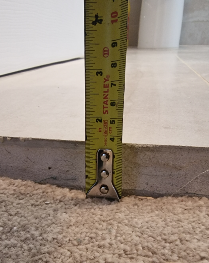

New bathroom fitted with UFH, so the floor is no longer level at the transition.
There is about 40mm between the top of the tiles and the floor under the carpet.
