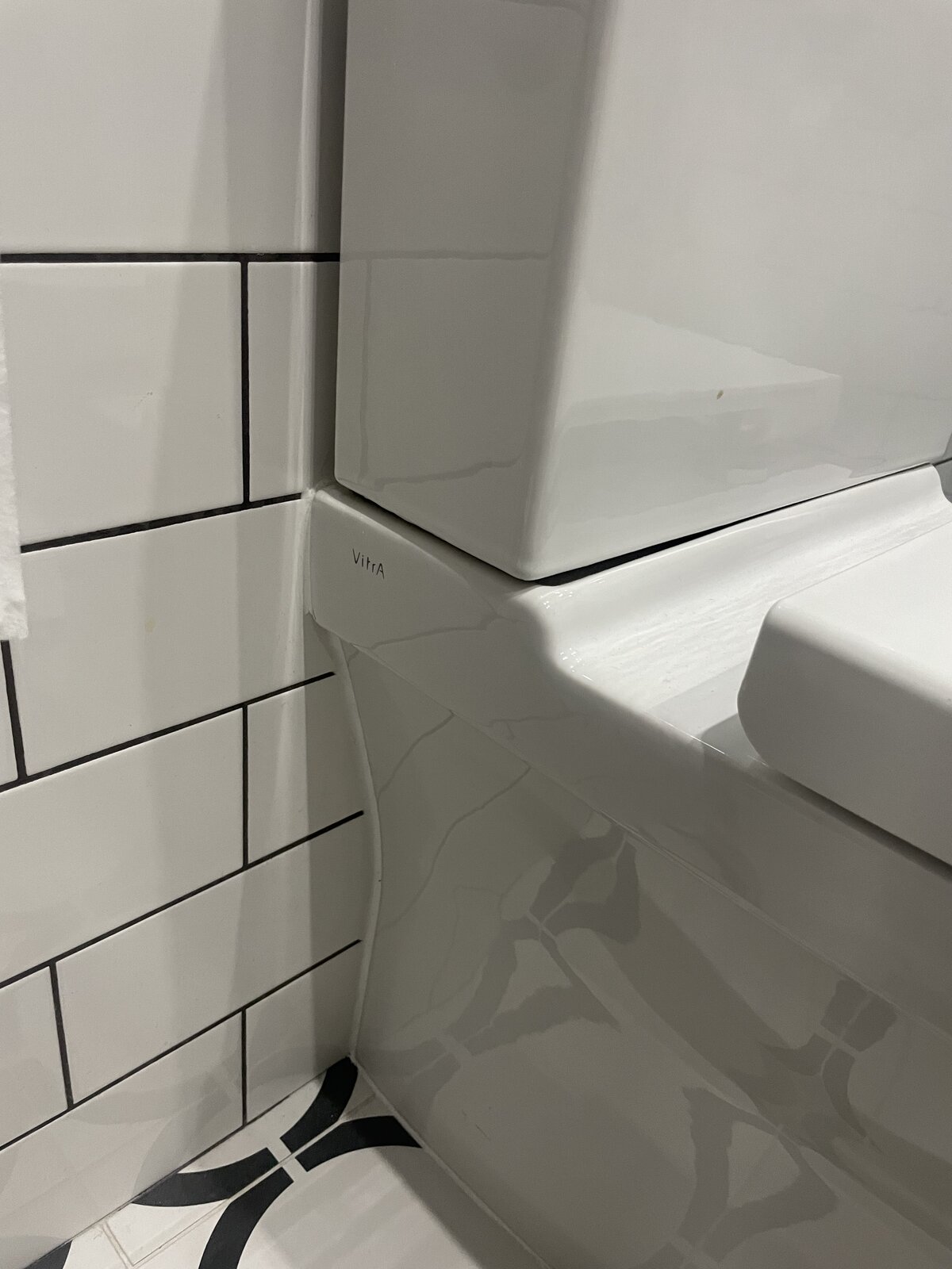

Hi, we need to fix the flush in our back to wall toilet, the part the fills water into the cistern is running really slowly and spraying water. I was planning to buy a new part, but first I need to drain the cistern and I can’t work out how to find the inlet pipe to turn off the water? It’s a vitra s50, and its fits onto the wall, so the pipes aren’t visible. Does anyone have any advice please? Thanks!
Have you got access to below the cistern to look for an isolation valve ?
Show us some pics of your set up particularly what access you have to the cistern.
You may be best to turn your water off at the stopcock to investigate the cistern issue
Unfortunately,with that type of toilet you have to free up the toilet pan from floor and wall ,then pull it forward ( away from wall) to be able to replace the float valve. Once away from the wall several inches you will see the isolation valve ( assuming one is fitted ,which they invariably are). In the unlikely event that an isolation valve hasn't been fitted,turn off the mains cold water stopcock ,and fit one .
That’s how mine is fitted. Isolation valve onto a flexi pipe with a flexible pan connector. Slide it out a bit, turn the water off and do the reverse when refitting it.
Probably much easier to turn off the water at the main stop tap, rather than breaking the sealant and all that palaver if it's not easily accessed.
