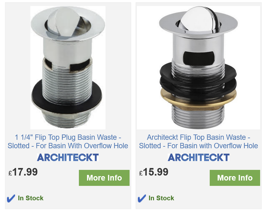

I replace the pop-up and click-clack basin wastes with the 'captive turn' style Madrab mentioned earlier in the thread aka 'flip waste' s as the others give trouble. SWMBO had a job with the click clack not staying down or opening back up and pop ups were hard to operate for her... and we had seen and used the flip wastes in some hotel stays. Easy peasy to use for her.
Do not get the type with a rubber ring on the flip part - quality chromed brass versions seal perfectly - and the ring can make the mechanism 'stiffer' to use (hotel experience). Mine are branded "Architeckt" and we bought from Amazon. Not the cheapest but not that much more than the rubber ring offerings. There are probably other equally good brands available.
I see they do both the rubber ring type and spherical seal:
Well I never --- and I thought Amazon @ £13.99 were expensive for the non-rubber seal version. (£1 more than when I last bought a pair exactly two years ago, though).
