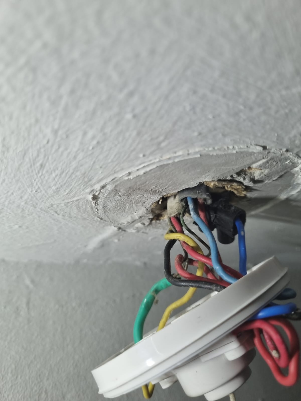

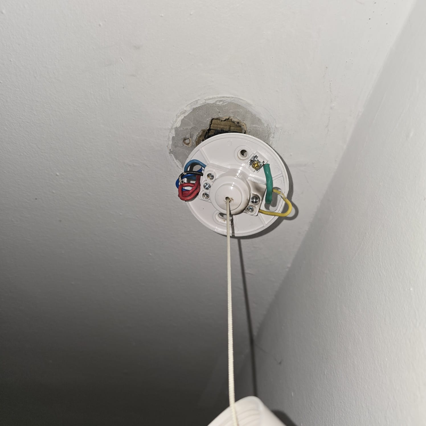

I had the electrician came about 2 year ago who messed up our wiring basically the light bulb directly outside the light bulb blinks all the time therefore we have removed the bulb, now I thought to look into this over a long weekend so please if someone can help me to resolve this issue. What he did to the pull switch wiring Put the BLACK wire in COM, 2 REDS goes into COM2 and BLUE goes into the BLACK Wire which is really short and cant pull it more. YELLOW wire was left outside I have tried to put the YELLOW wire in COM, 2 RED wires in L2 , BLUE & BLACK wire in L1 but it blinks and also left the BLACK wire. I have attached the picture.

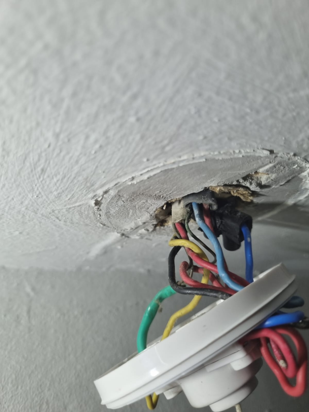

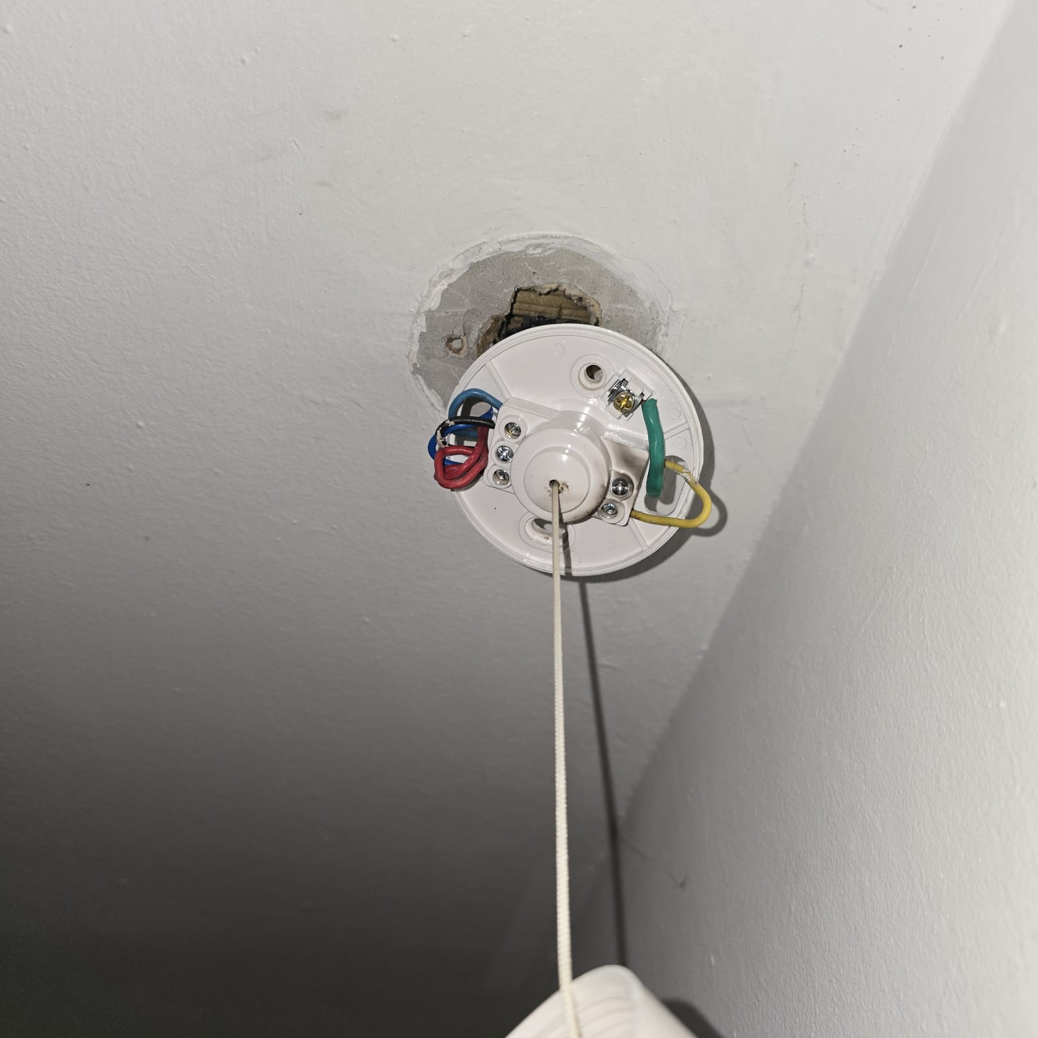

(So, the pictures you have attached are after your efforts ?
There is some evidence of "overheating" near the now unused terminal in Picture 1)
You have two cables coming in from the ceiling.
Cable 1 (which may be White) has Red, Black, Yellow and Earth conductors.
Cable 2 (Grey) has Red, Unknown (extended in Blue), Green (?!?!?) and Earth conductors. (Unusual, to say the least !)

A strong contender for any "Loose Connection" would be the screw connector connecting the BLUE (Neutral) wire,
which is shown in Picture 2 of Post #1.
There are two cables coming in from the ceiling at the Pull Switch:-
Cable 1 (which may be White) has Red, Black, Yellow and bare Earth conductors.
These will be the Line and Neutral coming in via the Bathroom Light Fitting
together with the Yellow "Switched" Line back to the Bathroom Light Fitting.
Cable 2 (Grey) has Red, Unknown (extended in Blue), Green (?!?!?) and bare Earth conductors. (Unusual, to say the least !)
[While I really cannot imagine what function is performed by this "Green" insulated conductor (apart from an insulated "Earth" conductor) it does not appear to be in use.]
Fairly obviously, the Red insulated conductor is the Line to the Ceiling Rose of the "flickering light"
and
the Blue insulated conductor is the Neutral to the Ceiling Rose of the "flickering light"
connected to the Black insulated conductor in that Cable
via a screw-connecter
which probably IS the site of any loose connection!

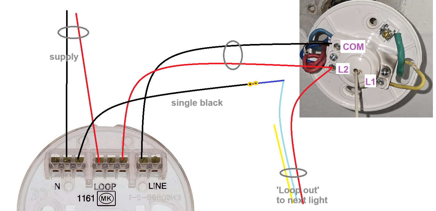

I have made some guesses in decyphering this:
2 RED WIRES in L1 and 1 BLACK WIRE in COM by leaving YELLOW WIRE outside
Switch terminals are as shown in purple on the assumption the wires have not been moved around too much.
and by connecting BLUE WIRE with very short BLACK WIRE
I wonder if the short piece of dark blue extension of the single black may be a recent change and the light blue went into the connector block.
I have WHITE (OLD STYLE) wire with 3 wires RED, BLUE & YELLOW coming out from downstairs(behind the pull switch)
3C&E is 'loop-out' to next light.
then I have RED & BLACK wire and 1 BLACK wire which is very short behind the pull switch.
T&E is standard switch drop with an additional single black which would tally with;
I have also checked behind the actual bulb wiring which looks fine 1 BLACK wire on left, 2 BLACK wires on right and 2 red wires in middle for loop.
Bathroom light has conventional loop arrangement.
If those guesses are correct then my suggestion for the electricians wiring follows.
It is also feasible the 3C&E is/was the feed to an extractor fan with the yellow into 'COM' with black. As the 3C&E is described as 'coming out from downstairs' it is also possible it's the 'loop-in' ie the other way round to this suggestion:
Thoughts please.
Thanks for all your help I will give it a go and get back to you, your illustration is very clear and much appreciated
