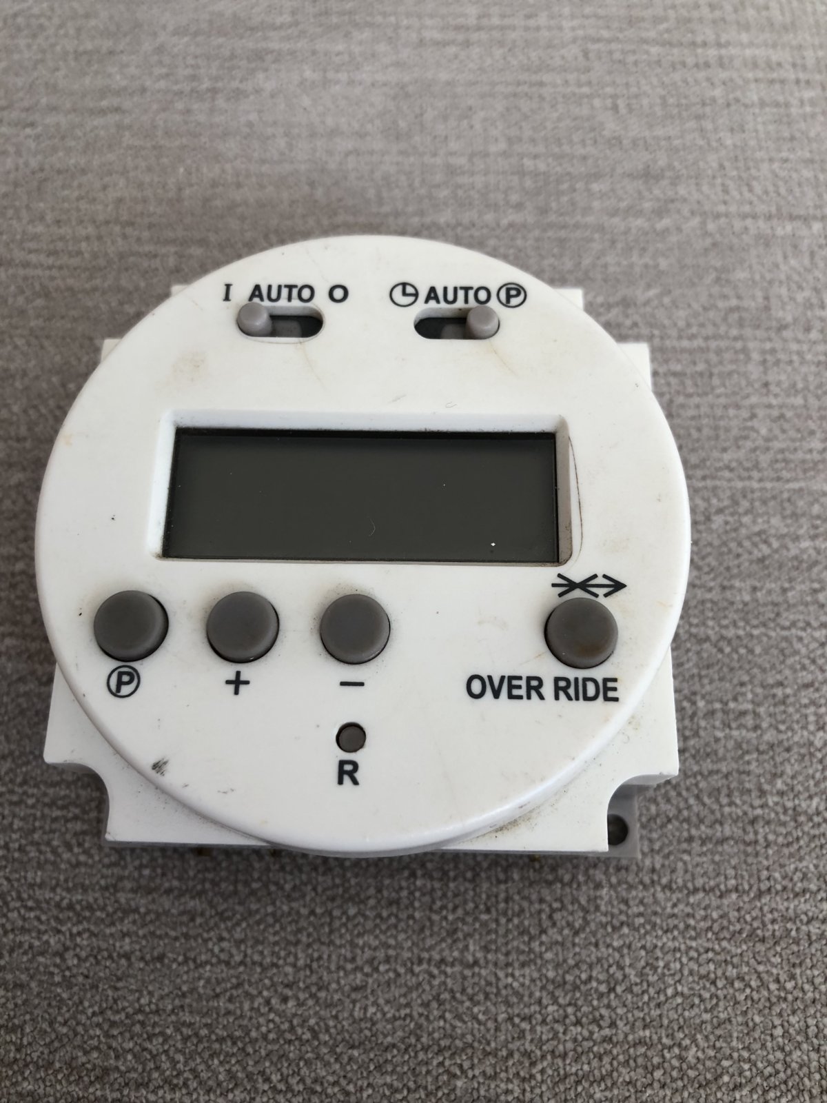

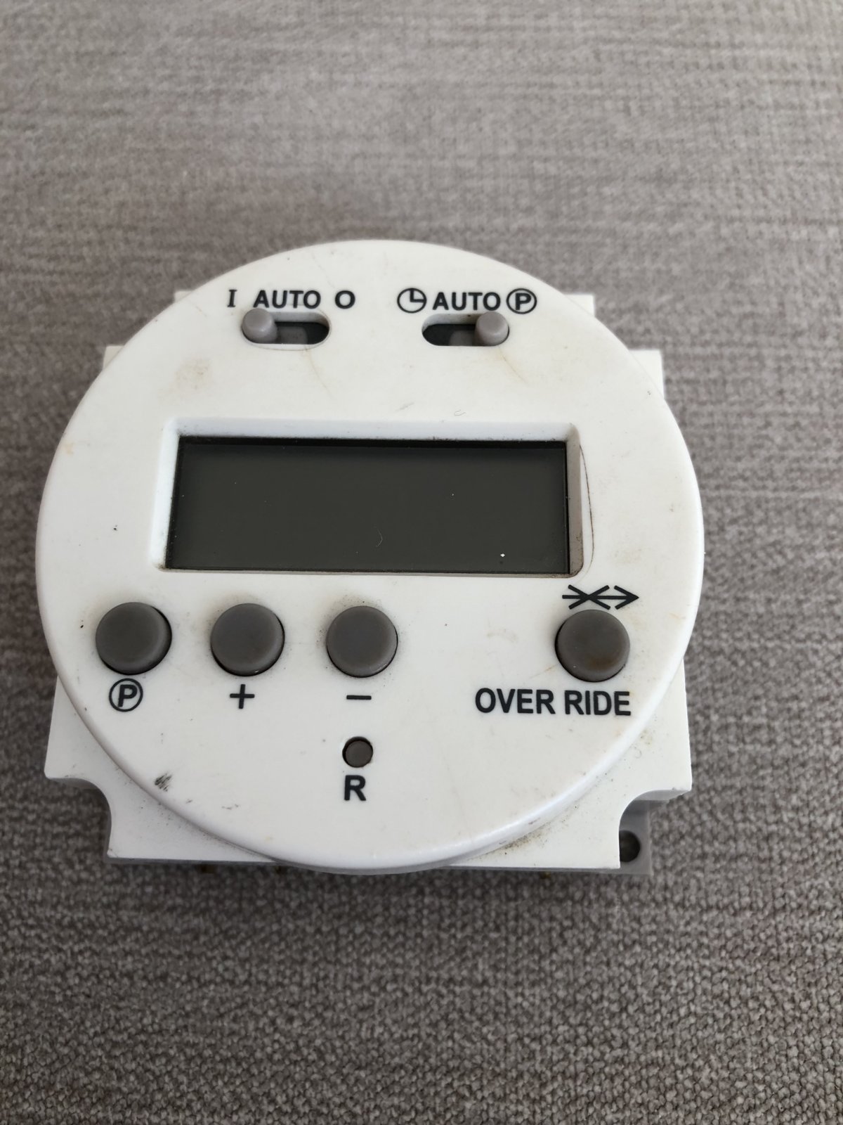

Moved into a property which has an Ideal HE24 boiler (yes I know they are not great) it currently has not timer control or thermostat; however the previous owners have left a timer control they never got around to having connected.
How easy it is to wire into the boiler? I presume the mains power to the boiler needs to be diverted to this? Any help would be appreciated. I am fairly handy so would rather have a go myself.

It’s not as that controller would just need to sit in fresh air with 4 240v wires hanging off the back of it.
Really not helpful
But completely true and trying to keep you safe.
What are you planning on mounting that timer on?

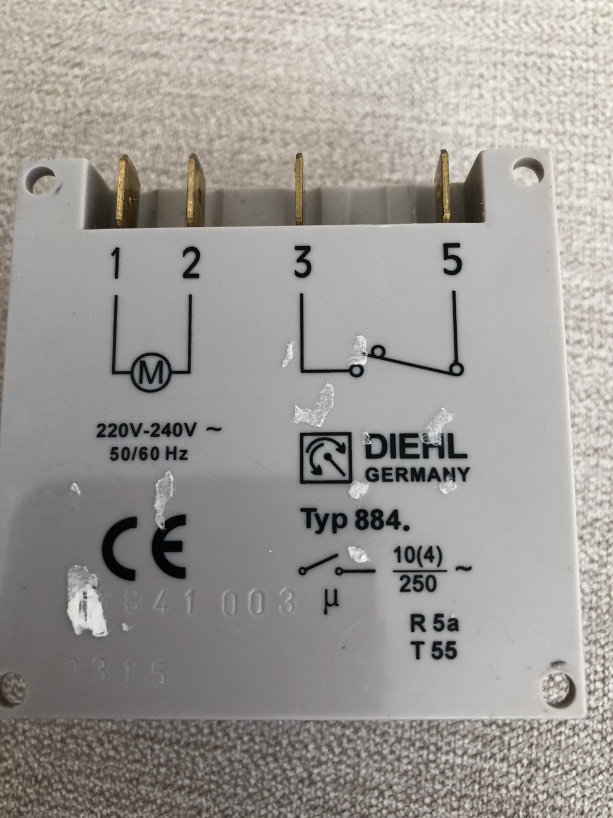

It’s an integral timer for a different boiler, that can be wired in easily to that old Isar.
But say I tell you how to do it and the timer is lying about with 4 live wires sticking out the back and you electrocuted yourself?
Do you have proper insulated spade connectors?
So I think it’s really helpful.
I had no idea it was from a different boiler - assumed as they said they hadn't had chance to have it connected it was for the Isar HE24.
I do have proper insulated connectors and wouldn't wire it without them, i was just planning to put it on the wall near the boiler which is in the under stairs cupboard. Is there a better (cheap) timer control then I could get to go with the boiler?
You could actually buy the ideal itimer for the later version but it is difficult to use/understand.
If you really want to wire that then bring a live and neutral from boiler black 5 pin plug and remove red link and bring 2 lives, one from each to the terminal common and normally open.
Hope that’s clear enough.
Ps is the boiler the combi or the system or heat only?
I’m assuming combi.
