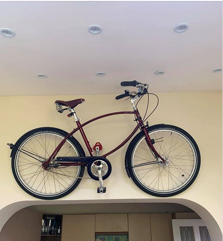

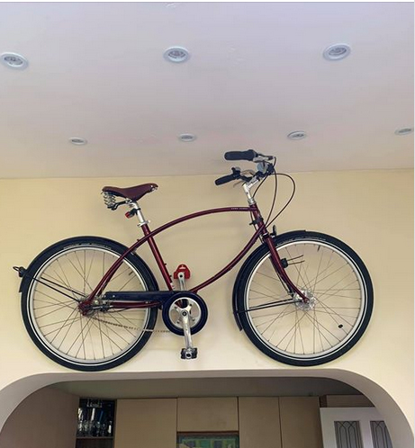

I have found with GU10 lamps area matters, and in general looking at around 3.5 watt, over 3.5 watt it seems the output is simply absorbed by the floor rather than lighting the room, my son decided the GU10 looked better than the fluorescent in the kitchen, and I have to agree it is a talking point Kitchen bike.jpg but to work you need a high ceiling which you can see from the bike it is high, and loads of lights, plus no bedroom etc above so cutting holes in ceiling will not be a fire risk. So yes in this extension with nothing above it works well, and in demo kitchens in the likes of B&Q the ceilings are high. But it is unlikely 4 will give enough spread of light.
