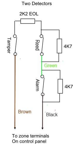

so what i need is to connect to the panel
red cable to 12v auxiliary port
blue cable to 0v auxiliary port
brown and black to zone slots.
is there a difference what colour goes where as there is no other indenfications on it just Z 1
do i need to link all emty zones with 2k2 resistors
do i need to link with 2k2 the one i will be connecting in.
The panel does not discriminate against colour.
its just the resistance between the two cables.

you dont need anything in the zones your not using, you just program them as not used.
you need power cables and two cables from the zone to the detector, then its making sure the detector is correctly wired.
Thats still wrong both in the panel (there should be no resistor there on the zone) and the bottom picture is wrong.

zones that are not used on your panel, can either have the 2k2 resistor in them or nothing at all.
In zone setup if you are not using a zone go to the zone and press no zero yes and it will say not used.
Your almost there.
Take a walk along the black cable from the panel, you come to alarm terminal, walk over the 4k7 bridge to the other terminal, across the green cable to the reed terminal, across that 4k7 bridge, I put my foot on the reed terminal with the 2k2 resistor in and walk across to the tamper terminal, I jump to the other tamper terminal and follow the brown wire back to the panel.
Think the story follows correctly, I am back out on a job, may be you should opt for a simplier option, I admire your determination to get this right and you are getting closer.
