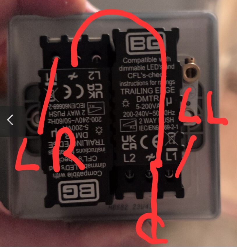

How to wire this dimmer switch?!
I assume the bulbs are dimmable as you already had a dimmer?
You sir are a genius, I had a non dimmable led bulb which kinda worked on the old dimmer, just put a proper dimmable bulb in now it works!
Thank you so much for your help, all of you today I hope you enjoy a beer later or wine, or whatever drink of choice!
Now the issue of getting it all back into the socket and screwed in
Don't forget to earth the new switch as Jurassicspark said earlier (y)
