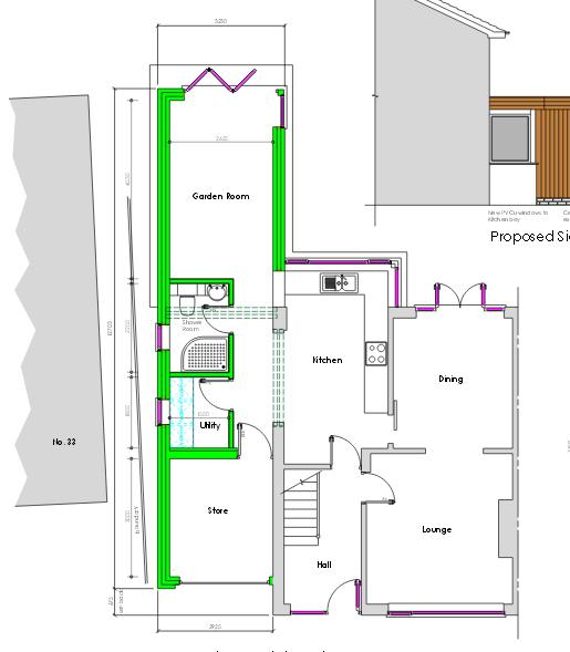

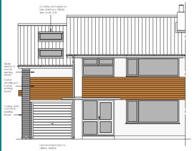

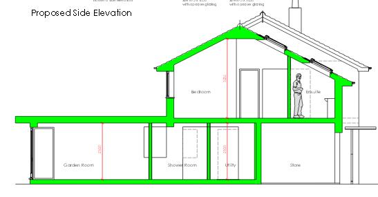

The primary question I have is about the roof construction because as you can see the roof space is vaulted. Do you think the roof is going to be a SIP roof??? The velux windows are 1.34m wide and 93.4cm deep. Or is it some form of steel construction? The length is 7.1m and 3.2 internal height. If so would there be a steel purlin going to the gable wall? They have allowed about 20cm in the roof for insulation, is that enough? Also the gap between first and second floor was 20cm.
As you can see the en-suite dimensions are pretty tight so I was wondering if there might be an impact with this space???
On the ground floor they are building a garden room and the plan is to build up from the existing line of the Sussex kitchen, with the glass in the Sussex being replaced as it sits on the bricks they would be building up from (see last photo).
I presume they would have to dig a trial hole to check foundations here. I was wondering how it works on the rest of the foundation line if the existing foundations were adequate but shallower than you would dig today. Also how does it work with the bricks and cavity width??? The dimension seems to be the same as today on the plan at 300 but it was built in the mid 1960's so were cavities really that big then??? Also was there insulation and what about the brick tie condition? I had the same Sussex next door and my brickwork was damp and frost damaged and theirs wasn't much better. Water would splash off the patio and hit them a lot and I think they should have used engineering bricks there really.

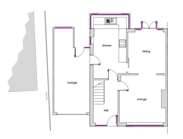

In respect to the GF, the garage would likely be demolished, existing foundations dug out and all new foundation trenches dug and concreted. This would allow easy access for drainage etc along with a full thermal spec' floor.
A ridge beam comes to mind
Aha! So by tieing it to the gable wall does that mean purlins would not be needed?
How does it work having so few rafters what with the wide velux windows then???

Thanks - the garage is on a slab foundation so you are correct sir.
Regarding the foundations under the Sussex kitchen, if they are not sufficient then the kitchen floor would have to come out and there would be a big cost implication.

A ridge beam just holds the top of the rafters up. That in turn prevents the roof spreading by preventing the rafters pivoting. It is not about tying to a gable wall. The gable wall supports the ridge beam, that's all.
Purlins have different function and are used to support rafters that are too thin to support a load on their own over their span. Like piers supporting a bridge.

When you say ridge beam do you mean steel or wood??? If it's just holding the top of the rafters up why does it need to be steel???
Understand about the purlins now but what then is tying the gable wall in?
Can you beef up the rafters so as not to need purlins then???
Regarding the velux I was thinking there may be a limit as to how many rafters the window could span as the tend to be long and thinnish normally, that was all I was thinking.

A ridge beam can be steel or timber but at certain span steel becomes more practical. Rafters can span without purlins if they are adequate and can support large rooflights usually doubling up each side of the rooflight, sometimes tripling, the first floor is tieing the gable in not that it's gonna go anywhere.

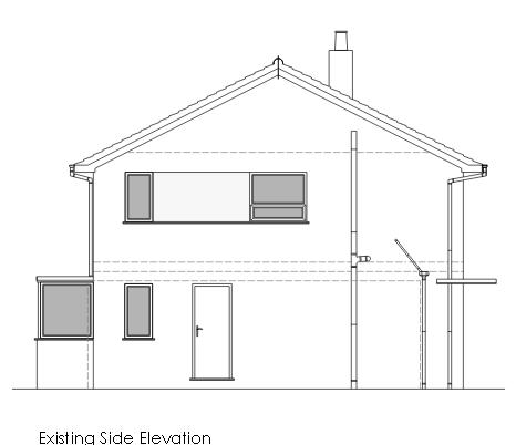

Still worrying about the gable here! In a traditional one you have lateral restraint straps tying the wall to the ceiling joists. So what does their job on the vaulted one??? Or do you have a much longer strap say???

For most residential projects the stability of the gable wall is not a problem. Not having straps at ceiling level really isn't that much of a problem unless you have a very tall gable in a very exposed position.
