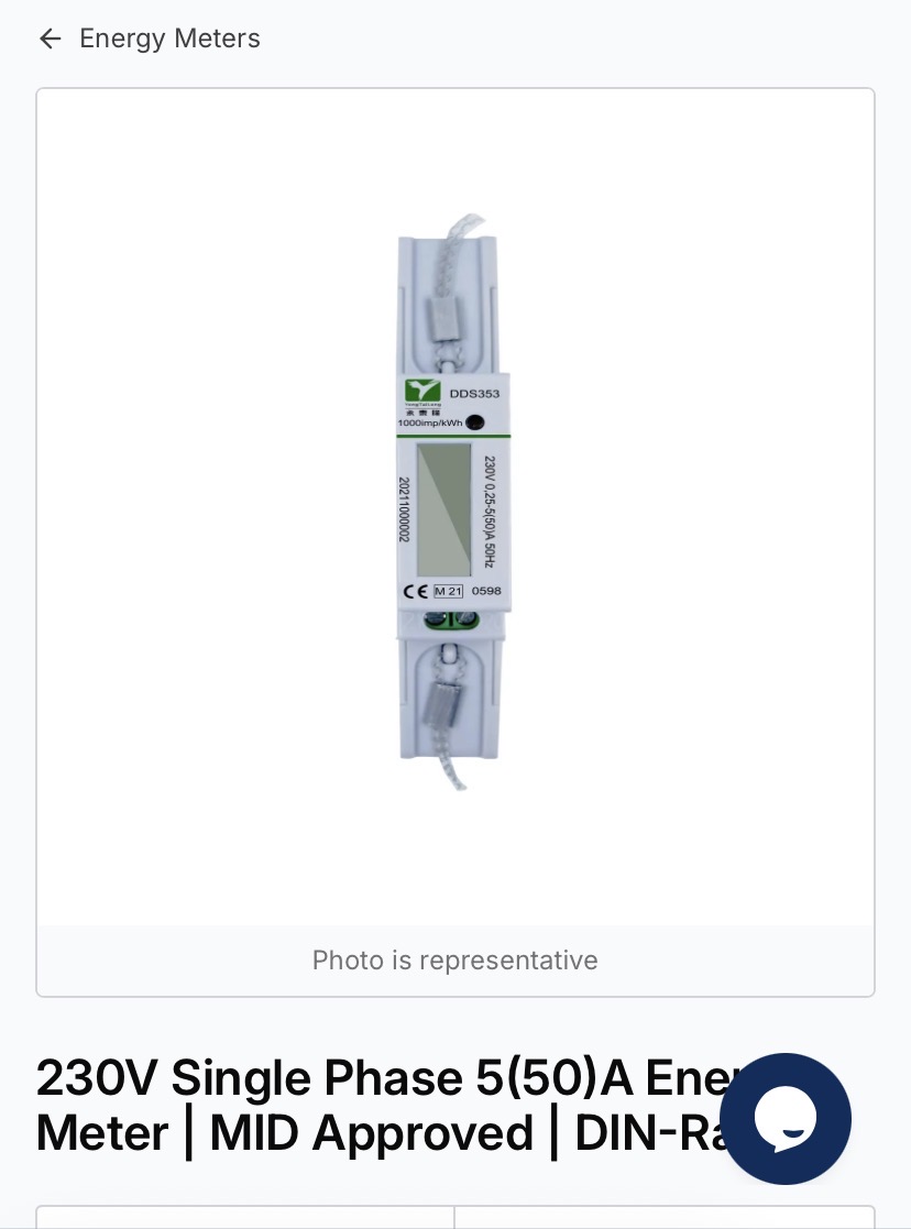

So you need a spark to investigate fitting individual meters adjacent to the CU. That could be done

Well in that case wouldn’t energy metering on each ring be better than a clamp

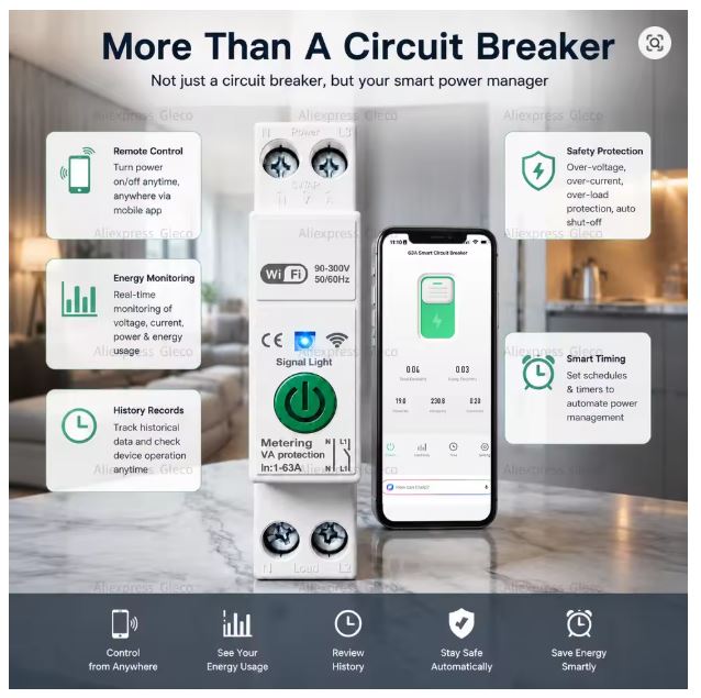

Was looking at similar ones.
Yes they appear to be another daft gadget imo for the reasons i outlined below
Except for the modular load monitoring which is a better practice than the clamping of wires in board etc
I can see the energy monitoring use rather than messy clamping
Seems only over-voltage protection not under , hmm
Remote control of circuits - No mostly and not a sound electrical practice
Overload etc. No. A dedicated DB should always do that
Seems the OP isn’t interested in sensible , easy to install, reliable solutions

I'm just after realizing now that the monitors measure usage the same as the dedicated meters . Probably cos I'm not familiar with them :giggle:
How accurate would the clamp and inline type monitor be compared to the dedicated meter above
Presumably not much difference
P
very accurate
