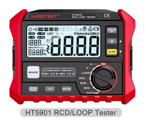

So to employ a scheme member electrical firm, when whole house rewired latter, resulted in it only taking a week, any extra expense not doing it DIY was more than paid back in the reduction in rest bite care bills at way over £500 a week. Also the testers, Loop impedance tester.jpgVC60B.jpgDiffrence line neutral 8 Feb 24.jpg even the cheapest I can find, looking at around £150 and these are not calibrated, to hire because they need calibration is also expensive, they should be calibrated after each hire.
