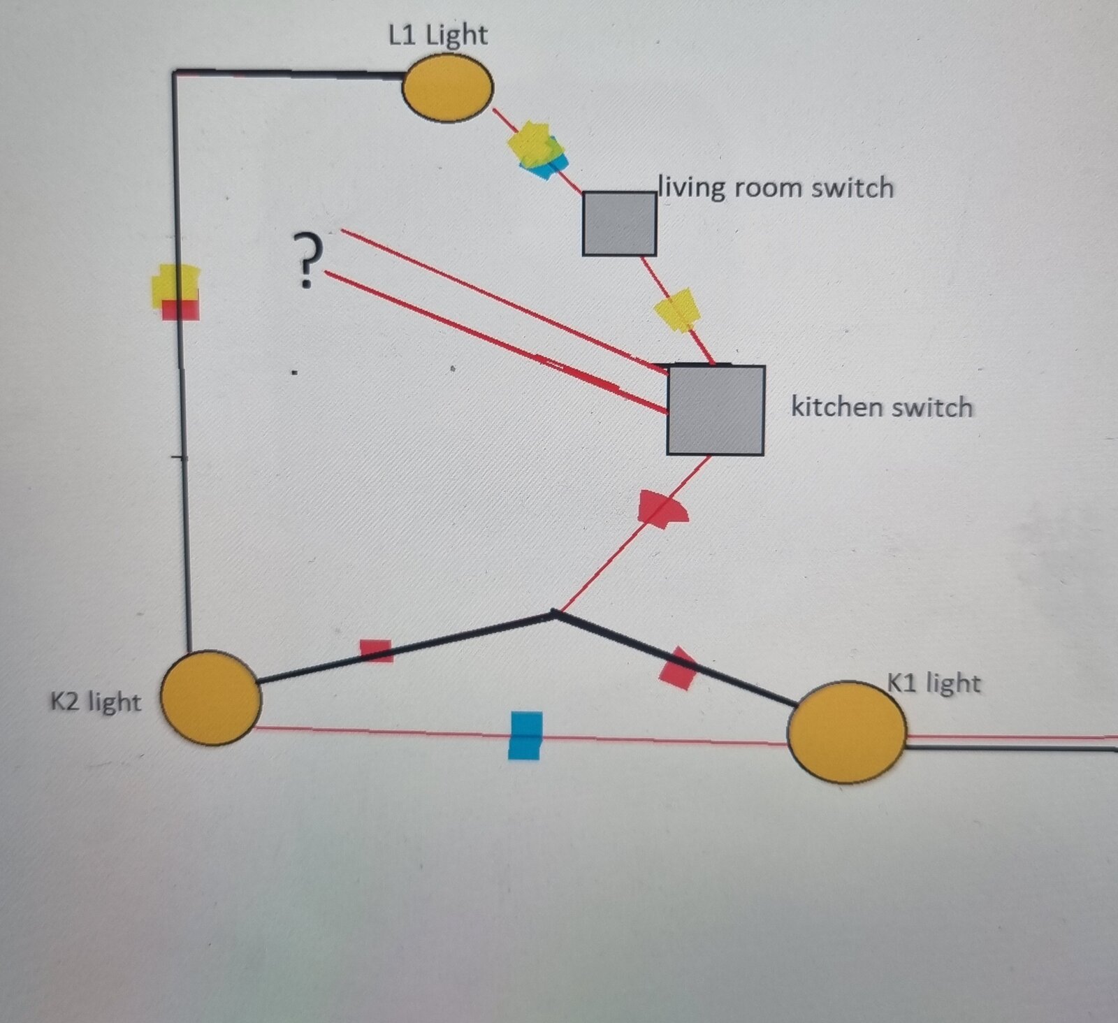

Please help. Light curcuit issue (Diagram attached)
I will try this thanks.
Wasnt sure if some of the black switched lives had to be in a live or neutral at the light. So i will put in the neutral port.
And those 2 extra "loop in loop out" wires u speak of. I had no other lights which is odd. They run off upstairs somewhere... will test all soon. I think one of the switched lives was loose at K2 so the circuit only activated when living room switch was on.
Don't forget a neutral wire will become 'live' if they become disconnected.
At the lights I would think all the black wires are neutrals, and the reds are (switched) lives - seeing your updated diagram.
Hang on. If the power runs directly to the first light then to other lights and the switch.
Those lights are live until I turn the breaker off? Is this safe?

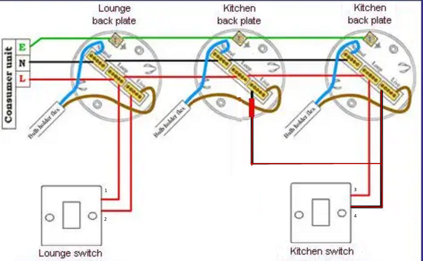

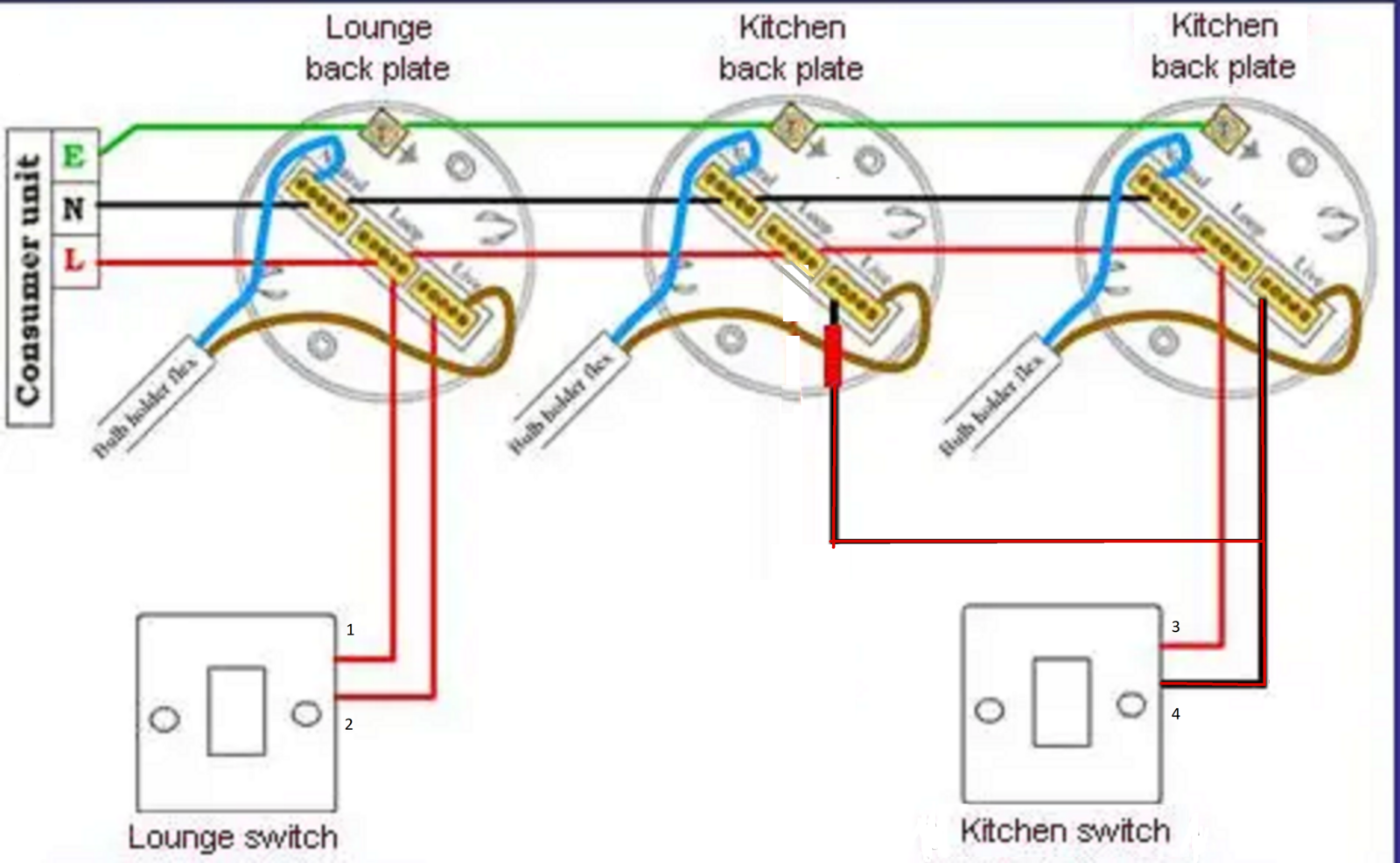

If we try to work out what was there 1720869982640.png you can see four wires to the switches. I have numbered the wires 1 to 4, two are line in, and two are line out. You can see the wires join, this may be at a ceiling rose, or anywhere else, we don't know, you have the right idea drawing it out, but your drawing does not show which wires are permanent line.
I linked to Wiki, you have standard drawings of how normally wired there. The picture I am showing was taken from Wiki.
You may now have a bracket with a hole where wires come out of the ceiling, but likely before that was fitted there would have been a ceiling rose.
If we try to work out what was there View attachment 348887 you can see four wires to the switches. I have numbered the wires 1 to 4, two are line in, and two are line out. You can see the wires join, this may be at a ceiling rose, or anywhere else, we don't know, you have the right idea drawing it out, but your drawing does not show which wires are permanent line.
Apologies if I am wrong, but your diagram shows 3 plate wiring, and the original poster appears to have 2 plate wiring.
And he had a bridging wire at the 2 gang switch.
Trying to transfer a 3 plate diagram to a 2 plate system is going to be a headache.
We don't want to confuse the original poster.
Sorry if I have misunderstood.

i assumed it was live as it was the only wire con connecting 2 lights. K2 and L1 on diagram.
I did have it in neutral originally though and it all half worked
1)Put all your lights back on the ceiling, connect the cables as per the colour of their inner insulation, red to live, black to neutral, all earths to earth.
2)At the switch get some connector block and put all four cables in one block, now switch on the power, do all the lights come on?

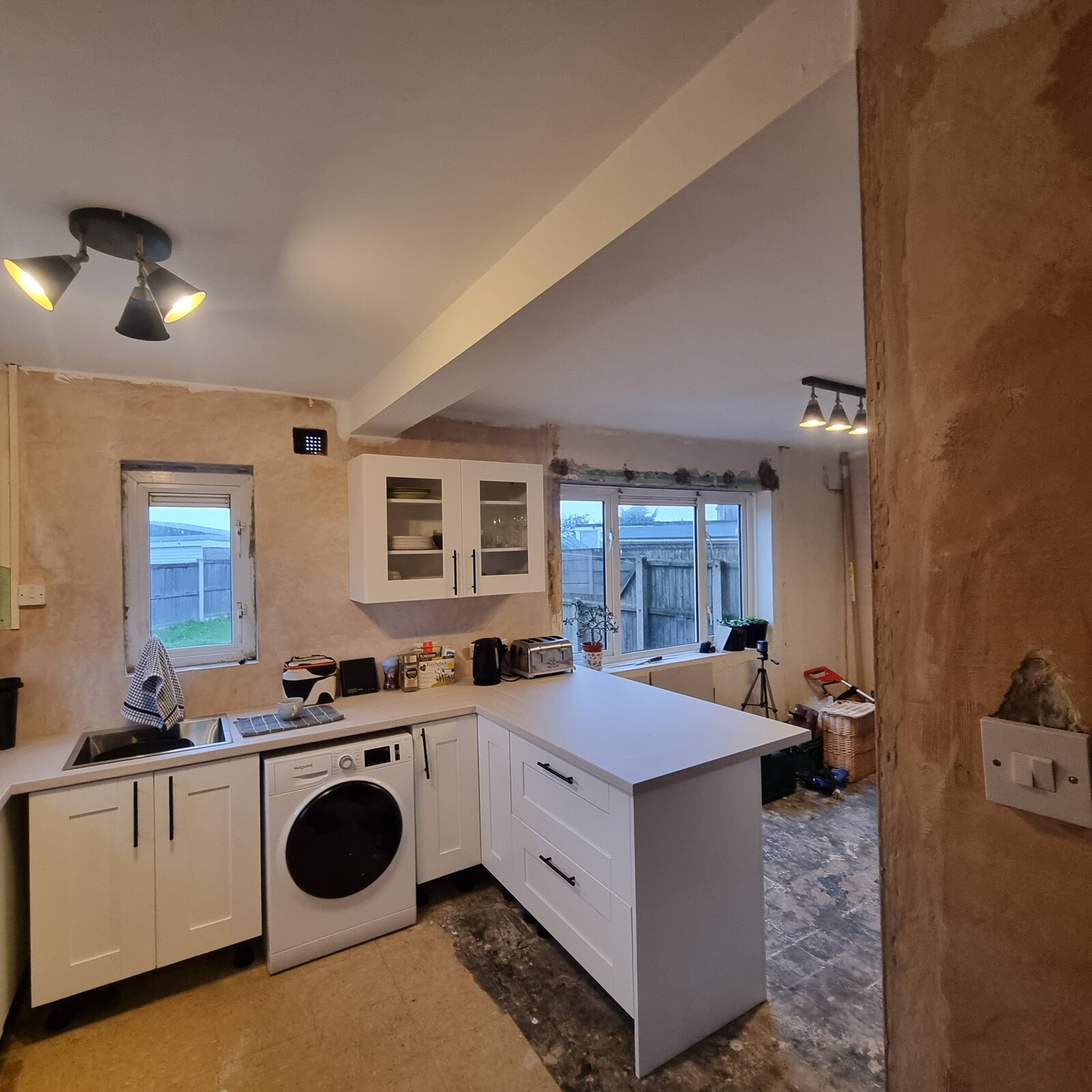

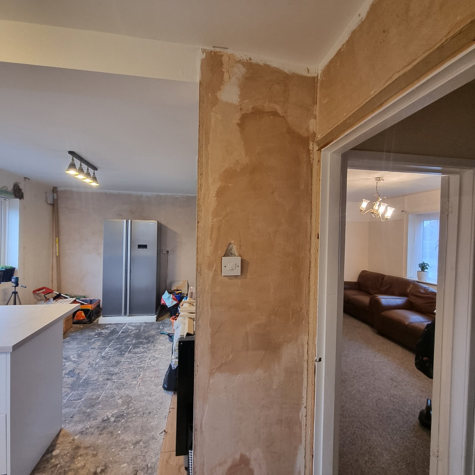

I wired all the lights back up...
Turns out k2 had a snapped wire in the light which messed up the whole circuit.
In the end the two wires in the switch I couldnt identify must have been the returns for the switched lives? after pairing the others up and deducing which was live and which went to other switch (and colour coding wires best I could) and putting the unknowns in the L1 ports it worked as intended*
*and by intended I mean they work. But as you said sparkwright. Only on the one switch.
I guess its a 2 gang as they needed to bridge power to the living room switch. Seems badly designed.
Next step is to work out how those switched lives are connected. And somehow make them work on their own switch. (The kitchen 2 gang)
How does one turn a 2 plate 2 light circuit into something that works on 2 switches not 1
Ps thanks for all the help.
Lesson learnt. Buy live wire testers and a better multimeter. take photos pre light removal, and label wires.
