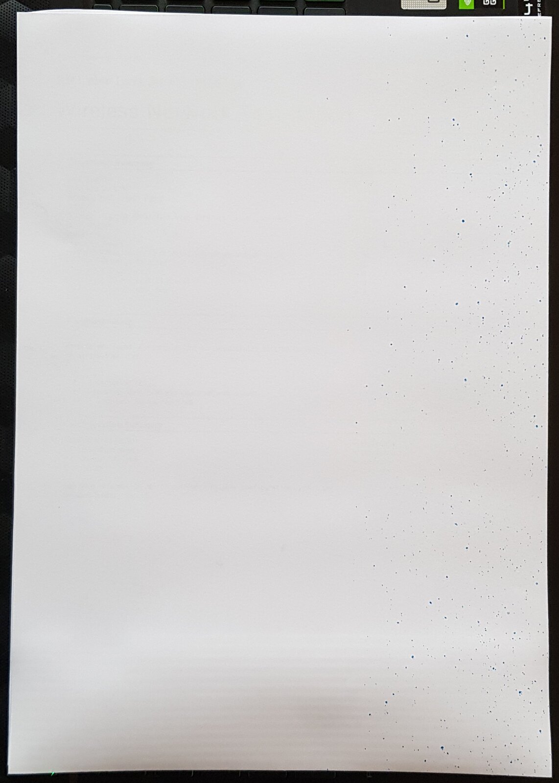

Thank you for this. I have run the cleaning page from the menu on the printer's screen and have attached an image. I realise the speckles are very small so you might need to zoom in to see them!
Looks like some stray Toner from the Cyan.
Might be sat on the Intermediate Transfer Belt (Shiny Sheet that is under the Toners when you push them into the Printer).
Troubleshooting Manual here
Have a Search for Repetitive Defect and Paper Path
https://www.laserpros.com/img/manuals/hp-manuals/hp-clj-m252-m274-m277-troubleshooting-manual.pdf

A search for 'paper path' was quite enlightening but at the same time a little worrying as the last mention under 'cleaning page' states that 'this function removes dust and toner from the print paper path' and, of course, my cleaning of the printer didn't remove the speckling.
The 'intermediate transfer belt' that you mention could indeed have some stray toner from the cyan drum, though why this only prints when we print in black I can't understand. Nevertheless, I suppose I could remove all four toner cartridges and have a look underneath.
If I do, and see some stray toner, can you suggest the best way I should go about clearing the toner or perhaps would you advise me to have this done professionally?
