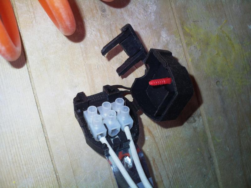

Hi guys, just a quick question.
I’m wiring up some down lights in the bedroom, and have ran T+E to a junction box for every down light. The down lights are prewired to a connector block with some sort of heat resistant wire. Is it ok to use standard 2core flex from this to the junction box? The connector block is held away from the actual lamp by a metal bar that attaches to the base...
Cheers
-Adam
Read the instructions with the light.
Many are designed to allow loop in and out of standard T+E cable, others require the use of heat resist PVC flex. Just do as the instructions tell you.
If using joint boxes, make sure they incorporate a cord clamp.
I have read the instructions, and it only shows wiring one of the down lights, not several. It does not say anything about T+E, flex or the like.
These are halolite GU10 mains voltage down lights btw.

This is the down light junction box:
I was going to wire each with a flex from a JB:
Cheers
-Adam
The joint box you are using is not acceptable, it should be one with cord clamps such as the Ashley 501. The type you have was commonly used previous to the new regs.
The light fittings you show are commonly looped in and out with T+E, aslong as the T+E is kept clear of the fittings. I would still prefer to see HR flex, but where cost is an issue T+E is fine.

Ok great, so if I change my junction boxes to either a choc box with a cable clamp, or a junction box with a flex cable clamp, is it ok to use normal 2 core flex from this to the down light connection box?

If using a maintenance free junction box it will be hard to get flex in holes without tinning our using a ferrule so using flex may not be a good idea for logistics but nothing wrong as far as regs.
Hi ericmark, not looking to use maintenance free junction boxes as I will have access to them through the down light hole. Is it ok to use a chocbox which has a cable clamp for each down light, T+E in and out, and a 2 core flex from each one to the lamp?
