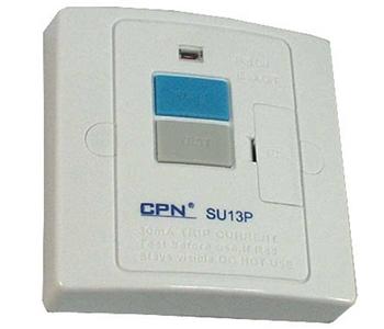

Other points would be the requirement of RCD protection for any newly installed cable that is not mechanically protected and buried less than 50mm within the fabric of the wall, chases within solid walls should comply to the depth detailed in Part A of the building regulations and cable also should be routed within the permitted safe zones.
So if the circuit does not already have RCD protection you have options of introduction the device at the fuse board/consumer unit for the whole circuit or by means of a composite device that acts both as a fuse connection and a residual current device, which can be used as a substitute for the FCU. Similar to the image below.
This units are quite bulky at the rear of the plate and considerations should be made to fitting a backbox that allows extra space, to accommodate for this.
Part P of the building regulation, requires that reasonable precautions are made in the design and installation, to prevent harmful effects of the installation.
So I would recommend that is precaution is not only proved by design but also by the recommended methods of inspection and testing. The results/finding should then by documented in either a minor works cert or a electrical installation cert.
