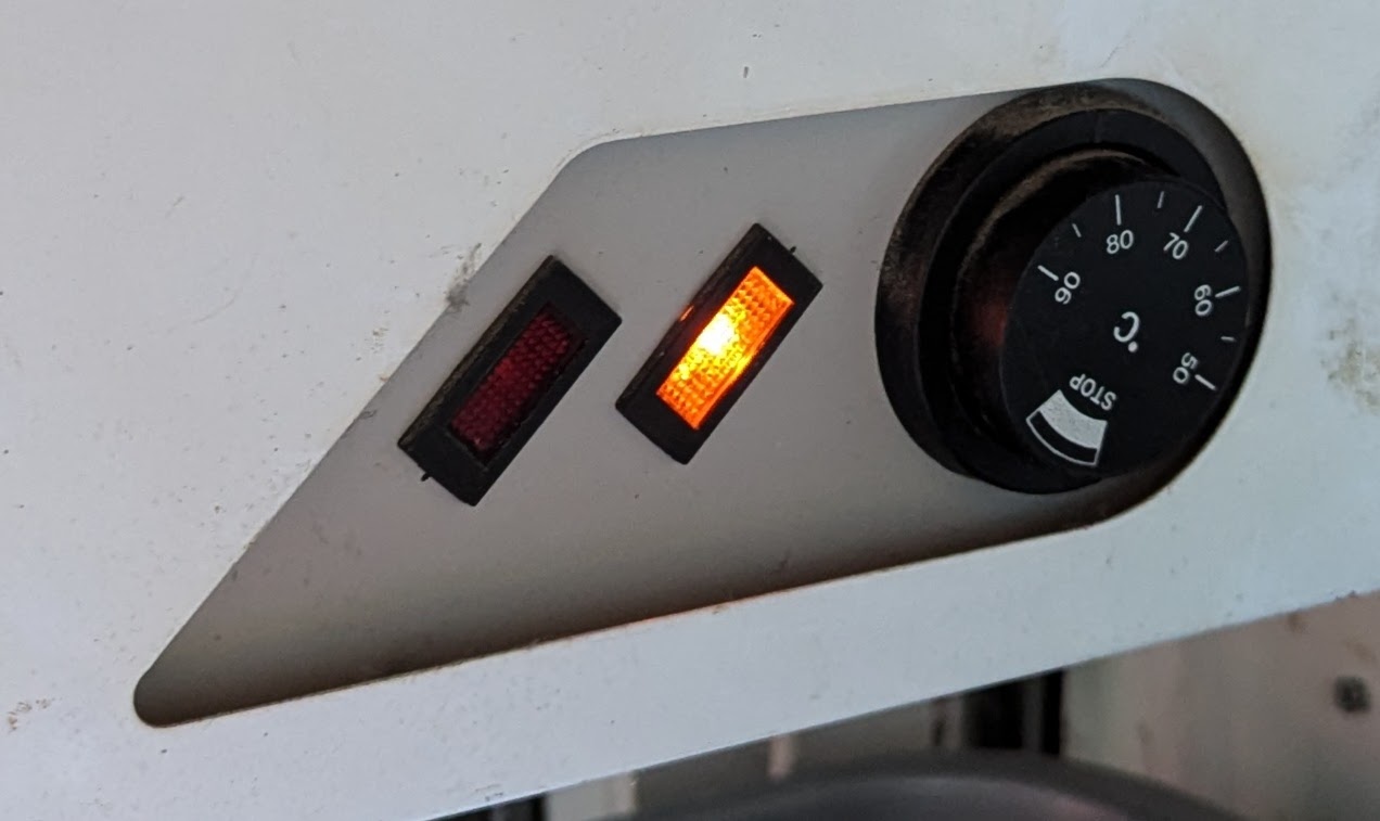

Hi all,
Have an HRM Wallstar oil boiler which has started playing up. Think its a 12/14 or 12/15 boiler.
It locked out the other day and the oil line to the boiler was full of air. Bled that and it started to increase again so following some of the threads on here I have replaced the non return valve and clear pipe and whilst there replaced the photocell and the solenoid coil. All well and good, it seemed (Saturday to Monday)
Been away for a few days and got back to it being locked out. There was some air in the line but not empty.
If I reset the lockout it will turn on the fan and if I remove the photocell I can see a flame (or at least an orange light). It will run for the 15 seconds and then rather than firing up fully it will lockout. I have bled the air out again as well and gone back to the original solenoid and photocell in case either of those were faulty.
Looking to get an engineer out, but anything I should be checking to get it running again?
Any help appreciated.
Thanks all.
If it helps, inside and outside pictures where hot water is being called for but locked out.

Thanks Exedon for the response.
To update, I have got it fired up now. Will have to see if it is still leaking air.
What I had to do was to release an air lock in the pump (I assume). So rather than the top bleed valve at the front which removes the air from the line, I had to knock off the one on the side (left hand side in the picture) and it took a second or two whilst running to have a flow of oil coming from there.
After doing that it fired straight up and has been coming on and off as it should since then.
