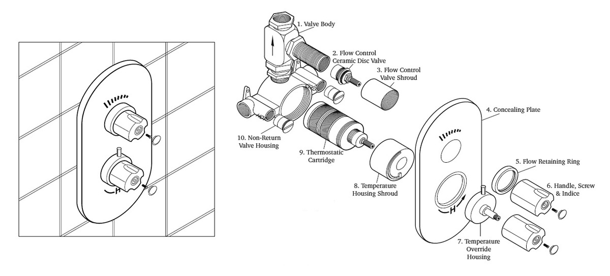

Hi I have this Hudson Reed thermostatic shower and lately the cold water is dripping from the shower head. Any suggestion how i can resolve the dripping

It's either accumulation of limescale, on the valves, preventing them sealing, or wear and tear. My first attempt at a solution, would be to pull the unit completely apart and soak all the parts in citric acid (fruit juice), to see if that helps. Failing that, you will need to replace the valve - item #2.

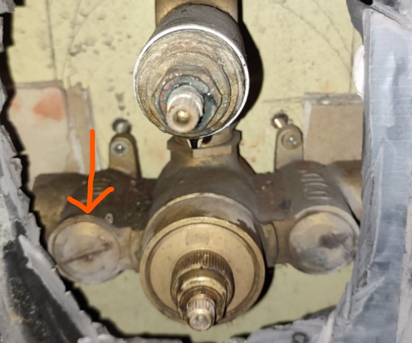

really struggling to get the unit out, is there any way of isolating the cold water. Is this some kind isolator can't seem to turn this in any direction
