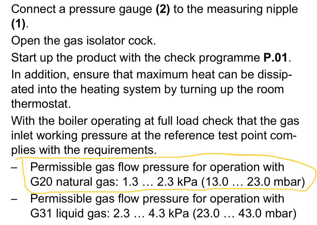

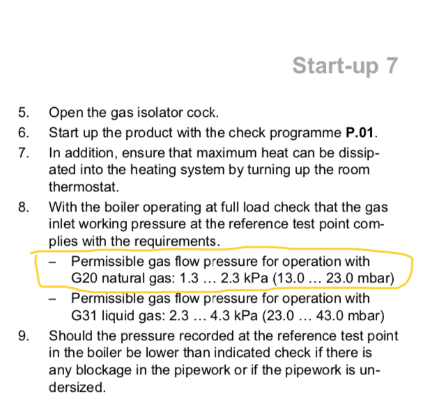

Huge gas pressure drop between meter and boiler. Help!
Both from plus and pro models, tried to show them as different screenshots, but essentially the same:

Because, DP, you cannot fit substandard. Every RGI knows that , or should.
When fitting a combi, tge mere presence of Iron should tell you that a re-run is possibly required.
At the quite stage, if the run is not visible, the obvious thing to do is state that a re run may be required and it would cost £xxx. If you leave it undersized, trouble may be down the road, as in this case.

I must say I’m amazed at 13 pages but have taken it all with a pinch of salt. Gas safe will come to take a look at the installation but it sounds as if the pipes should have been upgraded at the time but I was not made aware of this, nor was it quoted. The replacement of the boiler was just over £5k high struck me as a lot but seemingly I had to get a new boiler as the other was deemed unsafe. My assumption was that if a new boiler was installed it would have to meet the specifications. Whilst I am not sure about gas safe implications it definitely wasn’t installed with the correct clearance. Apparently that would have cost more but I wasn’t given a choice.
