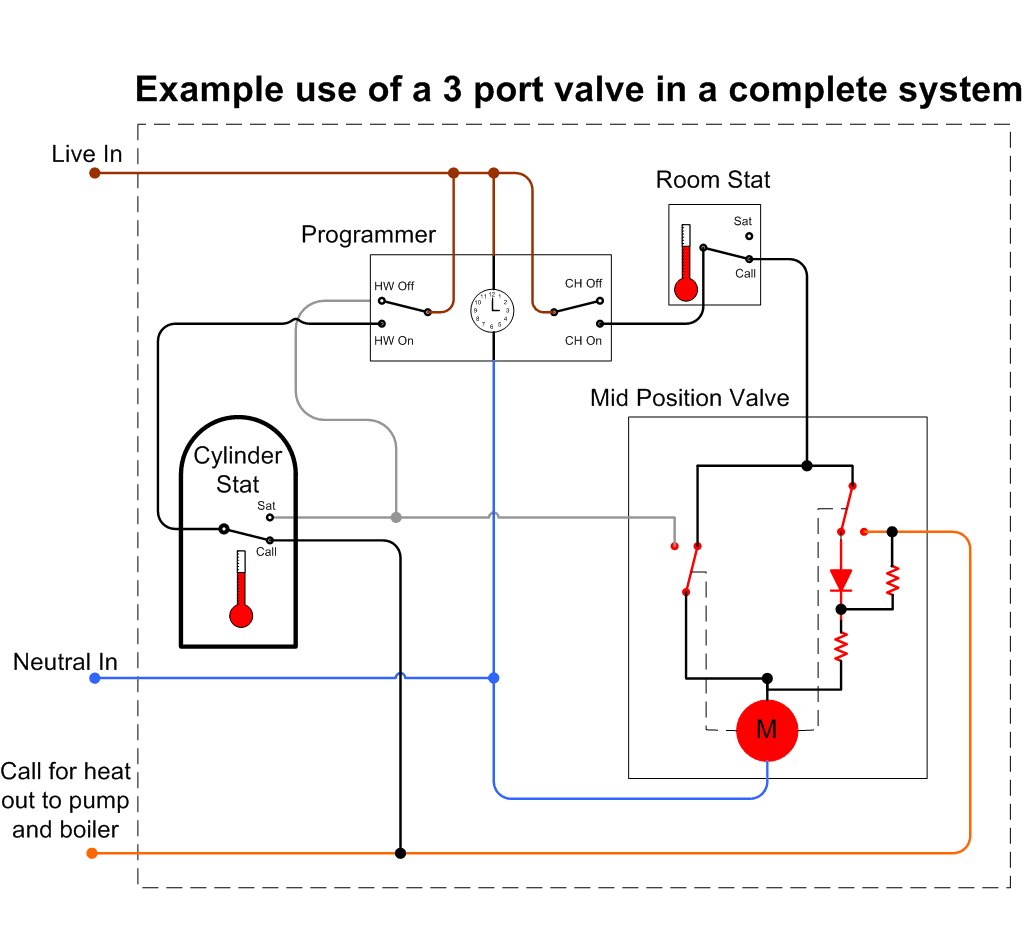

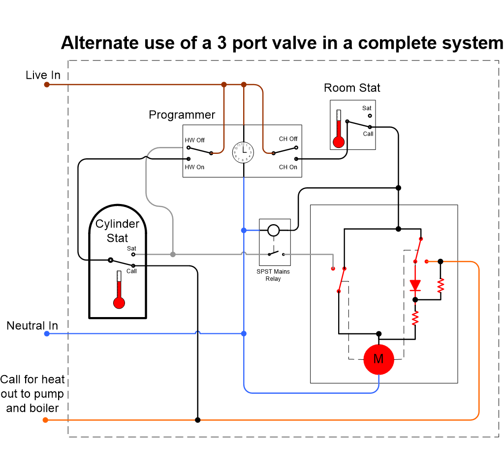

The addition of a simple relay will automatically cure this "last port of call" problem with a mid position valve.

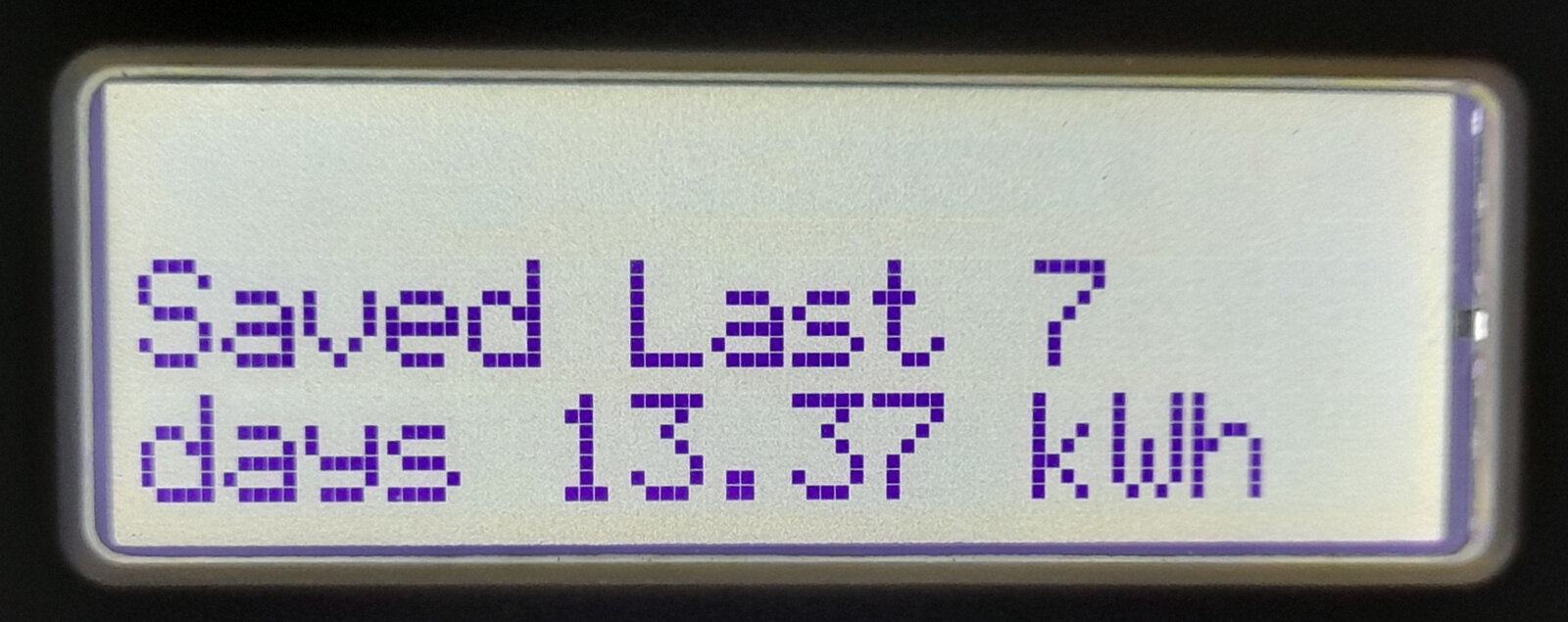

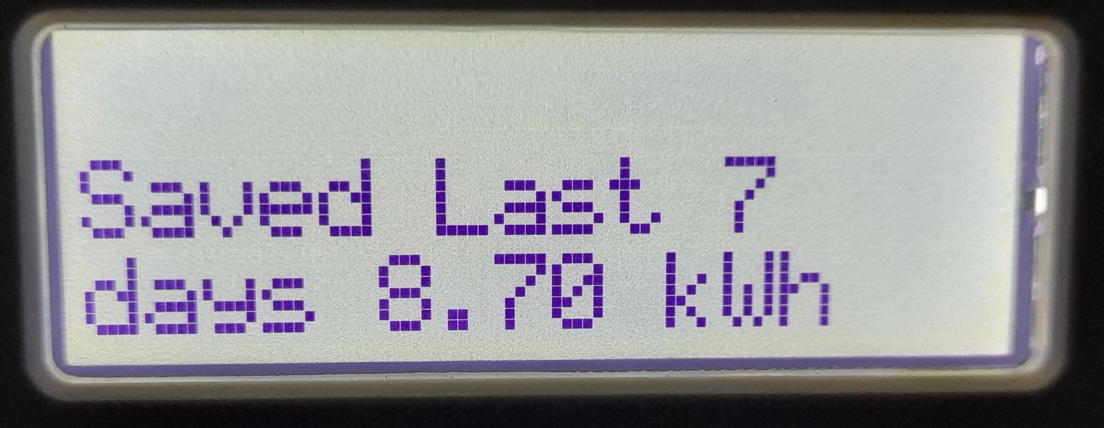

On fitting solar panels, I got an iboost+ in hindsight a mistake, however it does show how much used per 7 days, and that is around the 10 to 12 kWh mark, so use over double the energy to heat DHW with oil to heating it with electric, and with oil not sure if it has got hot enough to stop legionnaires, but I am sure using the immersion heater. Costs between 8.5 and 15p/kWh for the electric, either off-peak or lost revenue as not exporting it. Sunday last 7 days-1.jpg
Without the iboost+ telling me my use, I had just belived what I had read about it costing more to use an immersion heater, which is likely correct in winter, but in summer, the cost to heat the boiler and pipework, means cheaper to use electric.

@Johntheo5 seems to show the standard three port valve, where you are using the Sunvic MoMo valve which I did not even realise existed.
John's idea, would work equally with either a normal, or MOMO actuator, electrically they perform identically - they are a straight swap. The difference is, the motor is only powered, when it needs to change position, no springs involved, and it only rotates in one direction. The result is that they are under much less stress, and so last significantly longer.
