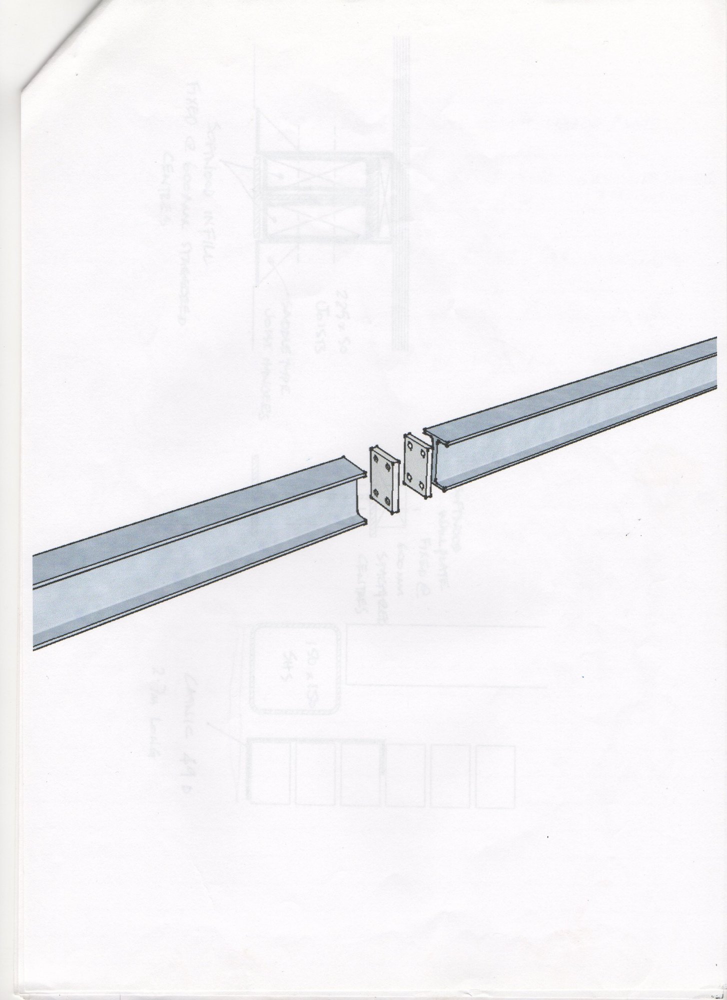

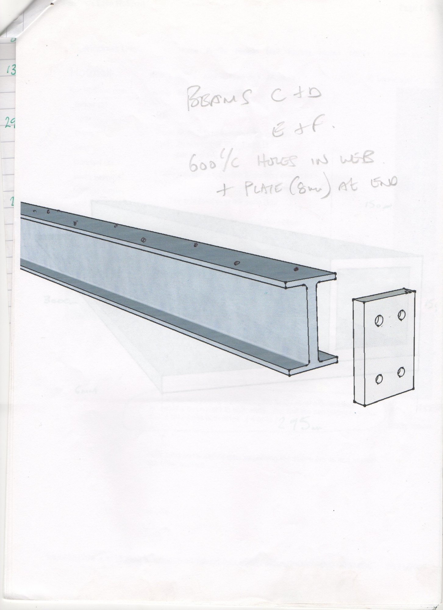

I had this problem with a client/architect whereby I was practically begging for some steel design detail from the client. I didn't know whether it was the client being a skinflint or the architect being lazy, but I ended up doing the drawings myself.
I'll post my efforts later if anyone is interested.
