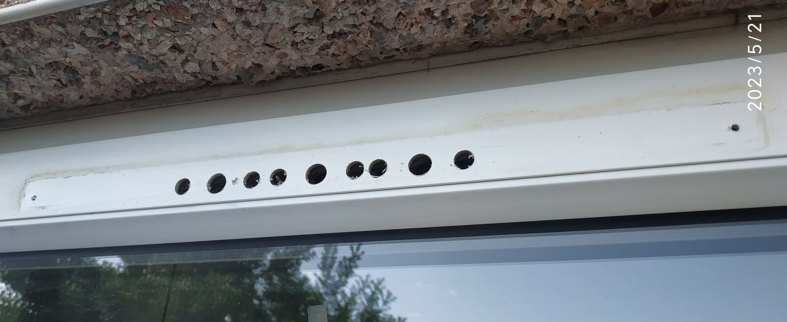

Hi again, I have taken down these plastic covers on all the downstairs windows.
I had it blocked completely on the inside since winter. Haven't noticed any condensation or humidity going over 52% as of yet.
Can I simply fill in the holes with expanding foam?
Then cut the excess and I was going to cover it with two layers duct tape then aluminium insulation tape on top.
What do you think?
Alternatively I would have to come up with some DIY covers that would match the old one.
I think this being left unblocked allow the cold air to penetrate the frame and I reckon lower the temp of the whole window defeating "double" layer.
I've just fitted 26 residence 9 windows, some of which have trickle vents. The good news is that the construction of the frames means that it's only the header bar which will fill with cold air, not the entire frame as I originally thought. I did open out one vent to fit a sleeve from front to to back but the groove had to be opened out too far for the cover to fit properly. In my case the building inspector told me that because my original plans were passed some years ago (kept live because we started work) I should do what my architect put on my plans. I've gone for 8,000 square mm per room, which is what he specified, except in those bedrooms with just one small window where I opted for 5000. Because the rooms are pretty open plan I can easily achieve 8000 square mm per area. I'm going to try the vents out to see how draughty they are and I can then take off the covers (screw and clip) and stuff some pipe lagging to fill the holes if they're too draughty. Building control haven't been to inspect yet so I'll update once I've had my visit. Incidentally, the FENSA certificate is only a document telling the customer that the windows have been fitted to BC specification so is not in any way a guarantee. In my opinion an actual inspection from BC is worth more than a FENSA certificate for windows which haven't actually been inspected.
