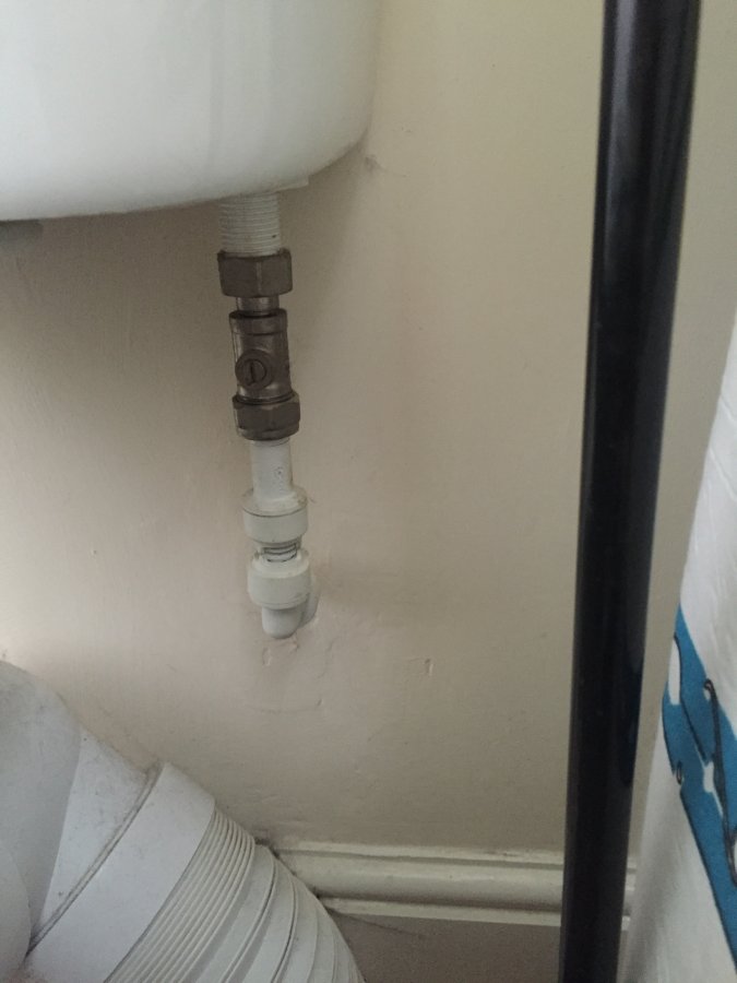

Hi guys,
I need to be able to tap a feed from my downstairs toilet, to take to my garage for washing machine feed. I am struggling to find any solution.
The current pipework looks like:
I need to be able to tee off from this and go LEFT towards my washing machine.
How would this be possible?
I have thought of opening the wall up, extending the run downwards and coming out more like the skirting board, so I can add an inline Tee but this seems like a lot of work when there might just be some magic thing out there that you guys know about :)

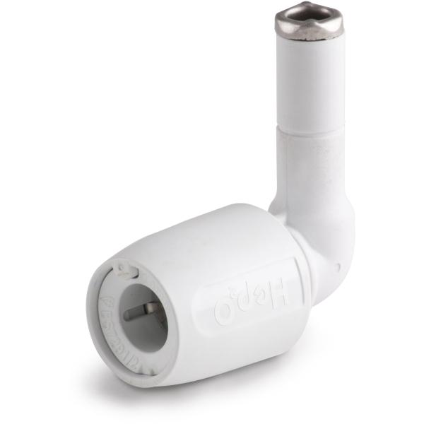

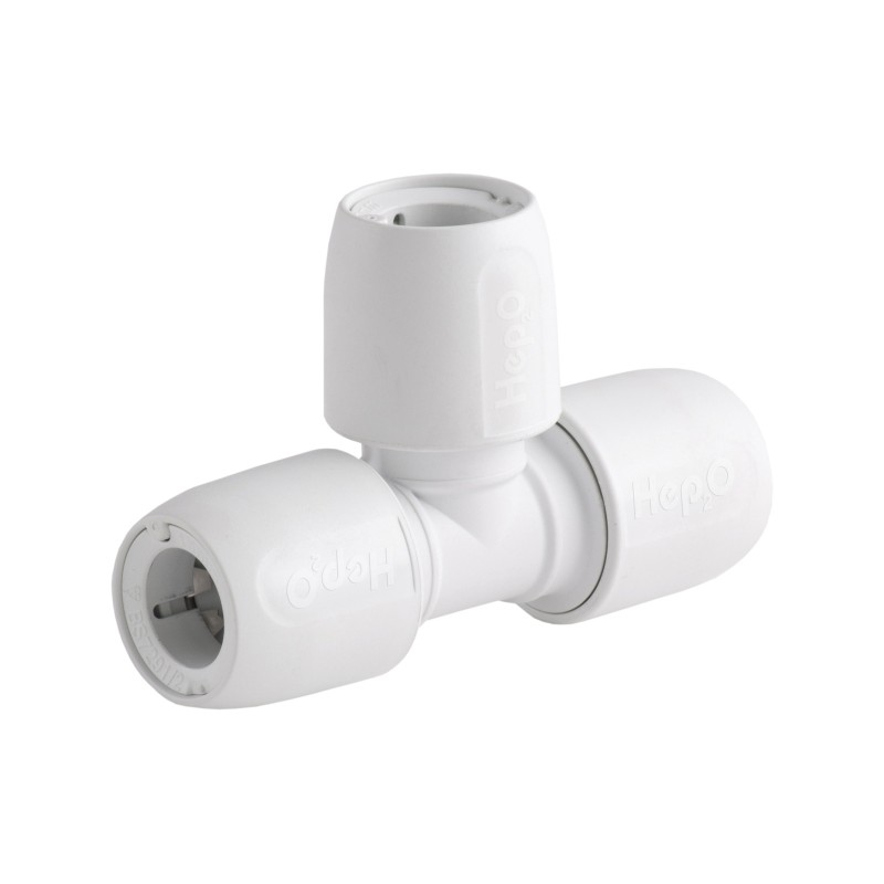

can you get acess to replace the bottom elbow with a t then drop into a elbow
you can get corner tees but there a might pricy
beat me to it
Is the basin mains fed? - most washing machines need mains feed cold supply
Damn, Thanks guys. Completely overlooked the Tee up/down and take my feed from the bottom. lol. What a plonker.
Its mains fed newboy, our house is a new build (2007) and no water storage of any type in the building.
Is that a 'poly-plumb' fitting? or early Hep2o? just saying that they do not all 'de-mount' in the same way as say, a speed fit fitting does.
You'll probably have to dig the wall out a bit to get that bottom elbow off!
Another option would be to remove everything down to that elbow then rotate it 90 degrees CCW; run a pipe to your washing machine and then, about 6-8" along, put in a T with a stem elbow pointing back towards the cistern inlet and use pipe or flexi hose and a bent tap connector (with isolator) to connect back onto inlet tail!
