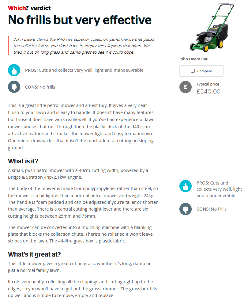

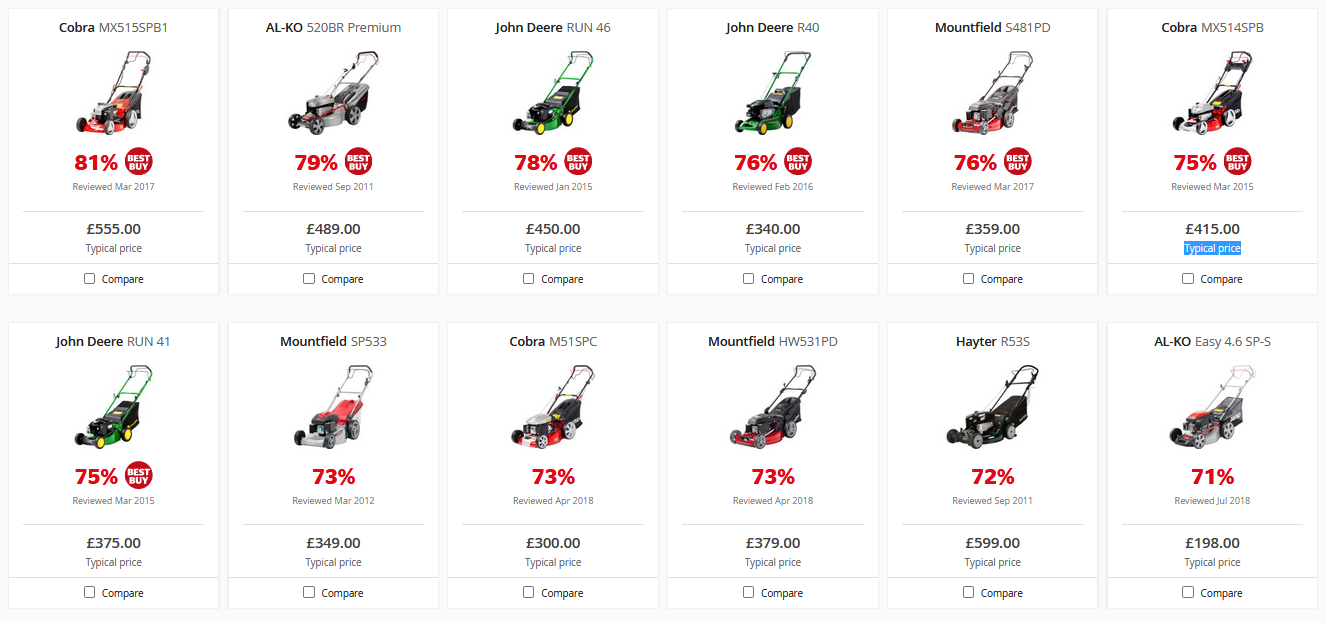

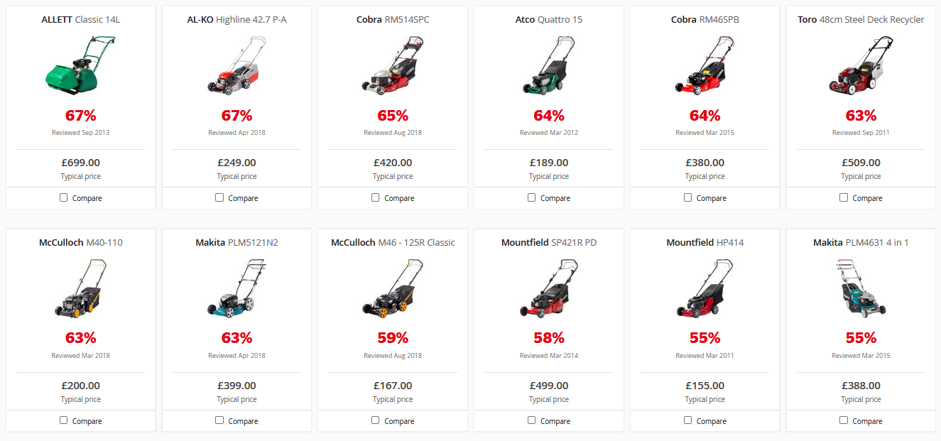

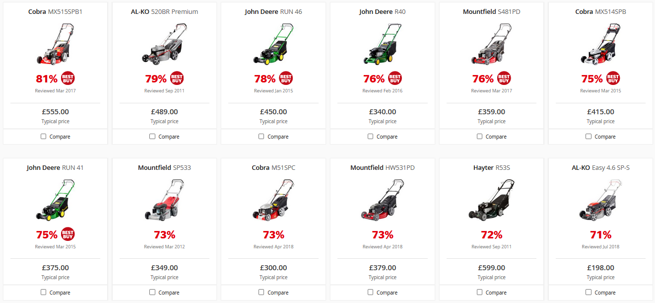

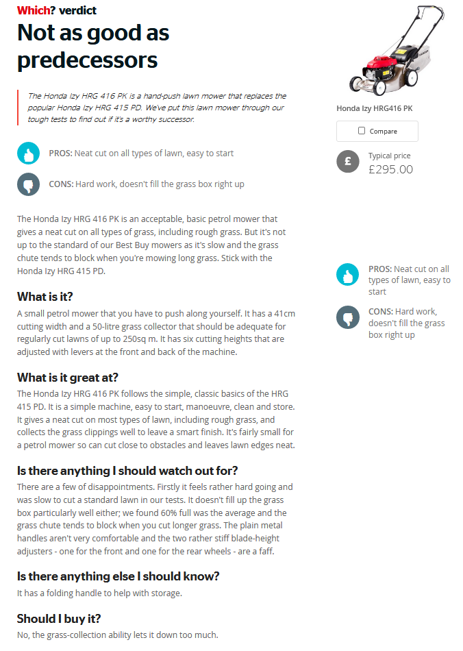

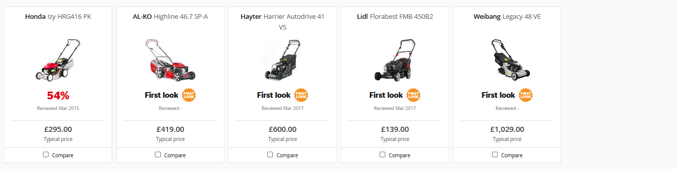

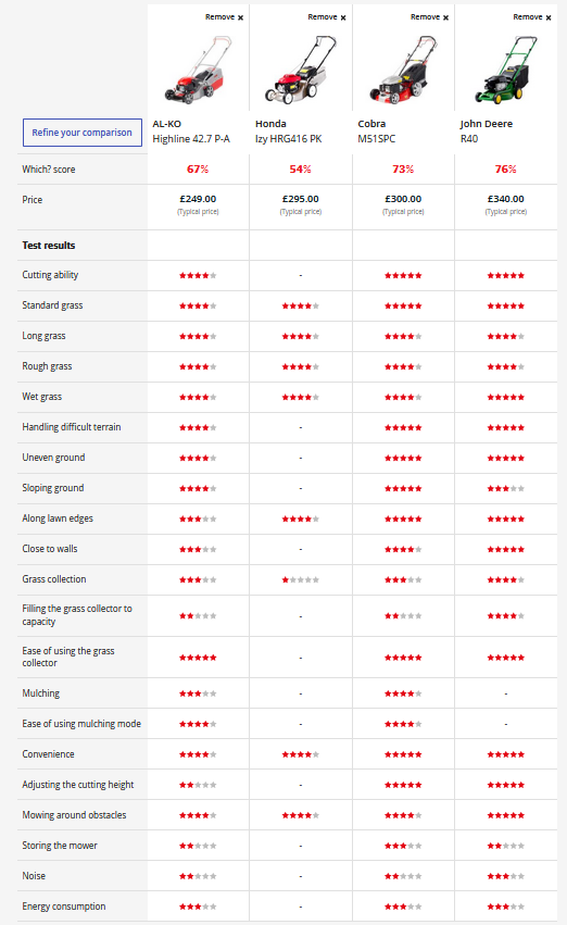

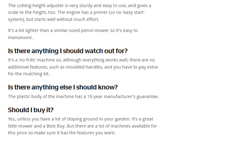

I asked here because I know that sometimes Which? can over/under-rate the importance of some features, and sometimes have odd ideas (e.g. they say that a BMW 3-Series is a large car), and it's good to get other opinions but they really don't seem to like the Izy. Doing a comparison with others in the same price range:
shows that there might be discrepancies between test methodologies (and therefore scoring??) over time.
And they tested the Honda 4 years ago, so the current model could be different.
Does anybody know if the criticisms of the Izy back then still apply?
Conversely, does anybody know if their Best Buy, the John Deere R40 is still the same as it was in 2016?

Let me address some of the Izy criticisms out there before moving on. Apart from the rusting deck:
The grass collection isn't that brilliant as the bag seems to only get half full. I get through this to some degree by 'tweaking' the engine speed to throw the grass further back. The engine is factory set slow to avoid emissions and noise but I agree, grass collection isn't the best.
Superior points of the Izy, apart from superb starting and reliability:
The height adjusters are tough and well made. No plastic or monkey metal here, which is a big deal when the machine ages. On many machines I have to lock the height adjusters into place to make the machine usable.
The handle adjustment is also metal, unlike many others with plastic ratchets which don't grip from new and wear out quickly.
Same applies for the 'pull and go' handles - no plastic, no snapping and excellent control of the cables....few other machines have thought this out properly. Likewise the throttle lever.
The rear axle drive is strong and doesn't give trouble, similarly the drive belt. This is an achilles heel on many machines.
The grass box is a metal frame with a fabric outer - again no plastic to fail.
Briggs engines are fine - the very cheap ones were built to a price and didn't last long. The carburation is generally inferior compared to the Honda and the tickover may not be as smooth. The starter recoil isn't as well made either.
John Deere stuff is generally good and the parts supply is excellent. The C series have too much plastic and consequent failure. They use Briggs engines.
Chinese engines power many 'shed' machines. They are getting better and with care can last quite well. The apparent value for money is astonishing.
If you look at the machines the landscape gardeners are using, its Honda most of the time. I get many machines in for repair over the season and the Honda still gets my vote every time for longevity and general reliability. No industry abuses the equipment more :mrgreen:
