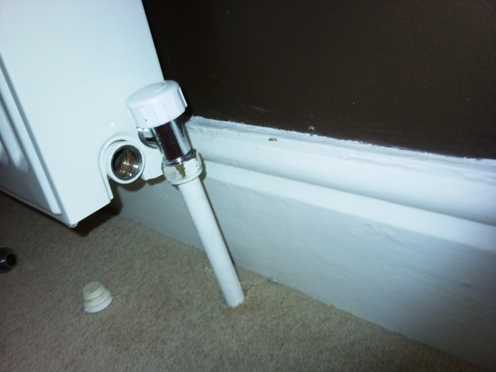

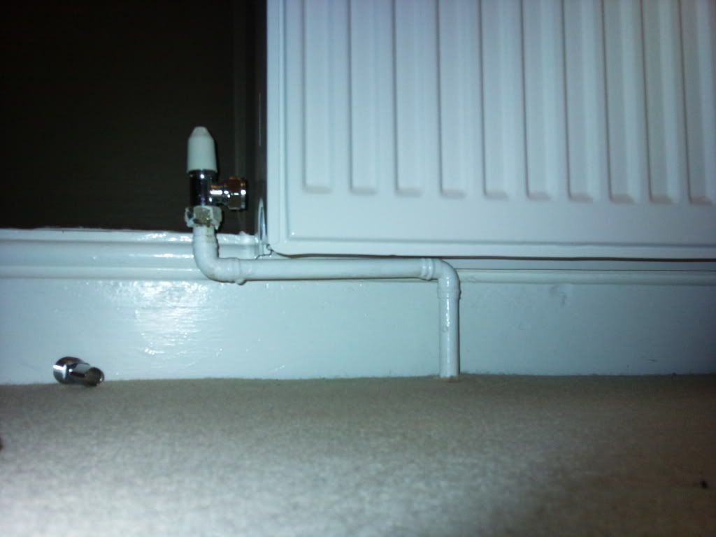

I have two new radiators to fit. Both were singles before, but now they are doubles.
Therefore the pipework needs altering.
Upstairs shouldnt be too difficult - theres some play in the pipes as shown here:
(at one point this rad was smaller hence the extended left pipe).
I am going to raise the new radiator by about an inch, to clear the pipe extension and to make the pipes easier to manipulate onto the rad tails. Will I be ok manually putting a slight kink in the right pipe to bring it out slightly?

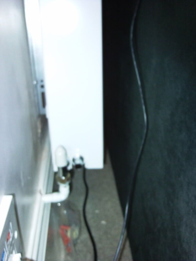

The second one will be more work, as shown here:
The pipes go through the wall to under the stairs and then down 4 inches under the concrete floor. There is no play in them. How can I extend them the extra inch? It all seems so fiddly. Would it be the best option to remove the pipe through the wall and replace with a longer piece?

you'll more likely end up with a damaged pipe more than a slight bend if you try and bend it.
why not alter both of them under the floor look a whole lot better than pipes that are pulled at an angle to fit as with the vertical one.
as for second pic alter the pipes under the stairs and put a new section through onto the rad.

On the second rad, if the pipes go through the wall to under the stairs, you could cut the pipe under the stairs and add a bit extra so that the pipes come through the wall a bit more.
Compression won't matter under the stairs.
