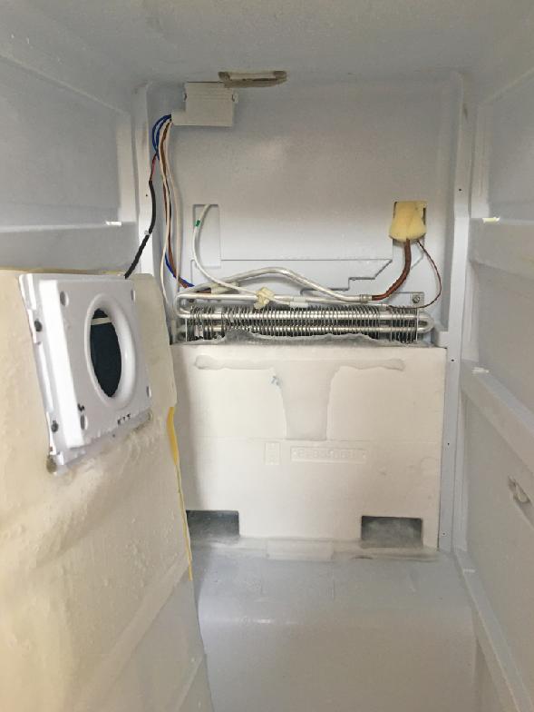

I have a INDESIT fridge freezer which the other day i was unable to pull out the bottom drawer.When i did manage to get it out i could see ice below & that was the issue as to why it was stuck. I removed the ice but after a couple of days its back again.
I read about blocked drain hose but not sure where it is.
Looking at the back of the unit at the bottom i see the condenser if that's its name, stumpy cylinder item which has a plastic tray above it.
The tray is dry & no water in it.
I also see a rubber part which I assume is where water is supposed to drip from into this tray, this is also dry.
In the freezer I have removed all the trays & taken off the back cover to expose the photo shown below.
Please can you advise any steps that i now need to take.
The 2 square windows either side had a lump of ice build up in both.
The is also a length of ice build up in front of the aluminium fins that you can see going side to side

Yes frost free & I did look at other posts. Most advise the issue but I was asking as to where the drainage hole / pipe etc is located just in case I could remove something but sounds like the issue is a build up of ice.
You might be able to see it when the ice has melted. There is usually a gutter or slope running to a hole, which has a pipe leading to an evaporation dish. This dish is often full of fungus and grime, sometime a frozen pea blocks the outlet.

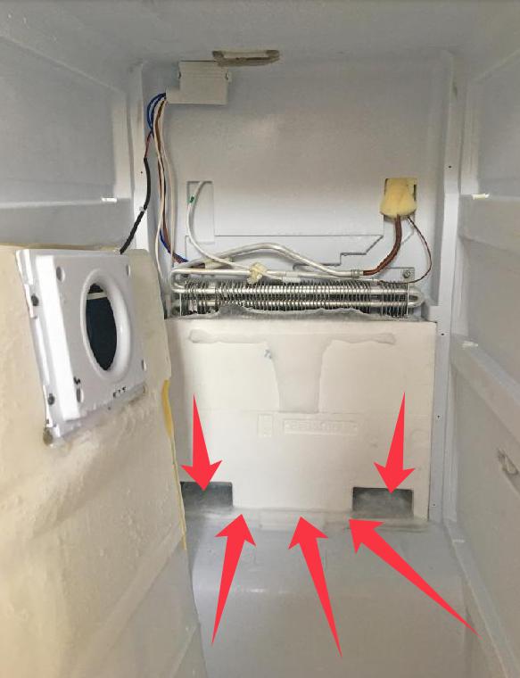

So the slope will be the other side of that rubber hose I see above the tray
I can't see the rubber. I'd expect a gutter under the finned tubes to catch drips.
Inside the 2 windows are say 1 1/2 inch of ice.
The 3 arrows blow are ice left to right so maybe under there.

In the photo behind that white polystyrene piece is the sloping channel you mention with a drain hole say 3/4 inch diameter.
Thanks for the help & advice
A cable tie can be used to clear drain hole as it’s flexible.
Constant freezing at base can also indicated blocked pipework, the lining can deteriorate to the point it blocks up , which is often terminal for fridge due to repair cost .
